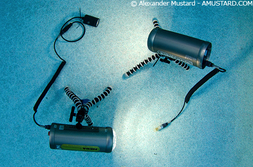

  2. I have one of Hedwig's early prototypes here in Cayman with me. I can't see why it won't work with any electronically fired strobe. Works really reliably with my subtronics and inons.
    It is pictured below on the right (my slave sensor is on the left), but the question is, which strobe is triggering which?!
    Alex

  5. I have one of Hedwig's early prototypes here in Cayman with me. I can't see why it won't work with any electronically fired strobe. Works really reliably with my subtronics and inons.
    Alex
