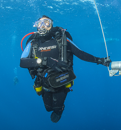

  5. You will find that the air for buoyancy in either jacket or wing will move to the same place ie the highest point, which it at your back behind your shoulders. If you need a pocket on a wing, your cannot beat the front pouch of a Buddy Trident (formerly called a Trimix).
  6. That front pouch looks pretty bulky creating drag in the water. At least, that's how it looks to me.
    Steve
  7. That front pouch looks pretty bulky creating drag in the water. At least, that's how it looks to me.
    Steve
    When it's unzipped! If you don't want drag - free dive.
  8. Also the inflation hose looks a tad longish! It really only needs to reach your mouth.
    Junk on both of ure hips and your lap, buoyancy increasing padding.... I don't like it- that's exact in the space where I slip stream my camera when swimming against current under load, a smb & reel is best(IMHO) clipped off to a ring on the crotch strap, where it connects to the s.s backplate. I do like to hunt lite.......
    It's a bit of a drag show........
    Edited by DamonA
  9. I made a mistake posting a picture because people make judgements based on presumption. I was merely showing the front pouch. The padding on the hips does not increase buoyancy since it is a weight harness full of lead to counter the multiple tanks worn by the diver who is doing a long deco-stop after a dive on a wreck in Truk. A long corrugated hose? Her right hand looks a bit big too in comparison to her left and to her single fin! It's the close-up prespective of a wide-angle lens at a close distance from the subject. As for drag, three tanks form quite a drag!
    (I've probably used more different BCs than anyone reading this. It's my job. In fact I've used every BC available on the European market over the last 20 years to date. This was always one of my favourites and the choice of my wife for that trip to Truk.)

    PS John, I wasn't criticizing, just making an observation and glad I was wrong. I've used a ton of different BCs over the last 30 years and all had their good and bad points. Now, lets talk horse collar BCs. Anyone for a Fenzy? I still have a couple.

    I saw someone with a Fenzy soon after I learned to dive and thought it was a good idea. However, other divers at the time told me they were dangerous. I took no notice...but then that's me. I've always been a maverick!
    My wife likes to keep a book in that front pouch. It gives her something to read during long deco-stops.
