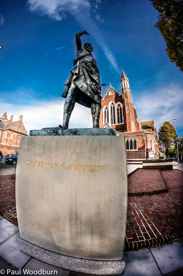

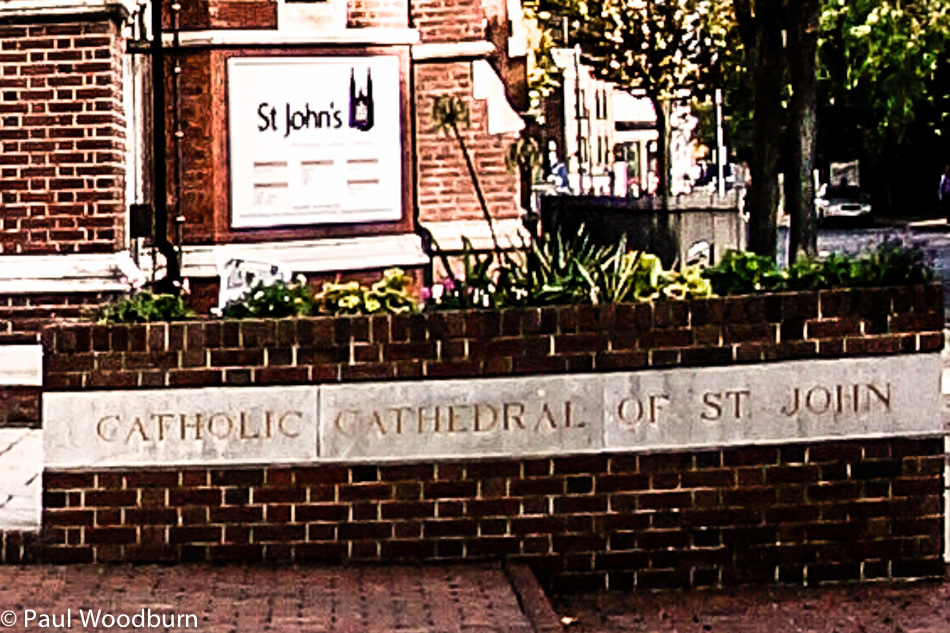

  1. oops forgot one, lots of masked clarity etc gone on here 1/1000 at iso 100
    who needs a big d800!

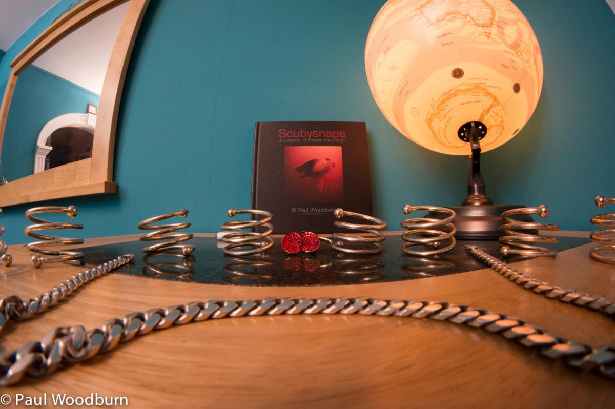

    the 1st one is the nex-6 & 8mm, it actually only focuses down to just below 0.3m, with settings as you say, excuse the noise, not much light and I didnt want to fiddle iso is 1600 then 2000

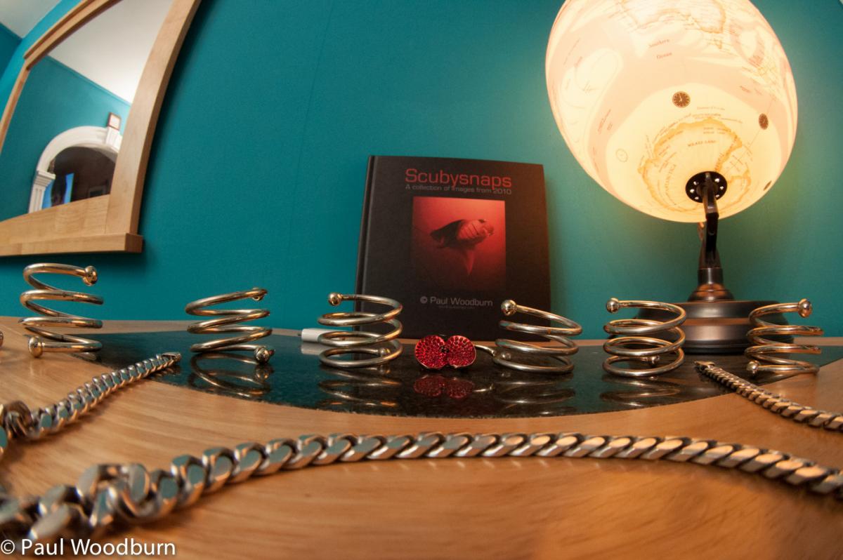

    next one is the tokina at 10mm with focus of 0.3m to compare with the samyang

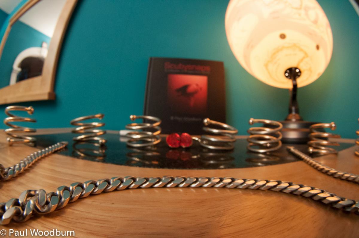

    the next one tokina focus is at at 0.15m because it can to compareat this close level for fair comparison I should have really used a tripod but the manual focus of 0.15m combined with the f/11 seems to narrow a DOF whereas 0.3m seems ok, with my chain at 5.5cm I dont think I'll ever be that close on fisheye, or what does this equate to underwater?
    Edited by Scubysnaps
  12. not sure if i got the last 2 the right way round :S
    corrected

  13. This is certainly one of the reasons why the Tokina is so well-respected underwater, certainly there's no advantage to the Samyang in these images, but more importantly with the Tokina's close focus ability you could focus the Tokina directly on the outer circle of objects, whereas the Samyang can only focus beyond them. So for comparison, a shot of the Tokina focussed on the outer objects would certainly show the Tokina's true potential.
    With the Samyang's minimum focus at 0.3m, it's only depth of field that allows you to get down to focusing on the virtual image which will extend out to a maximum of about 0.21m (3.03 times the dome's optical radius + the distance from the sensor to dome centre). The minimum focus distance is from the sensor to the front of the dome, or about 0.11m (or 1.0 times the dome's optical radius + the distance from the sensor to the dome centre). The two concentric circles in this experiment represent the minimum and maximum focus fields underwater and are 1.0 times and 3.03 times the radius of the dome. Note that the focus distance for the Tokina/D90 combo will be greater than for the Sony/Samyang because of the increased distance from the lens to the sensor plane for the Tokina/D90.
    Anyway, objects at infinity will be at about 0.21m for the Sony, and objects touching the dome at about 0.11m. You'll probably find that you'll seldom get close enough to anything for it to be outside a range from about 0.17m to 0.21m. For the Samyang, i guess the question now becomes, does the Samyang at it's minimum focus of about 0.3m and at f/11 produce enough DoF that things at 0.17m to 0.21m are sharp? Or if we are comparing, as sharp as the Tokina focused on the objects themselves.
    PS: The 0.15m f/11 DoF test won't work with the D90 because of the increased distance from the sensor plane to the front of the lens (or entrance pupil), which is why that image is so out of focus. It's not really worth repeating at a revised distance because the lens is autofocus...
