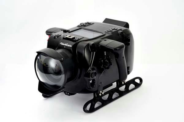

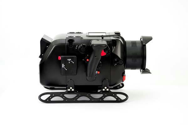

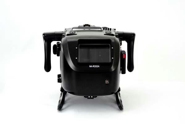

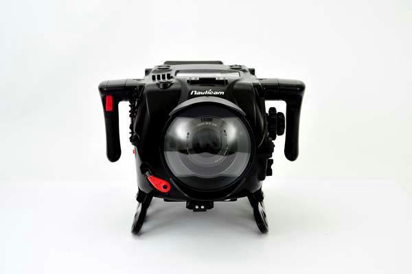

  1. I just got these photo of the new Nauticam housing for Red Epic and Scarlet.
    I haven't specs but, just these pics...

  2. Looks very nice indeed! I've not seen a price mentioned yet though?
    Cheers, Simon
  3. Nauticam dealer told me it seats in the 10K euro range
  4. Needs a top handle of some sort and a shade....I do think it is a little late to the party though
