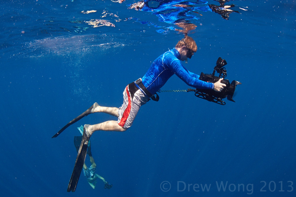

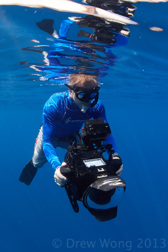

  14. Here is Mark with the Red housing in action:
    Mark chasing a whale...fully legal with permits mind you!
    Mark trying to focus

  15. Drew
    I don't see any whales! Just snorkelers LOL
    Vis is nice and clear.
    Have your tried the housing yet? What do you think of the manual focus? Zoom is super smooth. I think the focus could be made to have the same finesse.
    I could pack the whole housing plus a mini-dome into a carry on bag. Amazing. I can't wait to test this housing out.
    David
  16. Only used it for a short while today. It's not the complete rig and really still in beta phase, it's a little unfair to comment too much publicly.
    Focus is pretty loose and lacks precision, especially when using non-cinematic lenses. With some lenses having very short focal distance scales, trying to use the Red Mon focal distance meter is more difficult than one thinks.
    As you can see, the rear monitor suffers from big reflections so Mark had to put a shade made from a flower pot to see the monitor.. It's nice to have the Red Mon for viewing but the rear window is sorta handycamish. Obviously that's a personal preference thing.
    Snorkel only usage with a bit of free diving
    Edited by Drew
  17. Hey Drew
    Looks like vis. is pretty okay. I wish I could be there mate.
    You are using the 230mm dia. dome!. Does it balance well? I am going to test my DIY dome and see if that works well with Nikon lenses particularly the 14-24. Watch this space.
    There is a Nauticam rear monitor shade but I think they will have to make a hood-like one soon. Nothing like actual field testing to really see how things work. Thanks for the tip. I will be looking for a couple of black plastic flower pots.
    About the focus and zoom gear I agree that it is pretty much at beta stage. The focus has to be smoother. That should not be a big challenge for their engineers. They need to add disengage mechanism in there too. I also find the 'block' replicate everything on the side handle. As you know there is at least three, maybe more ways to access the menu so I guess it is well up there on the redundancy department. I am loving the the side handle control. No more buggy redmote.
    Keep up the field report. I will be going to my trip soon. Pool testing is just not the same.
    David
  18. Well even the very young MJvC is finding that his arms are too short for his eyes on the Red Mon :) The problem for this camera is that it resets everything when using an EF lens because there is the USM reset. So basically, you can't just set the focus and leave it. Which makes the focus dial much more important. The rear monitor isn't for macro shooting for me. I like to eyeball the subject then point the lens onto it for final composure. It's not easy with the rear window. The separate top monitor is better, even though there is less info on there.
    Unfortunately some lenses have a very short adjustment for the crucial focal distances for the virtual image, so I think Nauticam and other manufacturers need to have interchangeable gears for different lenses. I was using the 8-15 and it's less than 7mm turn for the crucial 30-60cm focal lengths, which makes it harder in fast moving objects and rough handling.
    As for balance, the Zen dome makes it front heavy in this bare minimum configuration, but as you can see, much of the housing accessories are missing.
  19. The top monitor was removed because it added too much drag when trying to push it through the water quickly. I think the block and side mounted controls are a terrific invention as you can access all the side handle controls and for me coming from a dslr it is very much the same. I would really love it if they could re-gear the focus mechinism for the slr wide angel lenses that have such a short rack between minimum focus and infinity. Manual focusing underwater with these newer large sensor video cameras is defiantly a challenge. This is made a lot harder when that subject is low in contrast and moving very quickly. On the plus side the system is also quite compact and incredibly ease to set up.
