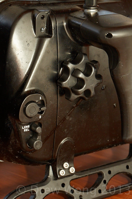

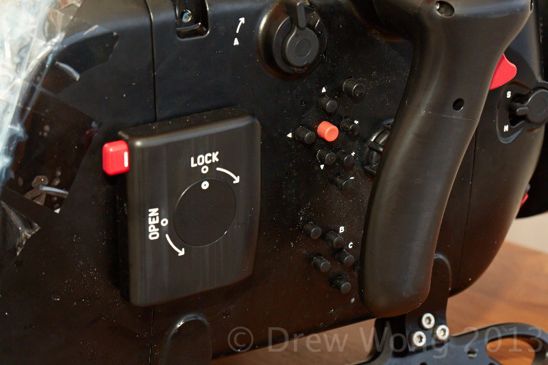

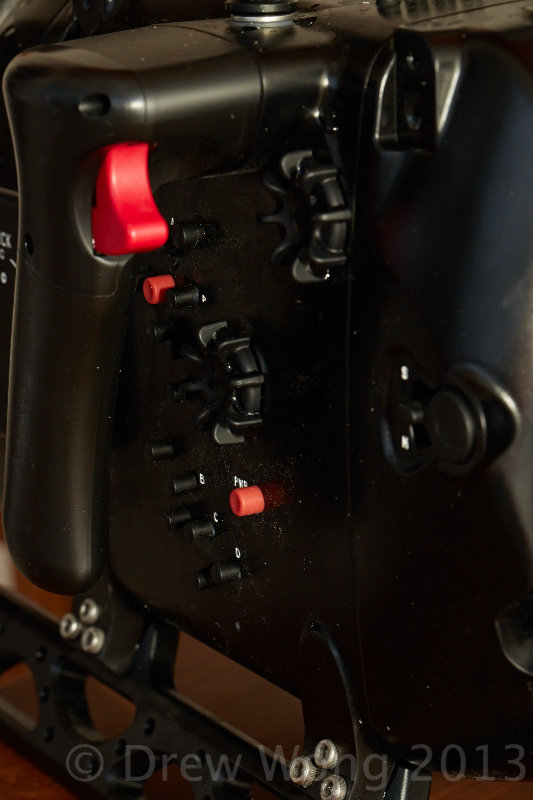

    Right side of housing with controls and locking mechanism
    Right side from the front showing the "block" buttons
    Left front side with focus/zoom control. The lens release system is being redeisgned.

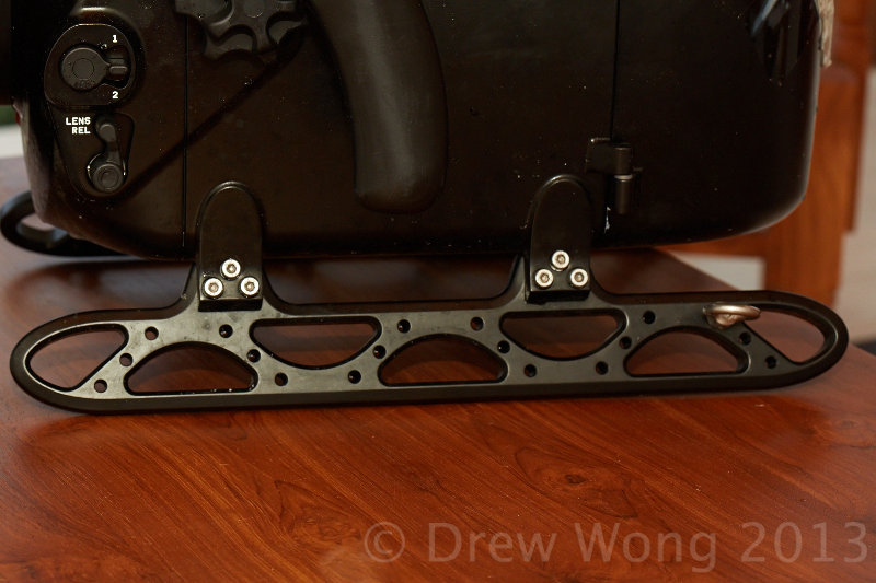

    The housing stand is all aluminum and sturdy. It also allows adding ballast weights etc

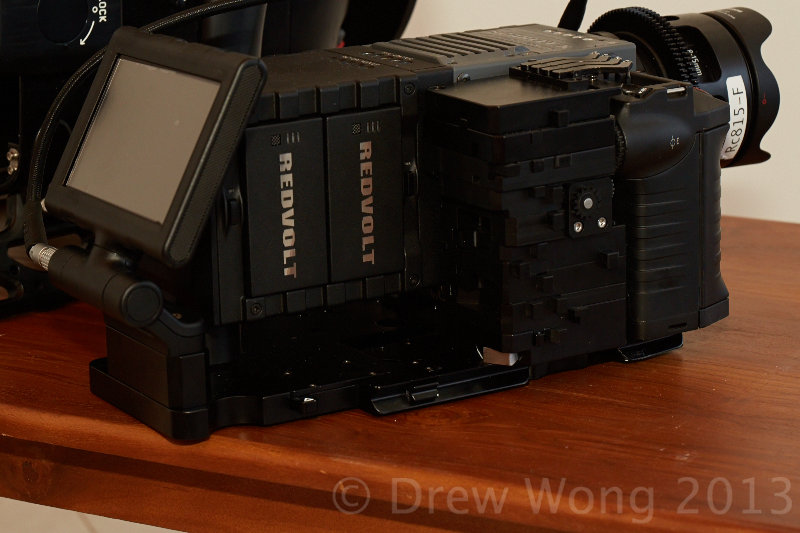

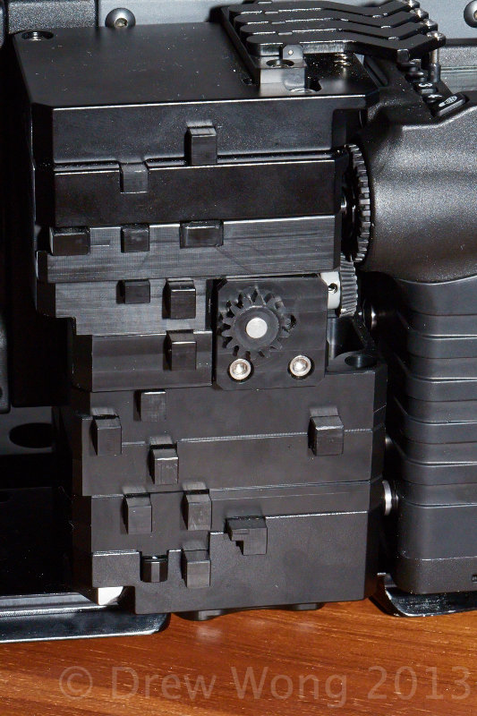

    The camera tray with the "block" controls attached.

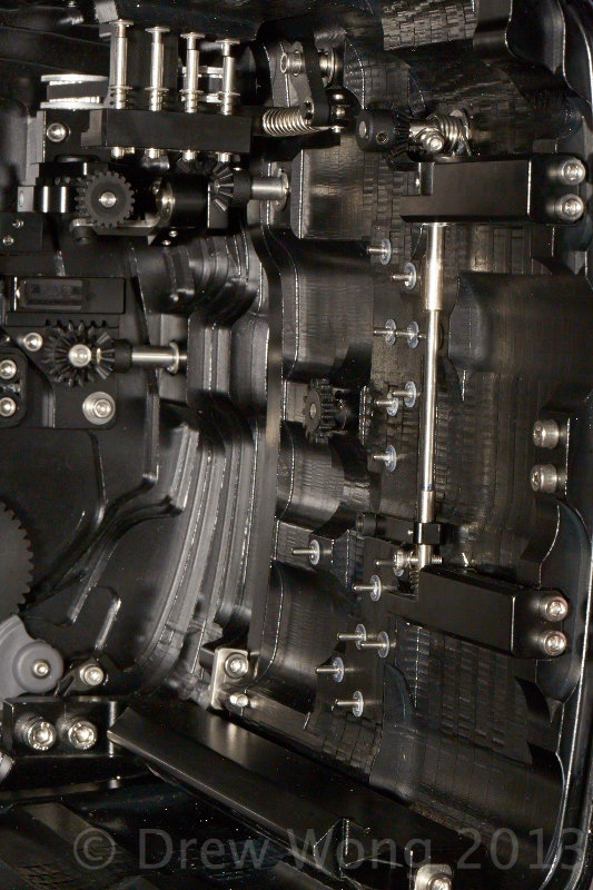

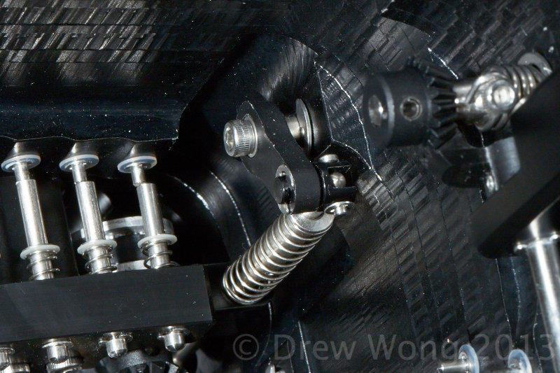

    The Block controls from the inside.
    The Block controls.

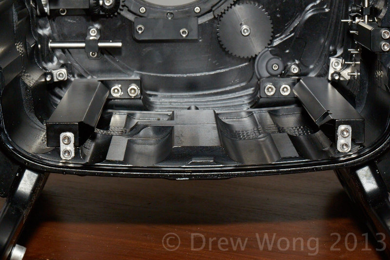

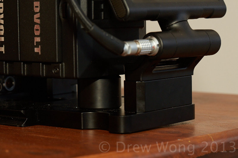

    The tray slider guides make it easy to insert the camera.

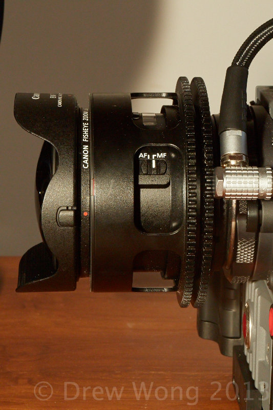

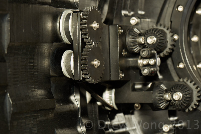

    The lens/zoom focus gears system.
    Red Monitor attachment on tray.
    The zoom/focus gear. Note the lens is in manual... old skool!
    These are just pics. I'll refrain from making too many comments out of respect to MJvC. He is compiling a list of things for Nauticam to peruse. I will say it's really a compact housing and an interesting first attempt. There are a few things that need major improvement, so for those looking into Epic/Scarlet housings but not immediately, the Nauticam is worth looking into.

  3. Look at the design which has gone into that....that is amazing, could do with a little rinse though Drew, looks a little salty ;)
    Does it have plastic cogs? Do they have play?
  4. Hey we use our housingsm It's not ornamental! :)
    And being salty is a good test for a housing's durability and resistance to oxidation. ;) But really we've been so busy that the pics were taken in 10 minutes before we recharged everything and went for dinner. Being at sea for 10 hrs a day in UV 12 and feels like 44°C is not easy! :)
    The dials are plastic, as are the handles, which makes it lighter for travel.

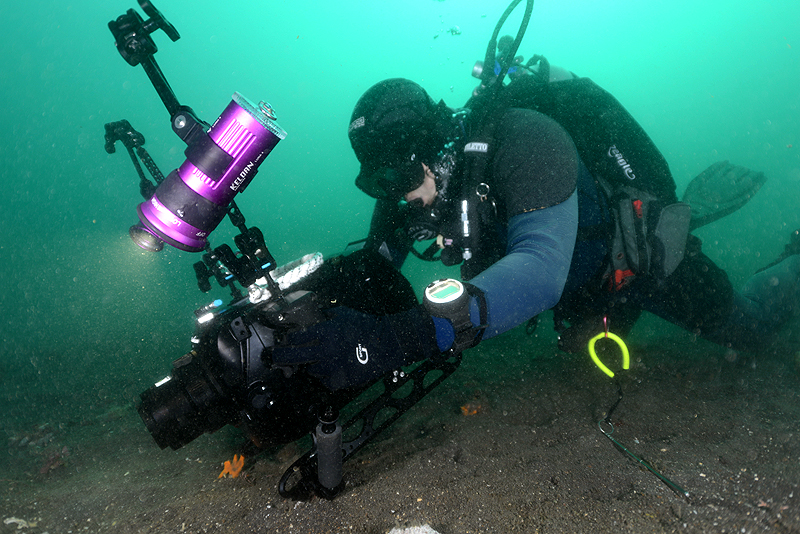

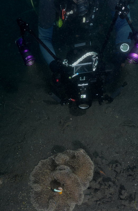

  19. I have been testing the Nauticam Rossa in Lembeh Straits recently. Too busy to do a full review but will later. Probably after the ADEX show.
    Here are some teasers.
    Not the best visibility at the time. The housing is well balanced. The slider weight at the bottom helps to adjust the centre of gravity of the housing. The finger tip controls are a joy to use. In this case I could balance the housing on the legs. I attached two ball arms in front in case I need more stability. Two more at the back and you have a quad-pods that could be made stable in any situation.
    With the Nikon 105 VR macro it is more like 147mm macro. S35 sensor has a crop factor of approx 1.4 with FF lenses. I was surprised to see the size of the image on the screen. Great working distance too.
