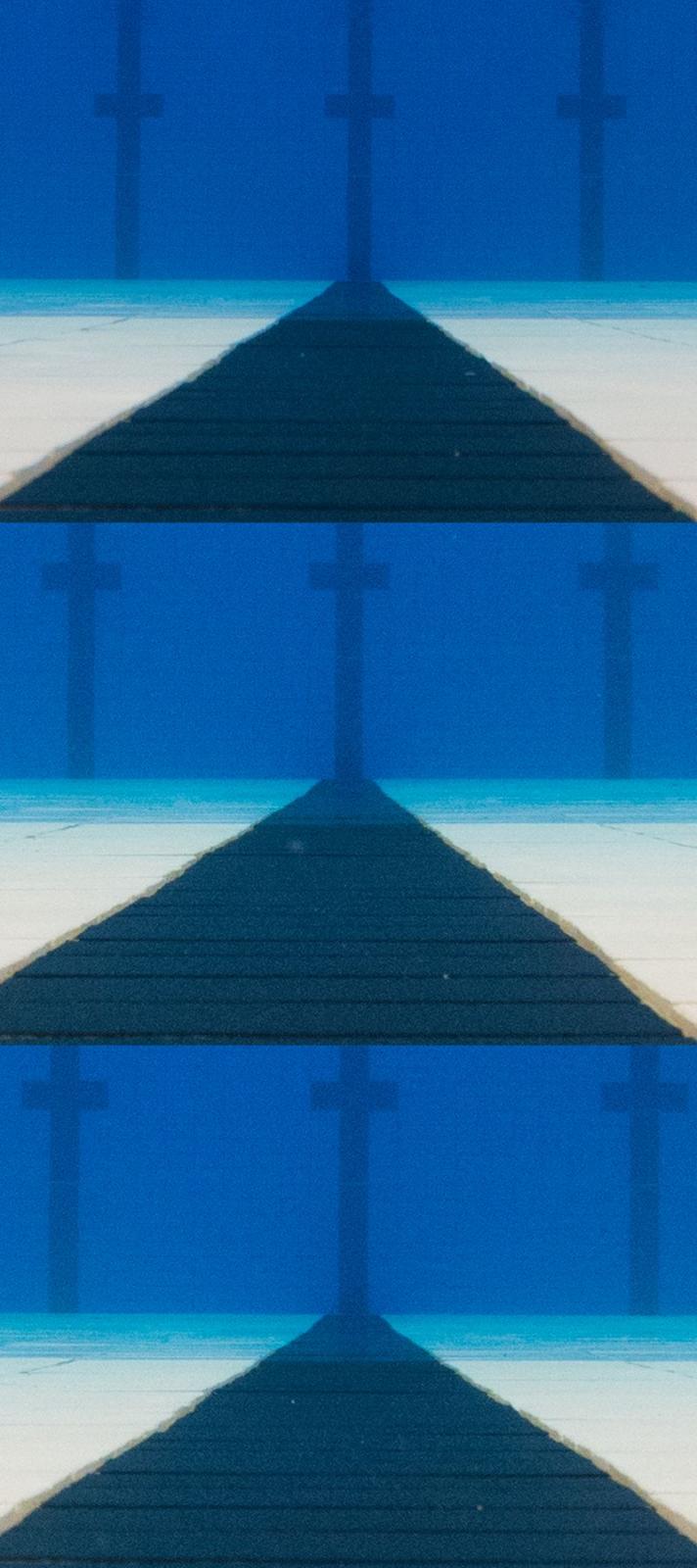

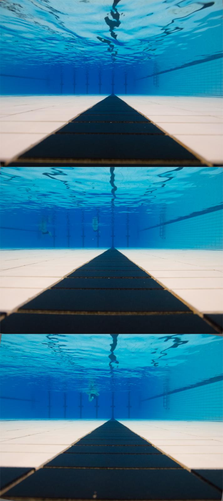

  1. Even with the +4 diopter, I was able to focus at infinity, however I lost some AOV due to the distortion correction. The third image is a composite of 1:1 crops of the center section of some distance shots, at f/4. From the top: +0, +2 and +4 diopters.
    The fourth image is a downscaled composite of the full distance shots. From the top: +0, +2 and +4 diopters.

  2. Conclusion: I'm going to use the +2 diopter in the future when I'm using my 9-18mm behind the 4" dome port. The loss of AOV is rather negligible, and the improvement in corner sharpness is dramatic. While even f/11 gives noticeably poorer corner sharpness without diopter, the +2 diopter gives acceptable corner sharpness already at f/5.6 and pretty good at f/8. The distortion - and the CA - caused by the cheap closeup diopters can be handled quite acceptably by Lightroom.

    2. The overall quality of the pictures is rather crappy. Due to low light, I shot at ISO2500-3200, with shutter speeds of 1/30-1/10. The excellent stabilizing system of the E-M5 handled the low shutter speeds quite well, but some general softness due to high-ISO noise and slow shutter speeds is unavoidable. I didn't apply any noise reduction or sharpening except Lightroom's standard settings.
    I'd like to know why the diopters improve corner sharpness. Are the edges of the virtual image too close to the lens, so the camera can't focus properly, or is there some other reason that I don't understand?

  6. Great results Storker! I bought the diopters as well a few months ago but never went into the water to try them. As soon as I can I will try with the 4.33" and 3.5" domes as well. The results look good. There has been an ongoing complaint for more than a year about softness on the edges with the 9-18mm lens open and the diopters do seem to solve the issue then.
    +2 diopters does not even change FOV that much either it seems so it may be the optimal value. I saw the +4 was not bad either and that may be a choice if you want a closer focus. The 18mm focal setting may even allow getting some decent close ups (I never liked the fact that the 9-18mm does not have close focusing capability).

    I think I saw some added CA, but it was quite manageable in Lightroom and could be almost completely removed. On a normal underwater subject, I doubt if it's very noticeable. And, of course, an extra layer of glass will decrease optimal sharpness and increase the risk of flare. However, with the much better corner sharpness, I'm willing to accept that tradeoff.
    What is the actual subject distance by the way?
    Somewhere around half a meter, maybe a little less. Just enough to fill the frame with an A3 size sheet at 9mm FL.
    How does the distortion look change with the diopters, more barrel-like?
    Pincushion. Very noticeable if the subject has straight lines close to the edges of the frame. For that kind of subjects, you need some correction, but as I said in one of the previous posts, LR (or PS/ACR or PSE) can handle it easily.

  9. The soft corners are because the curved virtual image that we are photographing has the corners much closer to the sensor than the centre. We rely on depth of field for the corners to be in focus (but it's often just not enough). I think that the diopters work by causing the image to appear further away to the camera (the camera focus changes from say 0.4m to 0.8m). This, of course, also allows you to get much closer to your subject because the minimum focus distance is now much closer than where the camera thinks it's focusing. By making the virtual image appear further away, the focus distance is also at a place where depth of field is greater and the corners can now be sharper. That's my take on it, i've never read why this works, but this seems reasonable.
