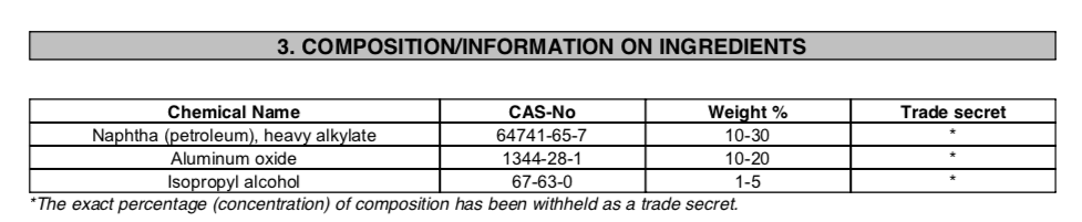

  5. I've been reading up on this as I have some stains on a (coated, according to specs) Inon UCL-165 lens bought second-hand in Thailand afew years back.
    Looking into Mothers California Gold Water Spot Remover for Glass (which is available in Indonesia, but way more expensive than the zillion other glass cleaners / spot removers offered to car-lovers on Tokopedia)
    I found a safety data sheet which lists the following ingredients for Mothers:
    Mothers_06712_MPUSSDS_USA.pdf
    I guess Aluminum oxide would be the most active / abrasive?
    Edited by bghazzal
    It's the only thing abrasive in the mix, the rest is just a carrier.
