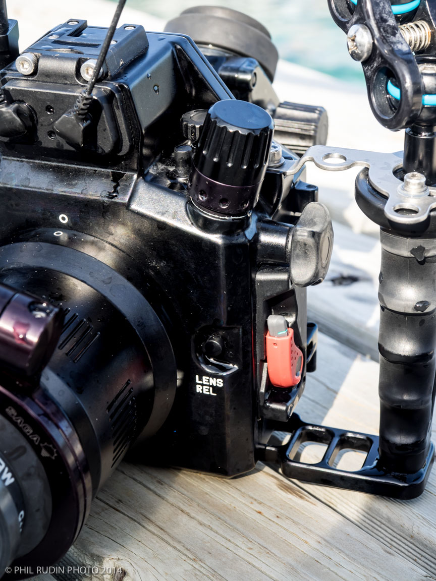

  7. I also had the vacuum system installed into my new Nauticam NA-EM1 housing and after around 75 dives I have had no problems. Once you get into the routine of using the system it adds little time to the assembly process and adds great piece of mind. It is a bit like the cell phone or something else you felt you could live without until you have it. You can read my full review of the vacuum system in back issue #76 of Underwater Photography Magazine on line at uwpmag.com.
