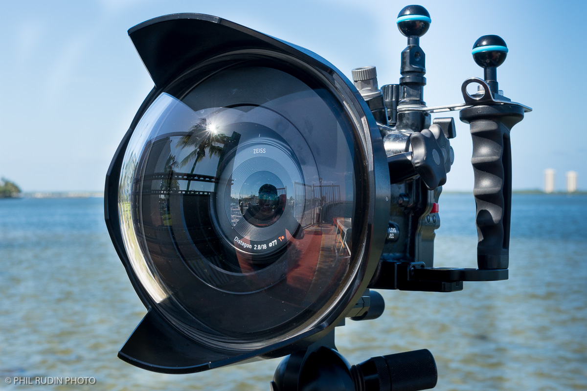

  15. I use the ZEN 200mm n120 optical glass port for the Olympus 7-14 and other lenses. It can be paired with the N85-N120 extension with a wheel for zoom or focus. It you use the focus wheel on the housing with the standard zoom gear you can then get focus with the gear off the port extension.
    See attached parts. The photo is the same type of configuration with the N100-N120 port extension with focus wheel on the Nauticam Sony A7 II housing.
