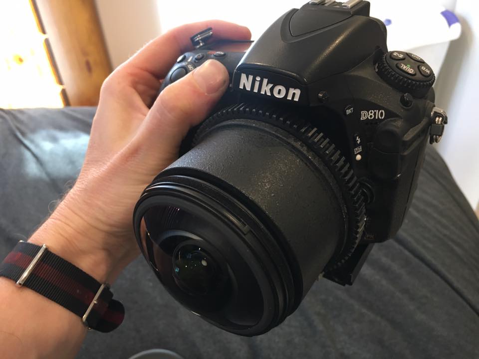

  8. Hey I've been shooting with this lens a bit in Aquatica Digital 9.25" & 4" ports on my Nikon D810 and both ports have gone really well. I didn't use any port extension in the 9.25" and used a 16.5mm (0.65") extension with the 4" port.
    There were some small aberrations but nothing Adobe Camera Raw 9.10.1 couldn't quickly put right by checking the box "Remove Chromatic Aberration Box" I'm still experimenting however, also going to try it on the Nikon D500 tomorrow and write a bit more about it.

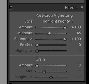

  12. The blue fringe is an attribute common to circular fisheye lens images. I provide a possible "fix" with this image. The Lightroom settings to do this are shown in a separate pic. One pic (black background) shows the same image without the fix. This shot was done with the Canon 8-15.

    Using LR I was able to apply the identical fix to a large number of images in a couple of seconds by synchronizing the settings after checking off only the needed adjustments in the popup menu. One could maybe tweak the settings I used to try and crop less out of the edge. Agreed that this fix is not needed for blue images other than for getting a white rather than black background.
    BTW I seem to recall that a square crop was done first - it has been a while since I did the fix! A square may be needed to get a circular vignette.
