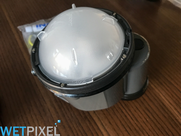

  6. Recycle speed testing

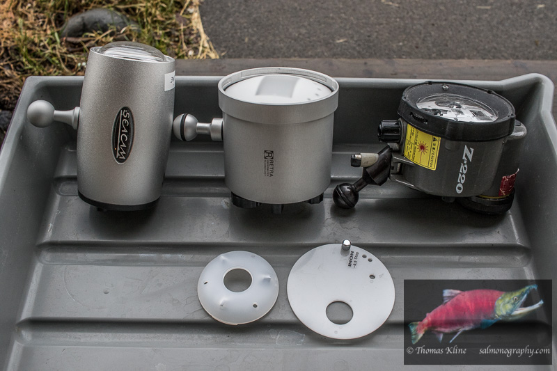

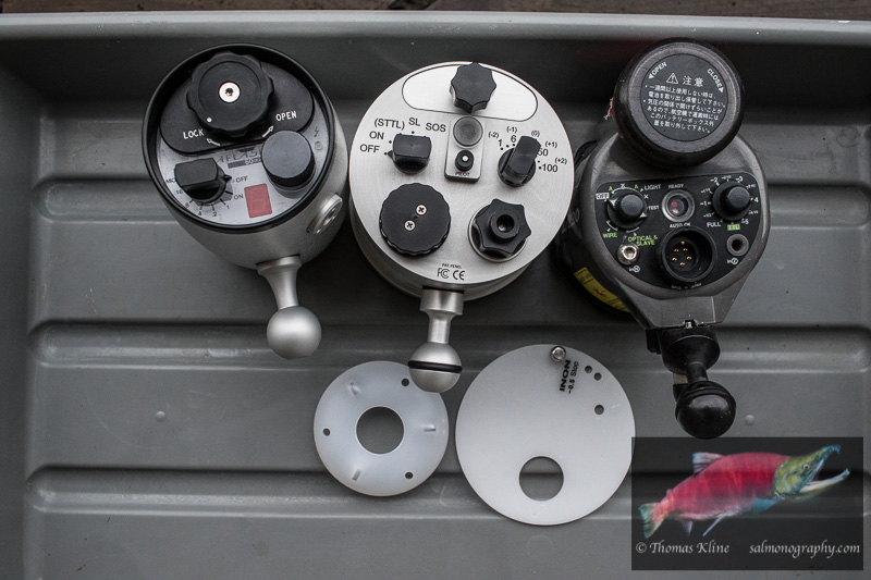

    I took some pix to address your question. The Inon Z220 shown in the pix is the model that preceded the 240 and now 330 is the same form factor as the newer models. The Seacam 60D also shown is another new strobe for 2017. Maybe we should call 2017 the year of the underwater strobe! As well, there is a new J version of the Sea and Sea AA battery model - I keep wanting to call it R2D2 but that is not the correct name. All these new strobes use AA batteries. We just got a foot or so of rain (with storm and gale force winds) so the snow is all but gone (why not in pix) - air temp right now is 8C.

  9. Thanks for the photos, Tom
    For me (without underwater testing, just by comparing the specs) the "want-to have" strobe would be the Seacam: small, beautiful design, 4.400K colour temperature, 130° coverage (GN8 metric / around GN25 imperial), accessories like diffusor, snoot available.
    When I changed from analog to digital I changed from Ikelite SS200 to Inon Z240. What I really missed was the circular flash tube from the Ikelite. For my personal taste the Ikelite gave a much more "pleasant" lighting; maybe because of the circular tube, maybe because of the colour temperature, or maybe bcause of a combination of both). The Seacam has this circular flash tube, the other two not.
    BUT: For the price of one 60D you can buy two Inons or Retras....

    Just to point out that the Z330 is the same body size and form factor as the Z240, but it has a domed lens that protrudes from the front, as opposed to the flat lens cover of its predecessor...This makes them around an inch wider.

    I have had the Z330s in the pool today and shot them side by side with Z240s. I think they are definitely around 20° wider and the power difference is obvious.

  11. @ Jock. I have a similar history with four SS200s at my start with digital. Seacam 60D is the only strobe of the new models with cabled TTL in separate Nikon and Canon versions.
    @ Adam. Good point about the protruding dome. The Retra and Seacam 60D also have protruding domes though maybe not to the same extent. One can put on protection rings hide to enable placing the strobes face down on a table to work on them. I just did this with one of my Retras as I had to swap out the wired bulkhead - this was very easy to do. I left these rings off in the pix. I used the groove in the Paterson developing tray you see in the pix to help with balancing the strobes when placed dome down. It look as if your plate will be full comparing these new strobes!
