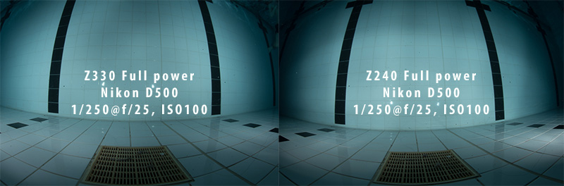

  9. Here is an underwater image comparing the power and beam angle of the Z330 to that of the Z240
    No diffusers were attached and camera settings were identical for both images.
    Three things that are fairly obvious:
    1. The Z330 is significantly more powerful. I would guess around a stop
    2. The beam of the Z330 is quite a bit wider. The specs suggest a 10° difference, this would suggest that it is more.
    3. The fall off and edge of the beam of the Z330 is a lot softer. In practice, I think this will make the light produced by the Z330 much better.
    Testing continues...the Retra Flash arrived today!

  10. Thanks for posting Adam,
    I can see that the Z330 has less fall off, but oddly looking at the two photos the one shot with the Z240 looks brighter in the center.
  11. I think it is just contrast Geo...
    The histogram are here:
    Z330
    I just posted the wrong histogram! The above one is correct.
    Z240

  12. Here is an underwater image comparing the power and beam angle of the Z330 to that of the Z240

    This same shot Adam Z330 vs Retra would be very interesting to see
