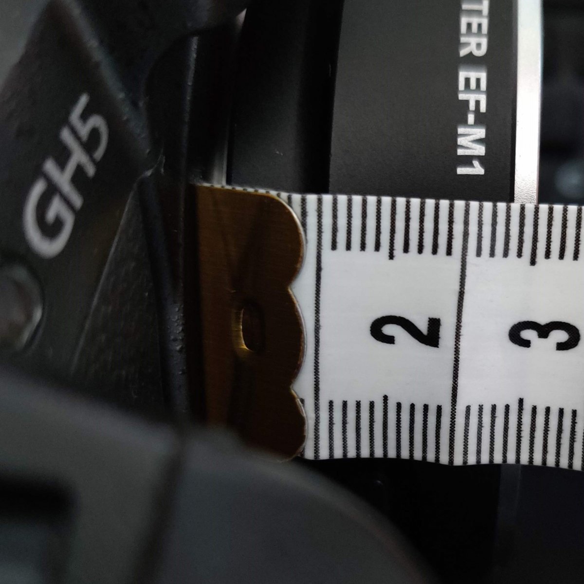

    Thanks Wolfgang,
    See below photo of Viltrox EF-M1 mounted on GH5. I recognise measuring tape is not necessarily the most accurate tool but length of protrusion from the lens mount is ~25mm. I'm expecting then 30mm extension is best suited for Viltrox EF-M1, 35mm extension for Metabones 1x.

  7. 3 minutes ago, joncroweucl said:
    Thanks Wolfgang,
    Canon EF flange distance 44mm. MFT 19.25. Difference 24.75.
    Additional extension needed 24.75-19.25=5.50mm
    The speedboster is shorter so needs only 30mm extension
  8. 12 minutes ago, joncroweucl said:
    Thanks Wolfgang,
    The added length that I measured for the Metabones are:
       1x adapter: 24.7 mm
       0.71x speedbooster: 19.3 mm
    => Viltrox 1x has same length as 1x Metabones and requires the same extension, i.e. 35mm. You also need a zoomgear extension. printed 3D (I put the file somewhere here and Massimo has the file for download on his homepage)...
    Wolfgang

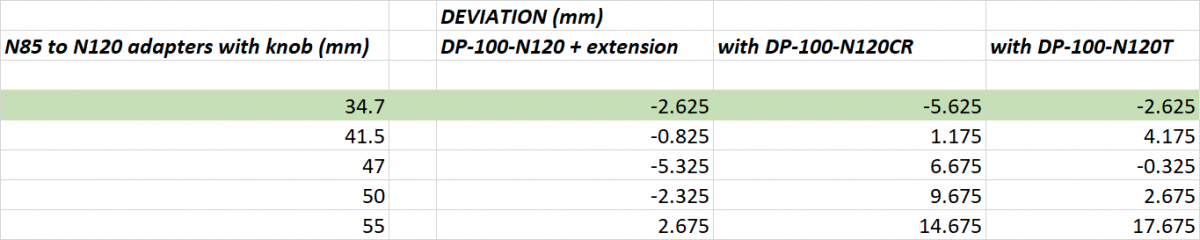

  14. @Architeuthis and @Interceptor121: To follow up on the adapted Canon 8-15 FE on MFT: If one were to go for a  lighter setup, would the Zen DP-100 Fisheye Dome Port be a viable alternative to the Nauticam 140mm dome?
    What is interesting from the Zen N120 port chart is that the DP-100-N120CR does not have a specified extension ring:
    https://www.portchart.net/zen-only/by-combination-group/nauticam-n120/
    I'm not sure how this can be feasible; I've reached out to Zen customer support for clarification.
    Have either of you considered the 100mm dome for 8-15FE on GH5?

    No. The lens is very large and needs an extension
    If I wanted something smaller would go with tokina and speedboster

    Hi Jon,
    Initially I have considered the Zen DP-100 (for EM1II, but this should not make a difference), but I did not acquire it. Partially the reason was the right extension: The DP-100 comes with built in extensions for the Canon 8-15mm, Tokina 10-17mm or nothing (blunt N120 version). The Nauticam 34.7mm N85-N120 is made for the Metabones 0.71x focal reducer, while one wants to use the 1x Smart adapter with Canon 8-15mm. The Smart adapter is 5.63 mm longer than the 0.71x speedbooster, so none of the versions fit as they are. I made  a table with all N85-N120 extensions that I found available from Nauticam (used with or without additional available N120 extension rings) and calculated how much the deviation (in mm) is from the recommended one:
    The closest match would be the 47mm N85/N120 extension together with the Tokina version (DP-100-N120T) with only 0.3mm deviation. I refrained, however, from ordering this combination, since I was thinking in case it would not work I have an extension and a domport that is not good for any of the lenses that I have. The 34.7mm N85/N120 adapter, that is designed for the Metabones adapter, gives 2.6mm deviation at the best. I do not know, how much worse IQ would be, but I think the smaller the dome radius is, the more effect on IQ per mm wrong positioning...
    I am eager to hear what Zen support tells you. I also asked them and was told that fisheye lenses are very tolerant for wrong positioning and they recommend the 34.7mm N85/N120 adpater plus 25mm extension (as listed above) - but they cannot guarantee anything...
    Wolfgang

  17. I think the question to ask is whether anyone is successfully using the 8-15 with Zen 100mm dome on a full frame Canon.  Zen are recommending it and produce a port specifically for that the Canon and Nikon 8-15 fisheye zooms.  If people are using it and are happy (enough) with the results it's highly likely it's going to perform just as well with a m43 system if you place the dome in the same spot.  Note I said perform, it will certainly work but the quality penalty is a bit unknown.  But I don't expect it to be significantly worse than using a native m43 8mm fisheye lens unless the positioning was way out.
    I don't have the experience to prove it but I expect if you are within 1-2mm you are not going to notice a difference in performance - The closest most manufacturers get is +/-5mm using multiples of their standard extension rings.  I would recommend a combination that has the calculated extension or less, additional extension may start to introduce vignetting.
    If you want an example have a look at this link with shots from a Nikon 8-15 fisheye behind the ikelite 8"compact dome port:  https://www.ikelite.com/blogs/reviews/nikon-8-15mm-fisheye-lens-underwater-photography-review
    The entrance pupil on this setup is well forward of the centre of curvature as the dome used is a very small segment of a sphere - it has to be well forward so it won't vignette.   This shows the lens still performing OK when not placed exactly in the right spot.   I'm not saying it's as good as the image you'd get in the 140mm dome with the correct extensions - but it might be acceptable.  But for this application we are talking about getting the entrance pupil within a few mm or the recommended position.
    It's generally said on this forum that the small 4"domes suffer a bit of an image quality penalty on full frame cameras, but people will accept this to make a better wide angle macro setup, the smaller the dome the better in such a setup as it directly impacts upon subject size in the frame and also the ability to light the image well.  This is going to be less of an issue on m43 as you are cropping much of the worst parts from the image.
    So in summary I believe if you get the lens positioned within a few mm of the calculated position , performance will be at least as good as it for the 8-15 in a 4"dome on a full frame Canon.

    There is no difference in the positioning of the lens vs. domeport on different sensors. The difference is that with MFT one uses just the central part of the image circle, approx. 26% of the area compared to FF. Hence the IQ in the corners will be much better (as is the angle of view narrower: 8mm fisheye on FF is circular fisheye, while on MFT it is 180° diagonal fisheye)...
    I can confirm that on MFT (EM5II and EM1II) camera, sharpness, also in the center, is at least as good with the Canon 8-15mm (with 1x Smart adapter) and also with Tokina 10-17mm (with 0.71x speedbooster) compared to the native Zuiko 8mm. This hold for the lenses behind the Nauticam 140mm port and also the Zen DP-170 (where the positioning is much closer to the port glass as ideal, since the DP170 is a WA port with larger radius, not a fisheye domeport that ought to be a hemisphere).
    I have no experience, however, with the DP-100. But I remember faintly that Chris is using a 8mm fisheye with the DP-100?
