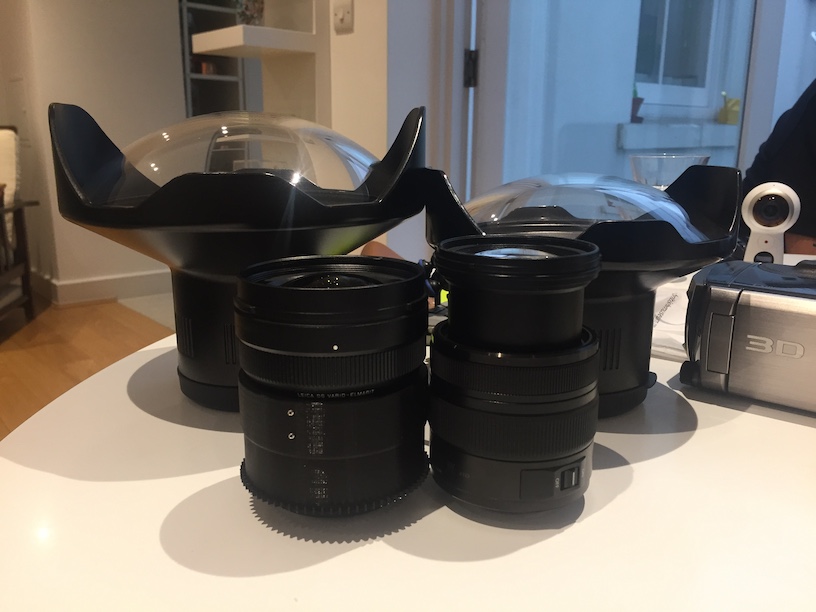

    I've taken the plunge and picked up the 7" acrylic Nauticam dome port today (I'll be able to claim back the VAT ;-)
    The removable hood on the 8-18 lens is way too big to fit through the "extension" part of the dome port, so the hood can't be used anyway...
    It is much bigger than the 6" (sorry for pointing out the bleeding obvious but there is more difference than I expected.) It appears to be a bigger section of the same radius sphere as the 6"
    I'll be getting it wet in a couple of weeks time, on my first trip to the Red Sea since 1993! (I mostly dive in IndoPacific).
    I'll also try it with my Pana 12-35II, usually used inside the 6" dome for video and portraits, to see if I can just take one dome for both on future trips... Living room testing suggests that it'll be fine in the 7" dome; it doesn't appear to vignette. It does extend quite a bit on zooming (photo below shows it at 35mm) and only just fits inside the 6" dome in any case (the hood must be removed on this lens too btw).

  2. I've taken the plunge and picked up the 7" acrylic Nauticam dome port today (I'll be able to claim back the VAT ;-)

    If it doesn’t vignette the 12-35mm will work fine in the new dome. At this stage I would consider selling it and investing in the leica 12-60mm that is generally a more useful lens and you can fit it in this dome too
    Also despite the optical impression the 7” is a cut of a 14” dome while the 6” is a cut or a 12” dome so the new port is larger...

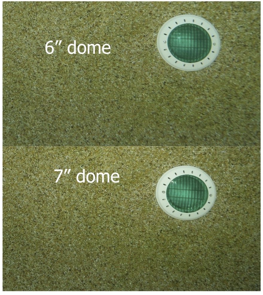

    I've done a bit of testing in the pool.
    Here is my rough comparison of the Panasonic 8-18 in the Nauticam 6" vs 7" acrylic domes:
    The lens fits in both, but the 6" is noticeably softer (distorted) in the corners and edges.
    The photos below are frame grabs from 4K video on the GH5, cropped to lower-right quarter only, lens at 8mm and F5.6.
    Not a proper test by any means, but it was enough to satisfy me that I will only use my 7" dome with this lens, even though its a bit bulky.

  6. Thanks for the quick reply and test shots.
    Yeah there's definitely a difference which you've nicely shown.
    I've currently have the 6" dome but neither of the wide angle lenses. I'd prefer the 8-18mm for topside work so debating whether a bit of softness in the corners is an alright trade off.
    Centre of the 6" is alright?

    Yes the centre is fine. Its similar to how the Pany 7-14 behaves in the same dome (if I look back at some of my older stills with that combo). I think you'd need to zoom to 10mm or more to avoid the corner distortion but I haven't tested. It was the softness of the 7-14 in that dome that drove me to get the 8-18 and 7"...
    I'm happy with results from the lens inside the 7" dome, its not perfect, but to get any better would involve glass and probably various extensions/adaptors. I also love the lens topside.
