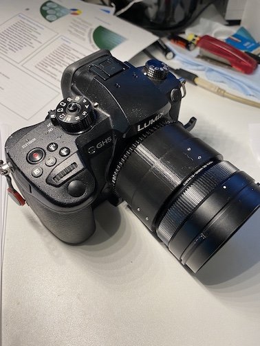

    Hi,
    That's interesting, I don't have any trouble getting the camera/lens in and out of the housing with the dome attached?
    Which zoom gear? I use a 3D printed one, not Nauticam.
    Yes, internal refections can be a problem. I minimise it by painting parts of the lens with a matt-black artists paint (see my post above)

  8. On 6/8/2020 at 4:06 AM, dave@immersed said:
    Hi,
    My bad, with the nauticam zoom gear it fits the N85 port. It's me doing it bad before.
