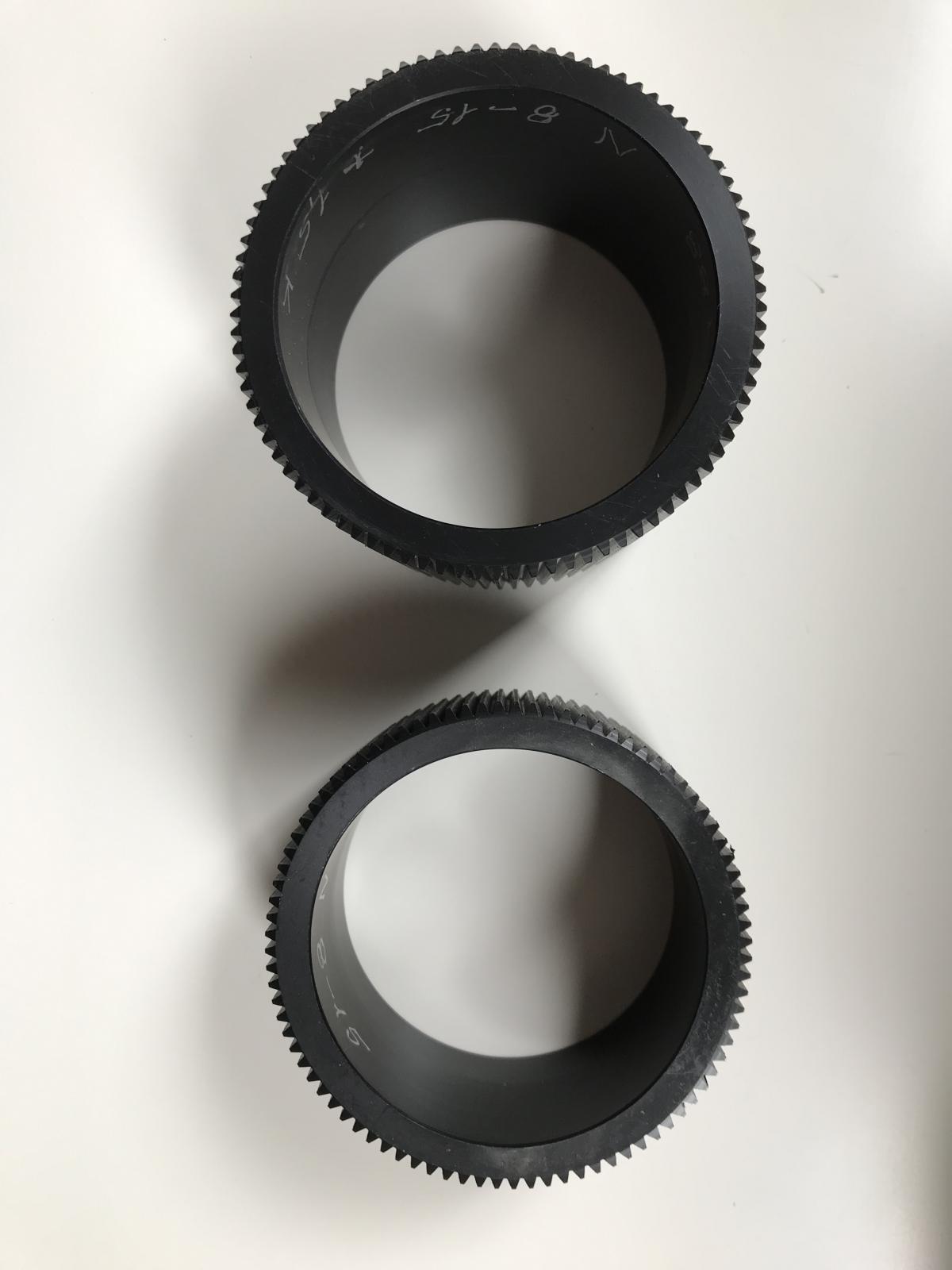

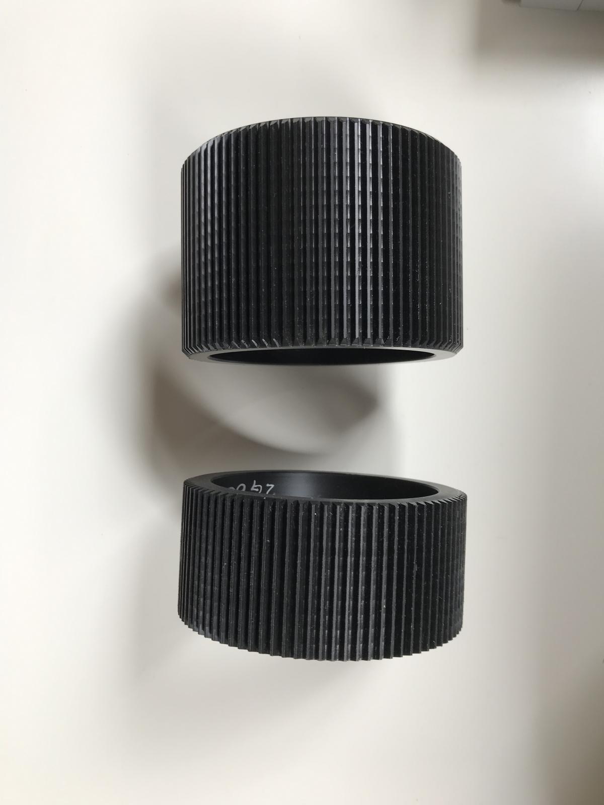

    - On the zoom gear, you're right, Subal don't have one listed but I asked Vladimir at Subal and they agreed to make them. I did ask WP folks in a post at the time if anyone else wanted one but got no takers. Photo attached side-by side with the Subal 8-15 zoom ring.
    - The 8-15/TC1.4 zoom ring is 2"+ 7/16" long or exactly 600mm. The part number, hand-written, in the ring is "ZG88 N8-15+1,5K". I'm assuming the "1,5K" is a typo and it should be 1.4K
    - The straight 8-15 zoom ring to compare is 1' + 1/2" long, exactly 400mm.

  18. Thanks Tim! Wow, your regular 8-15 zoom ring looks a lot different than mine. Mine has mostly flat area with just a few teeth in the zoom engagement mesh area. I didn’t think the zoom rings were that different with the Subal ND500 and Subal ND850, but maybe they are just different iterations?

  19. Yeah, I was a bit surprised too when I saw those rings. Like you, I was expecting some smooth-sided ring with teeth at one end. But hey, it works! Different iterations maybe as you say. There should be no difference between rings for a D500 and the D850 - or any other Dxxx.
