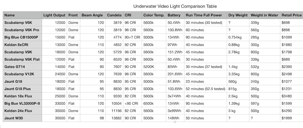

    First, let’s take a look at the advertised specifications (I’ve included the V6K Pro and the Jaunt G18 models and some other 10k+ lights for comparison purposes):

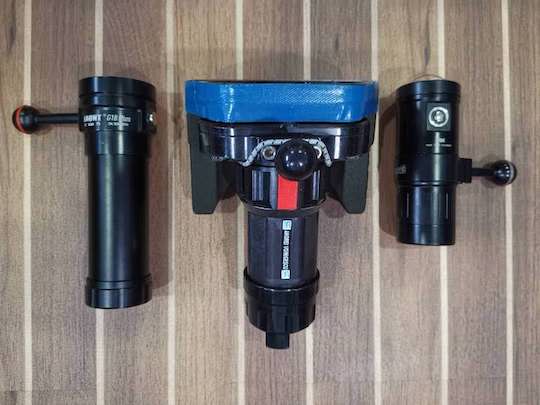

    A side by side size comparison (the GT14 has a home-made float attached, but is still negative):
    post-42872-0-33043800-1546874680_thumb.jpegpost-42872-0-50537800-1546874676_thumb.jpeg
    Comparison of the chargers, from left to right, GT14, V6K and G18 Plus. The Jaunt light has the smallest charger, a nice perk for travel.

    [EDIT: Updated the table to include two Big Blue lights (which I believe aren't great options ultimately) and the projected specs for a Scubalamp V6K with a flat front element]

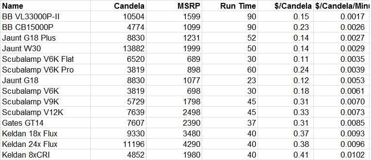

  8. I updated the chart to include a Candela column as an easy reference for the ultimate strength of the lights (assuming the beam angle is sufficient to fill your frame). A doubling in candela means the light is one stop brighter.
    I added the projected specs for a Scubalamp V6K with a flat front element and added two Big Blue lights, though ultimately I don't think they look as promising as the Jaunt and Scubalamp lights.

  11. Dreifish, this is super interesting and a really great piece of work. I agree with your overall conclusion that the Jaunt G18 appears to be the best overall light, factoring in output and beam angle. That said, I think that run time and price are an important factor in the purchase decision for most people. To account for these variables, I took your data and calculated the average dollar per candela per minute of run time.
    Not surpringly, the BigBlue lights come out on top as they are clearly the "value" option within this field. They are closely followed by the Jaunts (W30 and G18) and the Scubalamp V6Ks (Flat and Pro). The next tier includes the remaining Scubalamp lights (V6K, V9K and V12K) followed by the Gates. All three Keldans cluster at the bottom of the list, largely as a function of their premium price.
    I suspect that a V6K Pro Flat would be very competitive, based on this methodology. Assuming same candela as the V6K Flat with the run time and MSRP of the V6K, this yields a $/candela/minutes of 0.0023, which puts it in between the two BigBlue lights.
    Obviously, this is a simplistic price-value comparison that does not take into account other elements such as CRI, reliability, usability, etc. I just think it is interesting to see how these lights position against each other when all variables in your dataset are normalized. I have enclosed the below worksheet with all the gory details.
