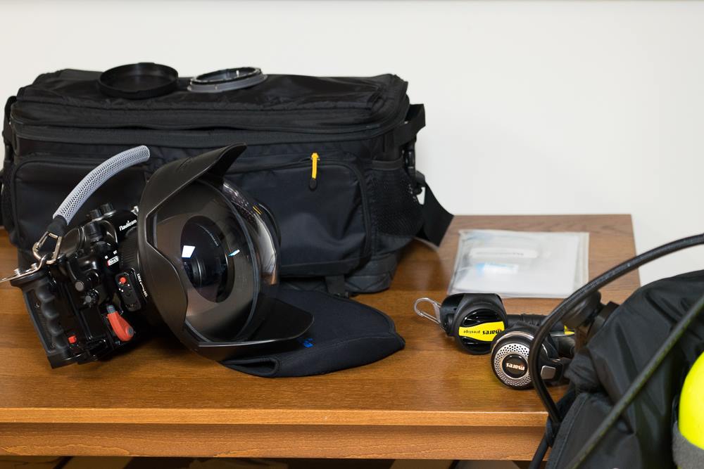

  5. Agree with Tim - 230mm dome is HUGE. Here's a picture of Nauticam's 230mm dome on the NA-A7II to give you an idea. I've since switched to 180mm.
