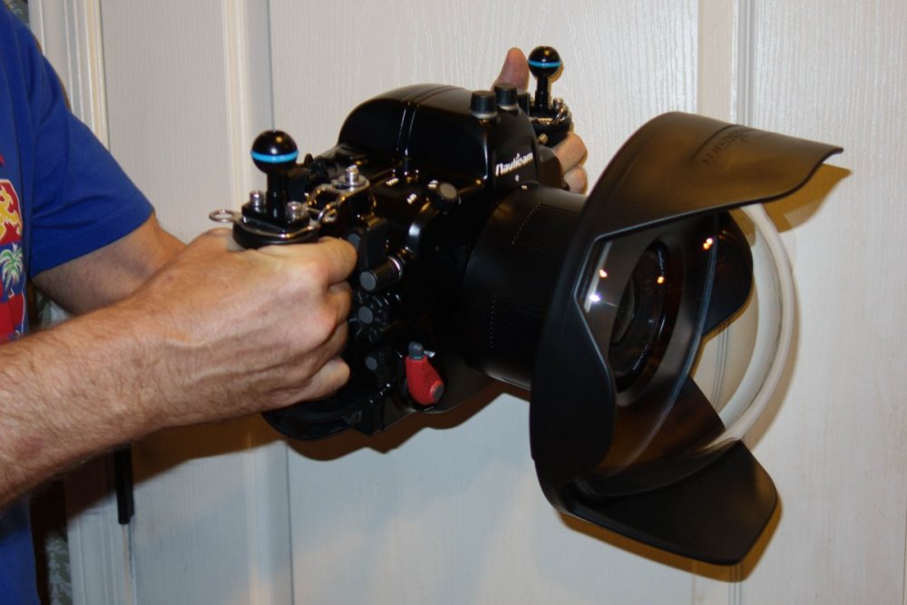

  9. On 7/18/2019 at 10:20 PM, TimG said:
    On the 230 dome port, if at all possible, Id suggest you take a physical look at the size of the port before deciding. I moved to a 230 port some years ago and was actually shocked when it arrived at just how big it was -
    Hah! I am not alone.  I too was shocked when I saw my 230mm dome port.  I had never seen one before mine showed up with my first DSLR Nauticam rig.
