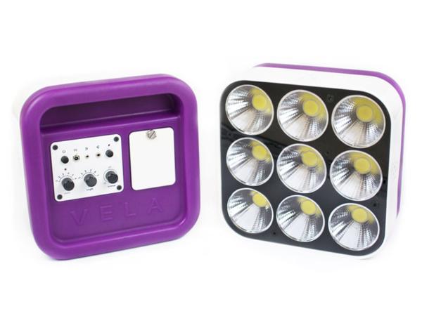

    While collecting information on our beloved and often frustrating underwater strobes (1), I came across two ‘back from the future’ strobes which may be of interest to Wetpixel members, one maybe for underwater use, the other to photograph a bullet as it shoots out of your favorite gun. They seem to be of interest as they may portend the kind of underwater strobes in our future.
    First, here is the just released Vela Strobe, compact, elegantly designed, with four AA batteries to power it for all day use.
    I quote its description (2):
    “The Vela One is the fastest flash you can buy. Take pin-sharp photos of supersonic bullets and explosions using a normal SLR. The pulse width is adjustable between 500ns (1/2,000,000 sec) and 5µs (1/200,000 sec), which is fast enough to freeze a high velocity rifle bullet in flight. It can flash continuously at up to 50fps, and burst at up to 100kHz. This extremely short pulse means it needs to be orders of magnitude brighter than other LED flashes to achieve a usable exposure. The Vela One boasts nine ultra-bright 5000 lm chip-on-board LEDs, which are boosted over 2000%, giving peak flux of up to 1 million lumens.” (Please see Footnote 1)

    Given the Vela’s small size, low power consumption and ultra-fast flashes, let us hope it soon re-incarnates as an all-solid state underwater photo strobe.
    Notably, these two strobes of the future are built around, not flash tubes, but high lumen LED’s (4).

  2. The Vela is a cool idea, but it really doesn't put out a lot of light. The air GN is about 1.7 (compared to 32 for a YSD2.) This means that you will need to be a few inches from your subject. BUT it might be interesting to take their power circuit and put Z330 for example. The Chip on board LEDs are very interesting but ridiculously expensive compared to a flash tube. If you take 6 of them to get really high power you have about $400 just in LED parts (in 10,000 quantity).

  4. This is really not a breakthrough that extends beyond very high speed flash, they are over driving current LEDs to produce very bright light for very short periods, they say themselves conventional LEDs are not up to the task, it's a niche application. The issue will be that to get bright enough for UW work you need to increase duration of the flash and the implication I get is that this would destroy the LEDs they can stand the sort pulse but not the longer pulses required for conventional photography.
    To be correct they put out a lot of light but can only do it for very short pulses. You have to be very close and also use wide apertures, most mobile phones are f2 or so, so they can get away with a lot less light compared to the f8 plus we want to shoot at underwater.

  9. Again, a 500ns flash is thoroughly useless outside the realm of high-speed photography (speeding bullets and the like). Underwater, we use the flash to overpower sunlight, and flash sync speeds for interchangeable lens cameras tend to range between 1/160s and 1/500s. Even at the top end of that scale (and very few ILCs reach it), 1/500s is two million nanoseconds. That is four thousand times slower than this LED flash longest pulse of 500ns. In practical terms, this means that the flash is active for only 1/4000 of the time that your shutter is open - the other 3999/4000 of the time, the sun is merrily filling your image with green and blue. If you use a fixed-lens camera with a leaf shutter capable of syncing at 1/2000s, you can reduce that to 1/1000... still nowhere near short enough for the flash to make a meaningful contribution to the exposure. Vela One's guide number is five feet in air - do you really think this is anywhere near ready to compete with Xenon tubes? And don't forget that it costs almost twice as much as a Z-330 or YS-D2.

    No they can't. Vela One overdrives the LEDs far past their rated brightness for half a microsecond and no longer because pushing them any further would burn them out - and you'd need to push them several thousand times further in order to compete with a Xenon flash.
    Put it this way: if you take a fairly typical 1/250s exposure, that's 4ms - 8000 times the length of Vela One's maximum of 500ns, during which it shines at 1 million lumen. One million lumen divided by eight thousand is 125 - i.e. it will take a 125lm LED to deliver a 1/250s exposure equivalent to Vela One's super-fast super-bright burst. You can get a 125lm LED that fits on a keychain for a couple bucks.
