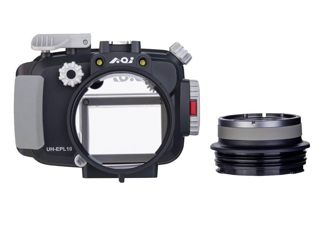

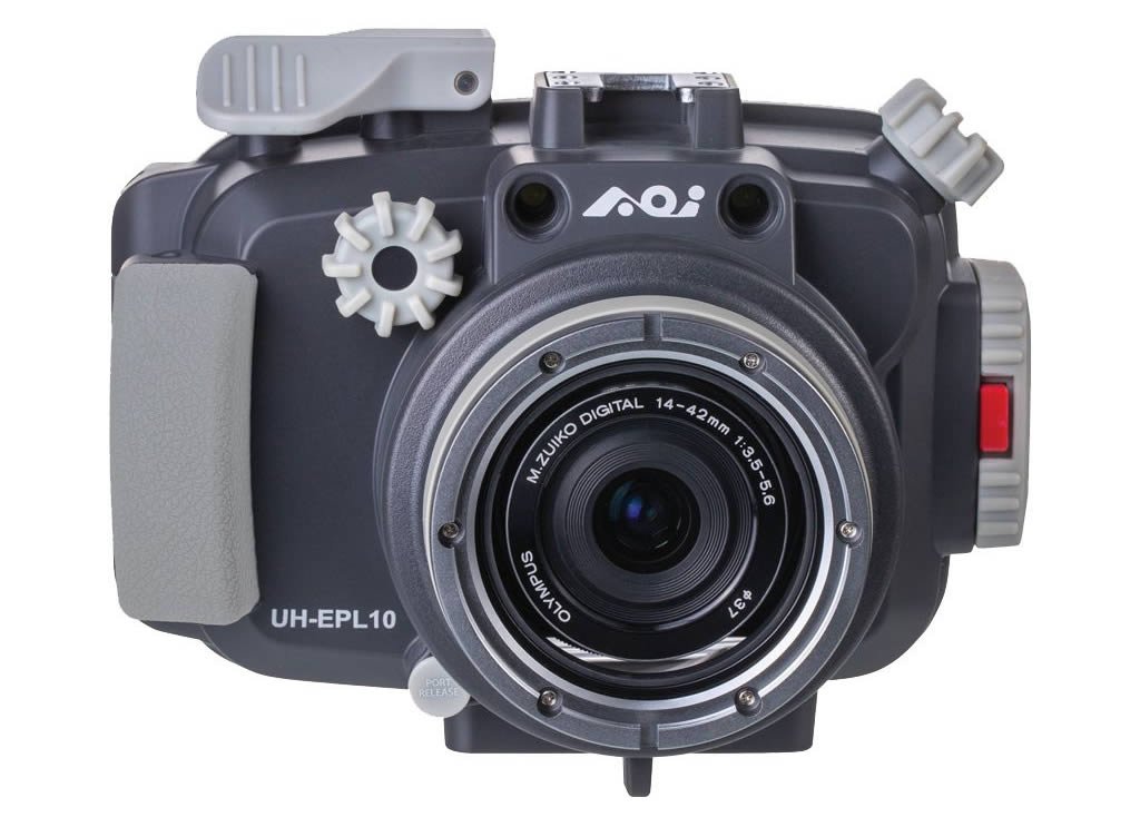

  2. I think that AOI UH-EPL10 with Olympus PEN E-PL10 and 14-42EZ kit lens are very interesting option for underwater photography. You can have multiple settings and use your wet lenses or use dedicated lenses with interchangeable ports (60mm for macro or 8mm Pana/Oly_pro for wide angle).

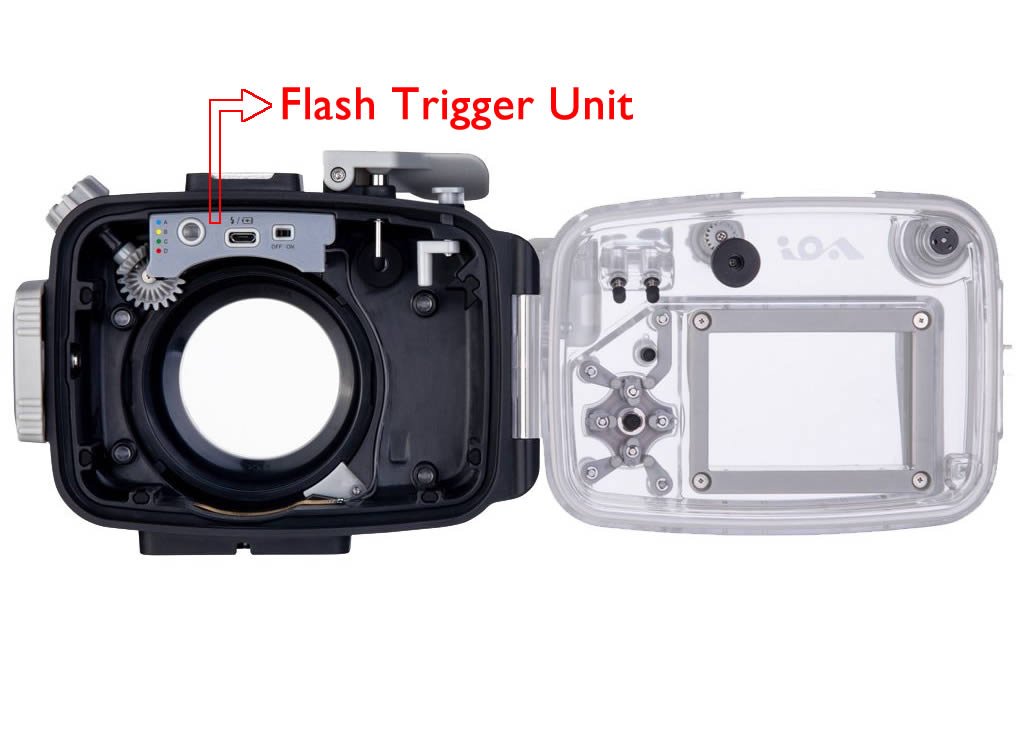

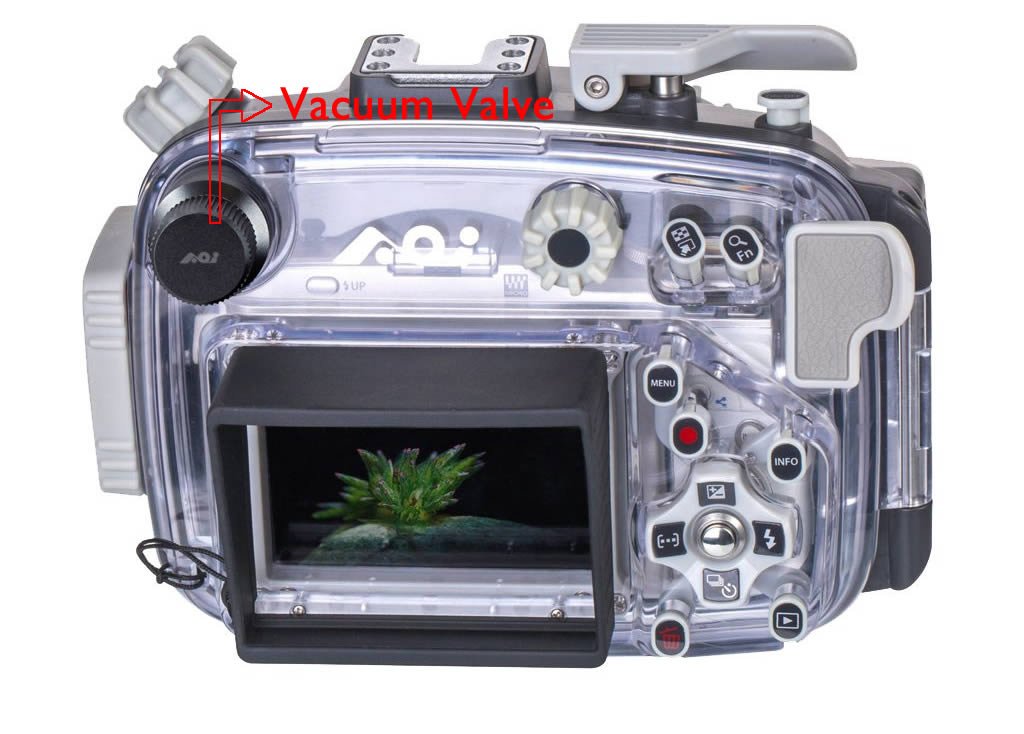

    This underwater case is lightweight and compact (734g on land weight / 26g underwter weight); extra protection with a Vacuum pump and Vacuum Analyzation and Wet Detection System (VWS) and secure lock; Optical Flash Trigger saves camera battery life and eliminates the use of the camera internal flash; ready to use out of the box with housing, lens port and lens gear included (to used with 14-42EZ kit lens).

    About this photos: Interesting what I see in the photos. I don't like the flash system. I like the flash trigger unit that has the AOI UH-EPL10 model, it makes the underwater housing smaller and more compact. Could you contact them to give us more photos?

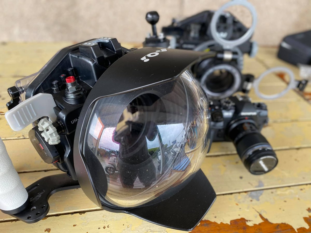

  19. Configuration with EPL10 camera + 8mm WA PRO lens + 60mm Macro lens
    AOi Housing: AOi UH-EPL10
    Underwater Housing for Olympus PEN E-PL9/10
    M.ZUIKO DIGITAL ED 14-42mm F3.5-5.6 EZ
    https://www.aoi-uw.com/products/housings/aoi-uh-epl10-gry.html
    60mm Extension: AOi ER-PN_PN-34
    Extension Ring 34mm PEN Port to PEN Mount Housing
    https://www.aoi-uw.com/products/accesories/aoi-er-pn-pn-34.html
    Acrylic Dome: AOi DLP-06
    4" Acrylic Dome Port for Olympus PEN Mount Housing
    https://www.aoi-uw.com/products/lens-ports/aoi-dlp-06.html
    Dome Extension: AOi ER-PN_PN24
    Extension Ring 24mm PEN Port to PEN Mount Housing
    https://www.aoi-uw.com/products/accesories/aoi-er-pn-pn-24.html
