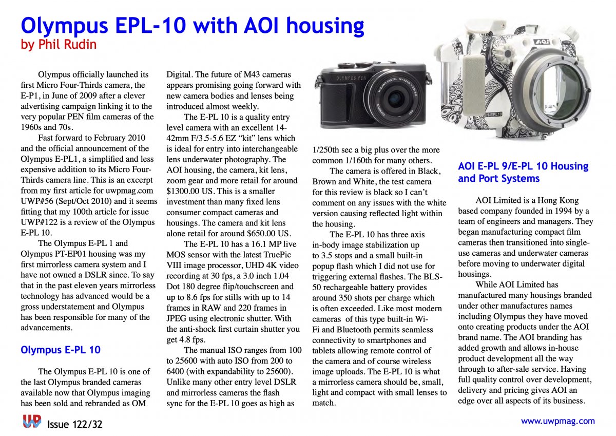

    The answer for Caolino, the original poster is YES the EPL-10 is a valid upgrade from a compact. In fact the target buyer for this system is someone entering into underwater photography, moving up from a cell phone or compact and more. It is without doubt the best value in an interchangeable lens package you can find in the market. The system is targeted at recreational divers just like the old Olympus systems so a 45m depth rating is more than adequate. #1 yes the system is compact, #2 yes battery power is improved because it does not use flash powered by the camera. #3 Yes the recycle times are very fast, the included flash trigger is rechargeable using a mini USB and when I tested this system I never had the battery fail. NO the flash trigger is not TTL, most TTL flash triggers start at around $450.00USD just for the trigger. #4 The housing package from Backscatter with the custom Octo trim ships with the housing, flat port with 67mm threads, EPL-10 camera with "kit" 14-42mm lens, lens gear, vacuum system, manual flash trigger and more for $1298.00USD complete. For wide angle and CFWA you can add a verity of wide wet lenses, I tested the AOI UWL-09 wide conversion lens. For macro you can add a verity of C/U lenses, I tested the AOI UCL-09 +12.5 C/U lens. You can also use the Olympus 60mm macro in a custom port or the 8mm fisheye in a custom port.
    I don't see a huge downside to the 16MP sensor V 20MP for the OM-line because the buyers for this system will not be looking to make large prints in most cases and if they are they should know to pass on this system and go to a larger sensor.
    The comparison to the AOI EM-5 III housing is just not apples to apples because that housing plus the flash trigger alone cost over $1000.00USD.
    If the AOI housings and the compatibility of Olympus PT housing ports seem like Deja vu it's because AOI has built the Olympus housings for years.
    You can read my review of the AOI/EPL-10 system in back issue #122 at uwpmag.com, this is a free PDF download.
