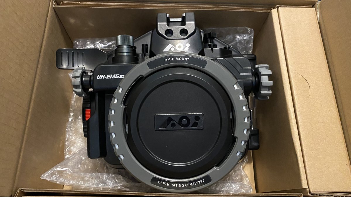

  9. Here are more pictures of the EM5III Housing.
  10. The housing EM5III have the same OM-D Mount that Olympus Housing PT-EP08/11/14 series.
    For M.Zuiko 8mm PRO lens Backscatter recommended AOI DLP-07 / 08 (8 inch) without extension ring setup for best image corner sharpness and AOI DLP-01 / 02 (4 inch) + AOI 22mm Extension Ring when smallest travel size is primary requirement.
    I read the AOI Ports Chart and it's also possible to mount AOI DLP-05 / 06 (4 inch) +  AOI 22mm Extension Ring for M.Zuiko 8mm PRO lens.
    I love the housing design for EPL10, less volume and more compact. I expected the same idea for AOI and Isotta EM5III, it's a mistake to design the housing with the FL‑LM3 flash unit.
    I love this solution..... "flas trigger unit", I love it to keep the design compact.
