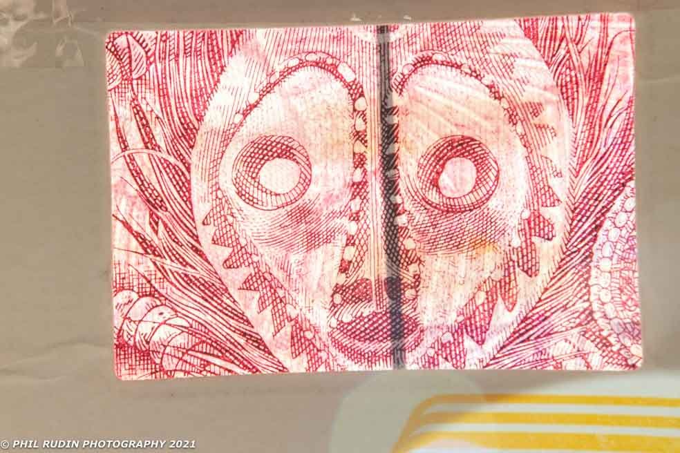

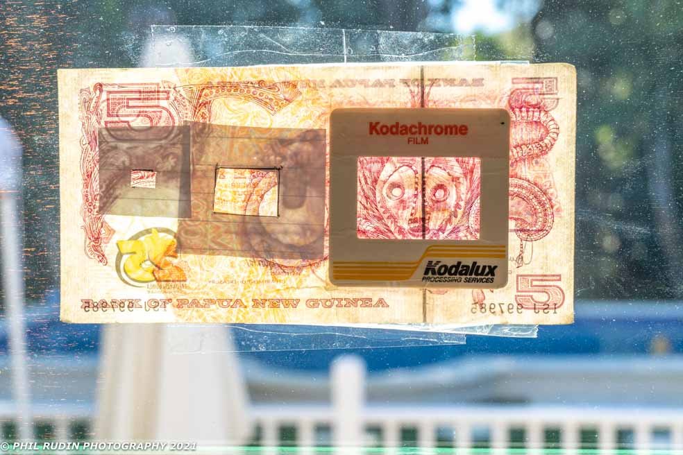

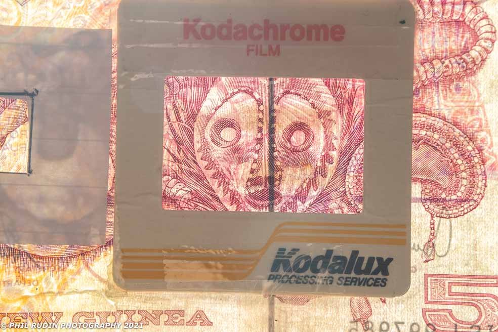

  13. Stuart-Regarding the Sony FE 28-60mm zoom. I have attached a few photos to give you an idea of what you should expect with closeup lenses. The C/U lenses I have in house are the SAGA +5 and the Nauticam SMC-1. They are close in magnification to the CMC-1 and CMC-2 the #2 having less magnification and #1 having more.
    Image #1 is the 28-60 at 60mm with no C/U lens at minimum focus distance of about 30cm. You will see my standard test for life size or 1:1 on the 35mm sensor size. The bill inside the slide mount being 1:1 for 35mm sensors and the image at minimum focus being about 1:5.5 or about five and a half times life size.
    Image #2 is minimum focus distance of about 18cm and about 1:2.4 or two point four times life size using the SAGA +5 at minimum focus distance.
    Image #3 is at a minimum focus distance of about 13cm with the SMC-1 magnification goes to about 1:1.5 or one point five times fife size. The first three images were taken with the Sony A7c a 24MP body.
    Image #4 was taken with the Sony A7r IV in the APS-C mode which is a 26MP image with a 1.5 X crop factor for the FE lens. Image with the SMC-1 at a minimum focus of about 12cm. I would guess this image to be about 1.3:1 or one point three times (larger than life size) life size.
    The Sony 90mm macro on the 35mm sensor starts at life size and the beyond life size depending on the C/U lens used.

  15. NO 1:1, life size does not change, only the angle of view changes. The 90mm macro has an AOV of 27 degrees while the Sony FE 50mm macro has an AOV of 47 degrees. Since they are both 1:1 macro lenses when set at 1:1 the images will be the identical the difference is that with the 50 you need to be closer to the subject to get to 1:1, LIFE SIZE. Life size is when the subject is the same size in real life as it is in the frame so if you look again at the 35mm slide what you see is the same in real life as it is on the sensor. Same same for smaller sensors. A 50mm macro lens on an M4/3 or 4/3 sensor has an AOV of 24 degrees at 1:1 the image is the same as in real life or the size of the sensor. A 100mm macro lens on 35mm "so called full frame" has an AOV of 24 degrees and life size 1:1 is the same size on the sensor as it is in real life.

  18. The simplest way to look at it is the slide frame which is a 35mm frame less a very small border.  That is what a 1:1 macro lens will cover on a full frame camera.
