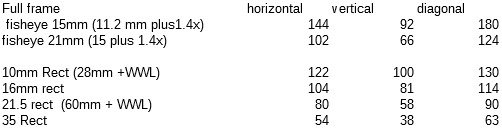

  11. Agree the 28mm with WWL is fairly wide, not as wide as the fisheye of course but getting close.
    Firstly presumably you've been using the 8-15 with your Canon kit - the usage with the Sony will be the same with same angles of view so you can still do that if you get the metabones and Sony port adapters assuming you had a full frame Canon kit and you could do the same with any other Canon lenses and ports you had.
    Second, fisheye and rectilinear aren't completely interchangable and to complicate matters the WWL is between the fisheye and a rectilinear as it has some barrel distortion.  It is roughly equivalent to a 10mm lens in rectilinear This table shows angles of view of various options:
    Fisheyes have a lot more field of view in the diagonal so comparing horizontal field is a good way to compare the two for fitting a large animal in frame.  The WWL is calculated as a rectilinear which is not strictly correct but gives an approximation.  Considering only the full frame fisheye field of view you get 144° across the frame with the 15mm fisheye.  If you add a 1.4x you get 144 - 102° zoom range for your horizontal field.  If you had the 28-60 plus WWL you can zoom from 122 - 80° field.  A 16-35mm gives 104 - 54° field.
    So the WWL with 28-60 doesn't get the reach of the 16-35, but zooms to about equivalent to just under half way through the zoom range.  This should give you some idea of the reach of the various options.
