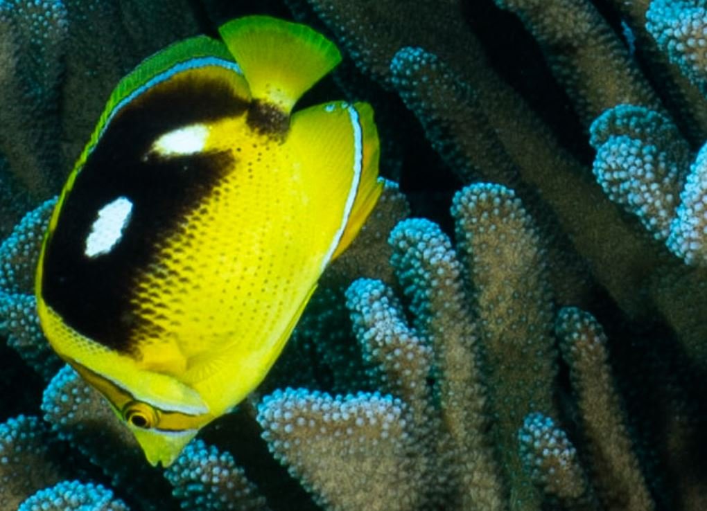

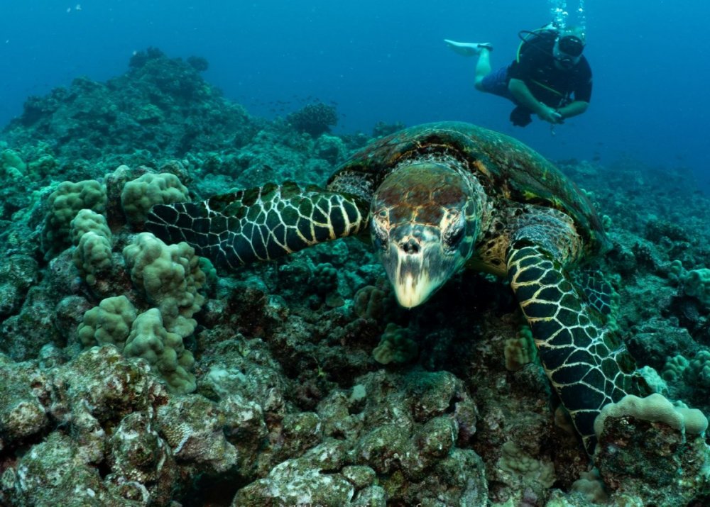

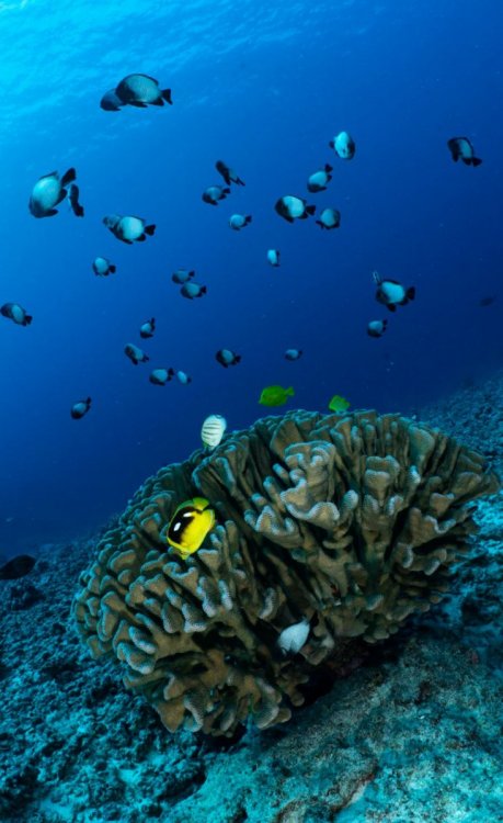

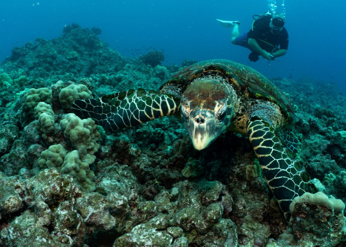

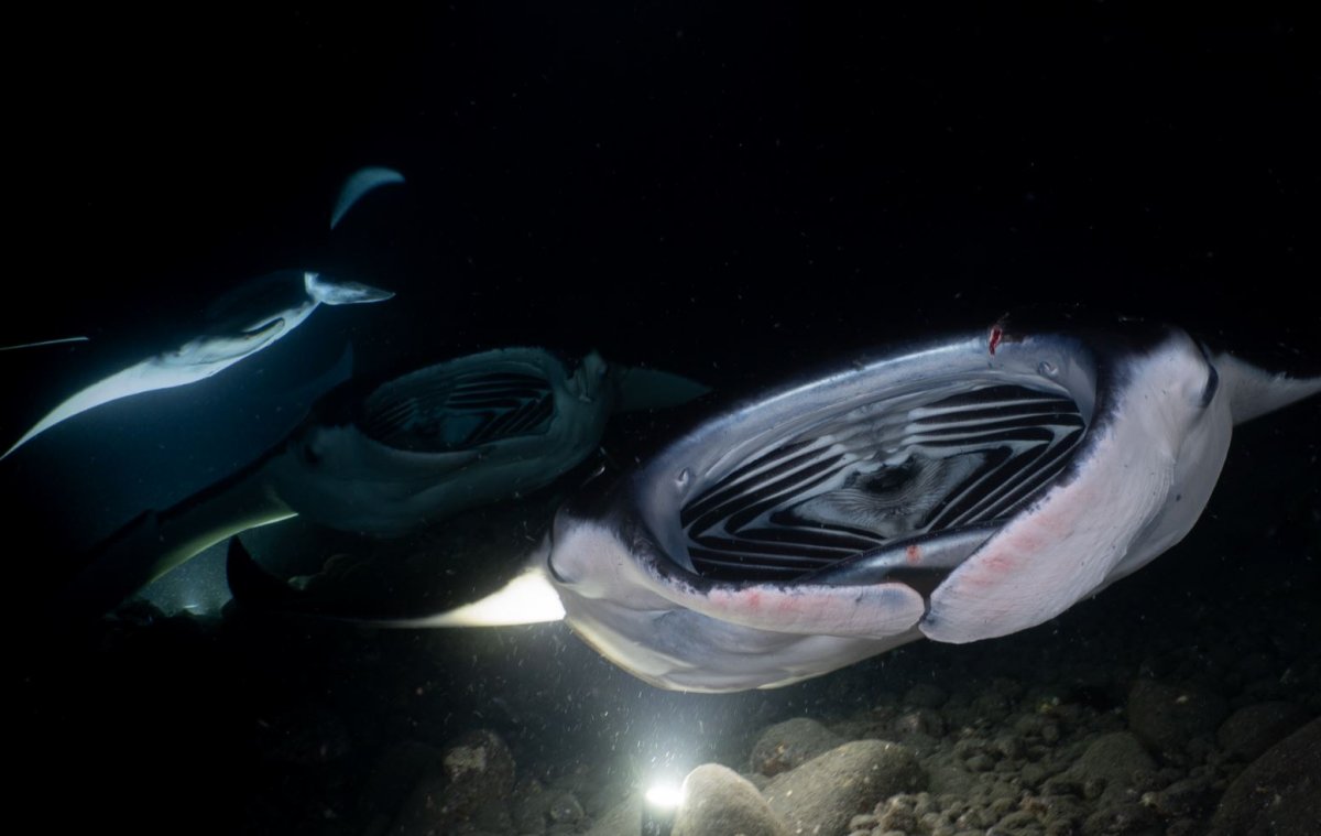

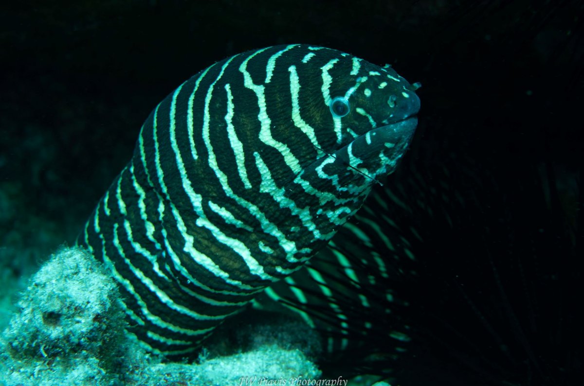

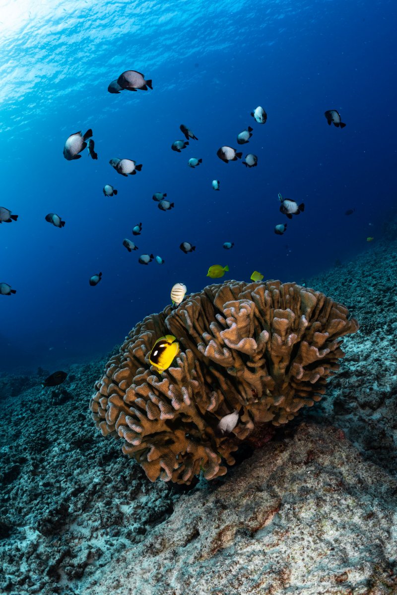

    Just for reference, the following were all shot with the Sony 28-60mm and WWL-1B (on A7C), although they are all compressed for upload. There's times when it might be nice for a little more width, but overall, I've been happy with results although I only have about 20 dives on the camera. I have found that I've tended to get a little too close to subject for good focus.
  4. @RVbldr
    I think WWL should allow you to focus on the front of its dome?
    Would you mind sharing your aperture settings? The corners seem very soft (to me) and it would be good to try and diagnose why.
    Edited by adamhanlon

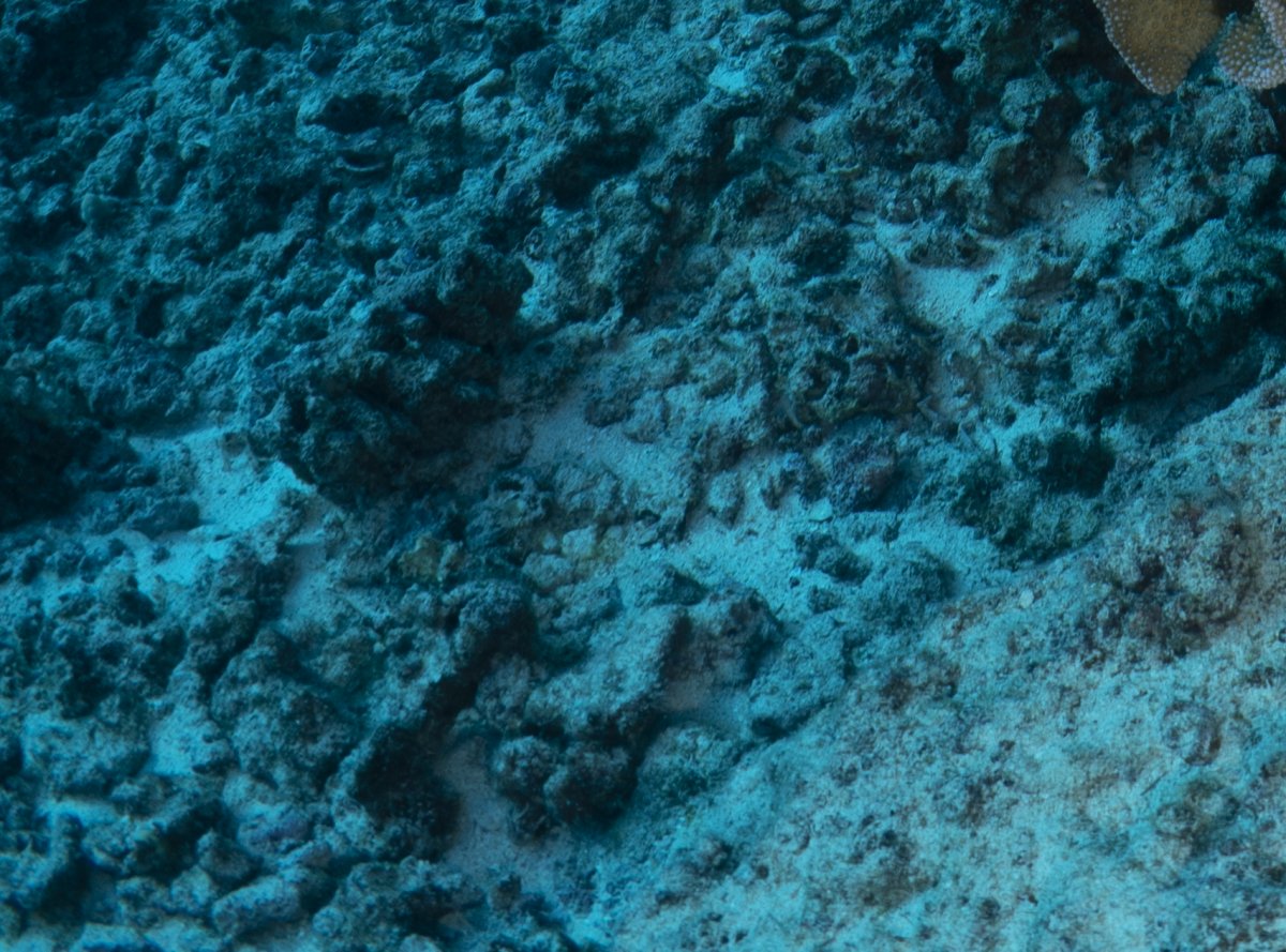

  5. I believe the Zebra Moray was f9 and f11 for manta, and f13 for coral and turtle.
    Here's a blow-up of center vs. lower left in the coral pic:
    Edited by RVbldr
  6. @RVbldr I think those images are convincing me that I want to go with the Fish eye.  What focal length are those manta shots taken at?  In general, all of those shots seem very soft to me.
    I appreciate the responses, and while I understand the comments about FE to Rectilinear being apples to oranges for me I have only ever shot a FE underwater (or macro), so maybe I should just stick with a FE for now and get the canon set up.
    28mm

  10. @hyp While I agree that forum resolution is limited, the corner softness is very obvious. This is not related to resolution just to sharpness...reduced resolution will tend to make everything soft, which is definitely not the case here.
    In the 100% crop of the coral image's corners (thanks @RVbldr), if this is at f/13, I think there is some kind of a problem with this set up. I would expect significantly better corners even with a conventional rectilinear lens and dome combination.
    I must confess that to date, I have not really seen images taken with full frame (Sony) cameras with the WWL conversion lenses that seem to have acceptable (to me) corner sharpness. In the reviews etc. of WWL with full frame cameras that I have seen, the corners of the images that were used to illustrate them seem pretty soft (again to me).

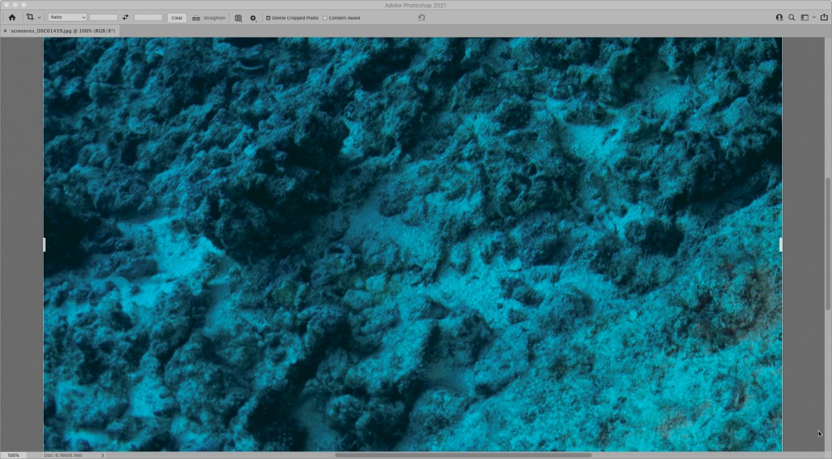

  17. @ChrisRoss- The issue is with the corners, not the center of the frame.
    This a 100% crop of the RAW file. It looks the same on my computer. These corners are (for me ) too soft, especially since at f/13.
    As I mentioned above, I haven't really seen any images taken with the WWL and Sony full frame cameras that "do it" for me in terms of corner sharpness.
  18. For what it is worth, here is a screenshot of the same crop on my computer:

    I think my point was more on the forum resolution question,  your crop certainly looks better than the corner crop posted above, even if it is not up to your standards.  One thing for certain is that a 100% crop will not look as good from an A1 camera.
