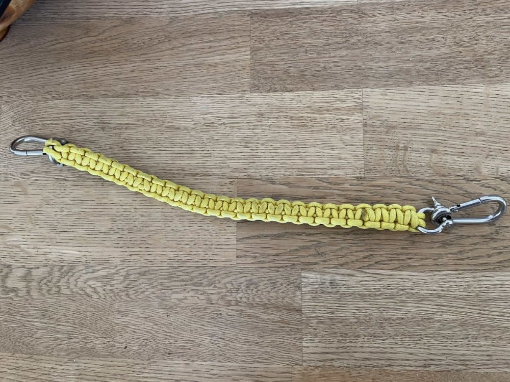

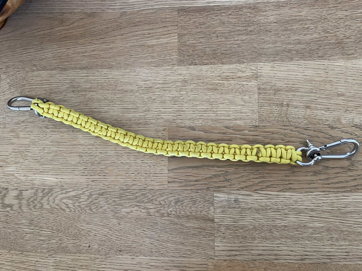

  8. I went snorkeling for the first time, a few times last year.  I borrowed someone's underwater camera (and used a disposable film camera the other times).  I am going again soon.  This time with my own underwater camera.
    I just got a Sony a6100, and the salted line underwater housing.  I went through the setup video.
    How are people attaching the housing to themselves, for snorkeling?  I bought a paracord, but am unsure how to best connect it to the housing, and my wrist.  Does someone have a specific recommendation, and a video on how to attach a strap to the housing?

    There are a million and one one ways of doing this and everyone has their own preference.
    The housing appears to have a loop on the right hand side on which you could attach, for example, a wrist lanyard - or, create a lanyard from paracord (easy - check out Snake Knot on YouTube). Paracord is cheap, super-flexible, very strong and comes in a multitude of colours. You can get it from Amazon.  It's fun to make exactly what you want!

    My paracord looks like this, it doesn't look separated into a strand, like on some videos.
    https://www.amazon.com/dp/B085QL3PKC?smid=A2E32ZWYK8ZMCG&ref_=chk_typ_imgToDp&th=1

  11. Here's video for the Cobra knot (sorry, but you have to flog through a couple of ads) - which I've used a lot. (see the pic). I add small shackles and then carabiners - and, voila! a multi clippy thing.
    You don't have to start with a single strand. You can use two strands (in different colours if the mood takes you).

    Thanks for the video.  I watched it.
    My paracord already came braided, it looks like this:
    It also came with a buckle on one end.
    So what should I do from here?  Do I add a carabiner to the end with the camera housing, and connect that skinnier, non buckle end to the carabiner?
    Also, is a carabiner preferred to the end with the camera housing, or a metal ring?
  13. From the look for that seems to me you don't need to do anything. Just attach the single strand loop end on to the housing loop - and you're good to go.
    You don't have to use a carabiner. Some folks just like them :secret:

  16. I ended up using a paracord and carabiner.  It worked out well and was secure.
