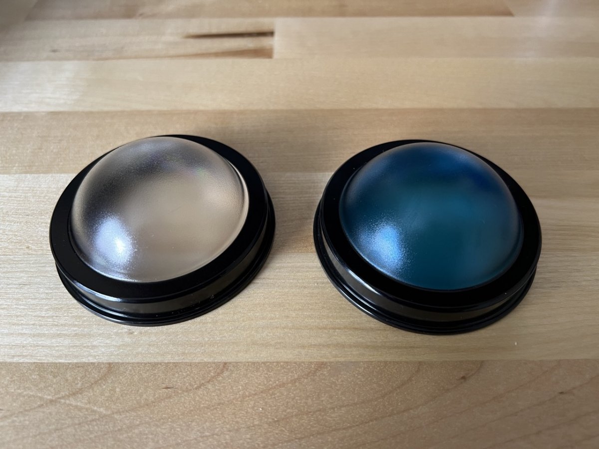

    Yes, they do come apart, and what's inside is a 72mm glass cyan 30 filter. However, according to DivePro, they no longer make the filters and have no plans to reintroduce them.
    Please report your results with the 196. My concern with it would be that (a) it seems to let through a fair bit of red light, which is not good and (b) the overall transmission is listed at only 26%, which means you'll lose 2 stops of light. That's definitely more than the Cyan 60 and probably more than the Cyan 90.

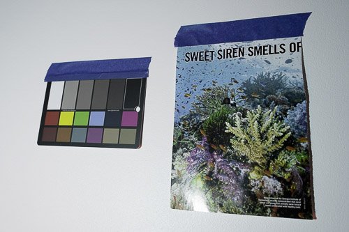

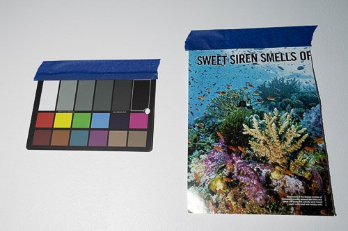

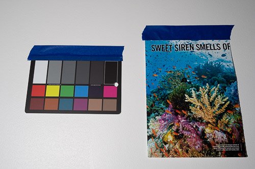

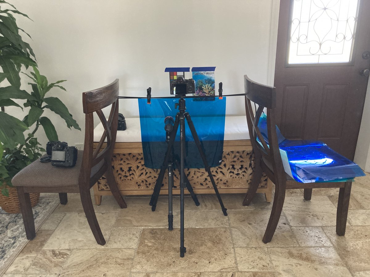

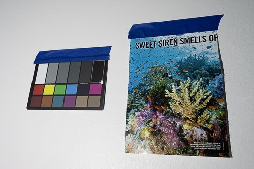

    New batch of filters have arrived, so I set up a new testing station. This time I shot with the Sony A1, so the WB kelvin values in Lightroom are a bit different than the prior ones on the GH5.
    • No Filter = 4850K, +23 Magenta, 0 stops light lost
    • Rosco 4390 (Cyan 90) Filter = 8900k, +141 Magenta, 1 and 1/3 stop of light lost
    • Lee 353 Filter (Lighter Blue) = 15250k, +111 Magenta, 1 stop of light lost
    • Lee 724 Filter (Ocean Blue) = 26000k, +97 Magenta, 1 and 1/3 stop of light lost
    • Lee 172 Filter (Lagoon Blue) = 50000k, +148 Magenta,  -100 Aqua saturation, 2.4 stop of light lost

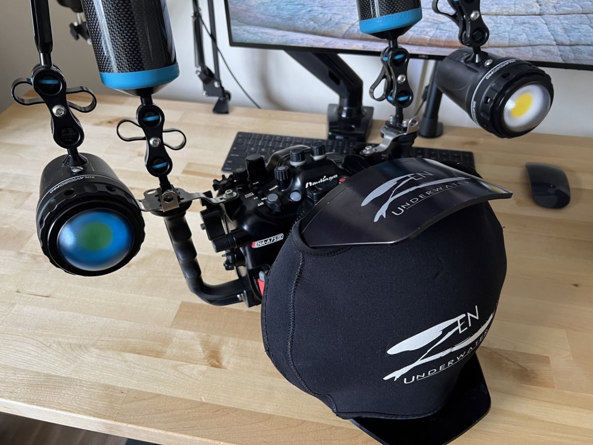

  18. I finally got my hands on the Keldan SF-6B and SF-12B blue water filters. Interesting results... (on the Canon R5 C in lightroom)
    • No Filter = 5150K, +21 Magenta, 0 stops light lost
    • Keldan SF-6B = 17000K, +146 Magenta,  about 1 and 2/3 stops light lost
    • Keldan SF-12B = 20000K, +144 Magenta, about 1 and 2/3 stops light lost
    Surprisingly, there wasn't a lot of difference between the SF-6B and SF-12B.. also, they were both less blue and more green than I expected.

    • Lee Full CTB + Rosco 4330 = 22000K + 75M about  1 and 1/3 stop light lost
    • Lee Full CTB + Rosco 4360 = 32000K + 99M about 1 and 1/2 stop light lost
    Seems it's rather hard to replicate the Keldan SF-6B filters exactly, at least with this combination of CTB and Cyan filters. You either end up overshooting the blue or undershooting the cyan. Maybe I should've bought some Lee 3/4 CTB filters to get a bit closer. I have a feeling that a Lee 3/4 CTB + Rosco 4390 Cyan filter would be pretty close.
    For now, I guess I'll test the Lee 1/2 CTB + Rosco + Rosco 4330 + Rosco 4390 and Lee 353 + Rosco 4330 out in the field.
