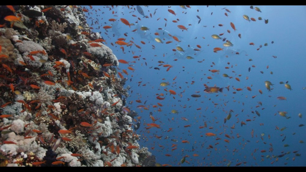

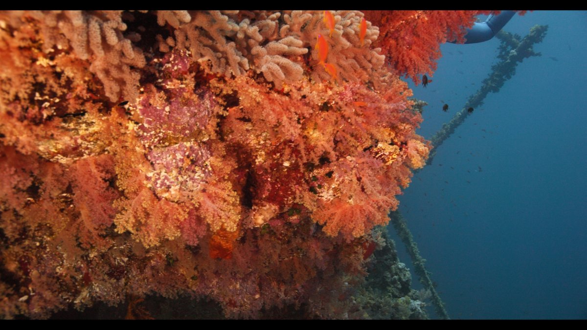

  1. Some real world feedback from last week in the Red Sea --
    I tested out both the
    • Lee 353 + Rosco 4330 = 23000k + 121 Magenta, about 1 stop light lost
    • Lee 1/2 CTB + Rosco 4330 + Rosco 4390 = 16000K +150M, about 1 and 2/3 stop lost
    At 5 meters with DivePro G18 lights. They blended it seamlessly with an ambient white balance at this depth, filling in the shadows:
    Just ambient light:
    + 2x DivePro G18 lights w/ Lee 1/2 CTB + Rosco 4330 + Rosco 4390
    + 2x DivePro G18 lights w/ Lee 353 + Rosco 4330
    + 4k DivePro G18 lights (2 with first filter combination, 2 with second filter combination)
    So as you can see both the filter options worked well, and they worked well together too. None produced weird results. However, given the stength of the ambient light, there's a noticable difference in ability to fill in shadows (look at the mask) when using 4x 18k lumen lights vs. just 2x.
    From this point on, I used the Lee 353 + Rosco 4330 combination on all 4 of my lights as I thought it did a slighly better job than the more cyan Lee 1/2 CTB + Rosco 4330 + Rosco 4390 filter combination in the conditions found in the Red Sea.

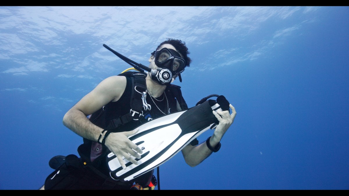

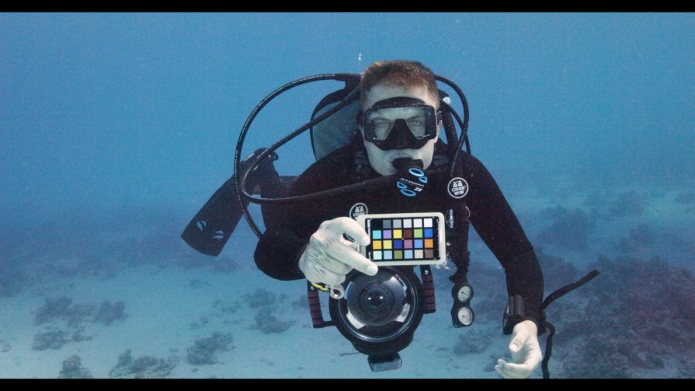

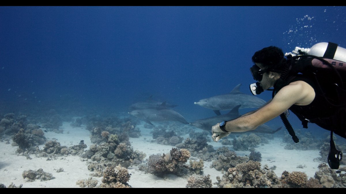

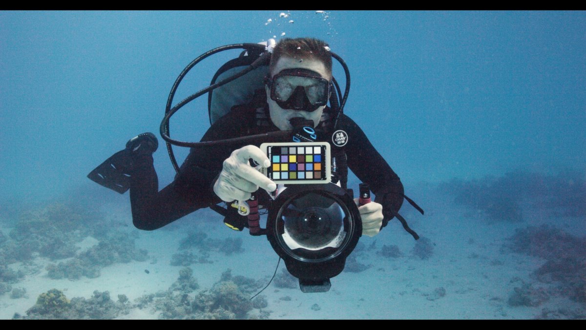

    I'm pleased to report that this filter combination produced great results all the way from 5m to 30m in depth. So, setting a white balance based on ambient light and filling in with the DivePro G18 lights + Lee 353 + Rosco 4330 filters on the lights produced very pleasing results in my view. Here's an example at 30 meters:

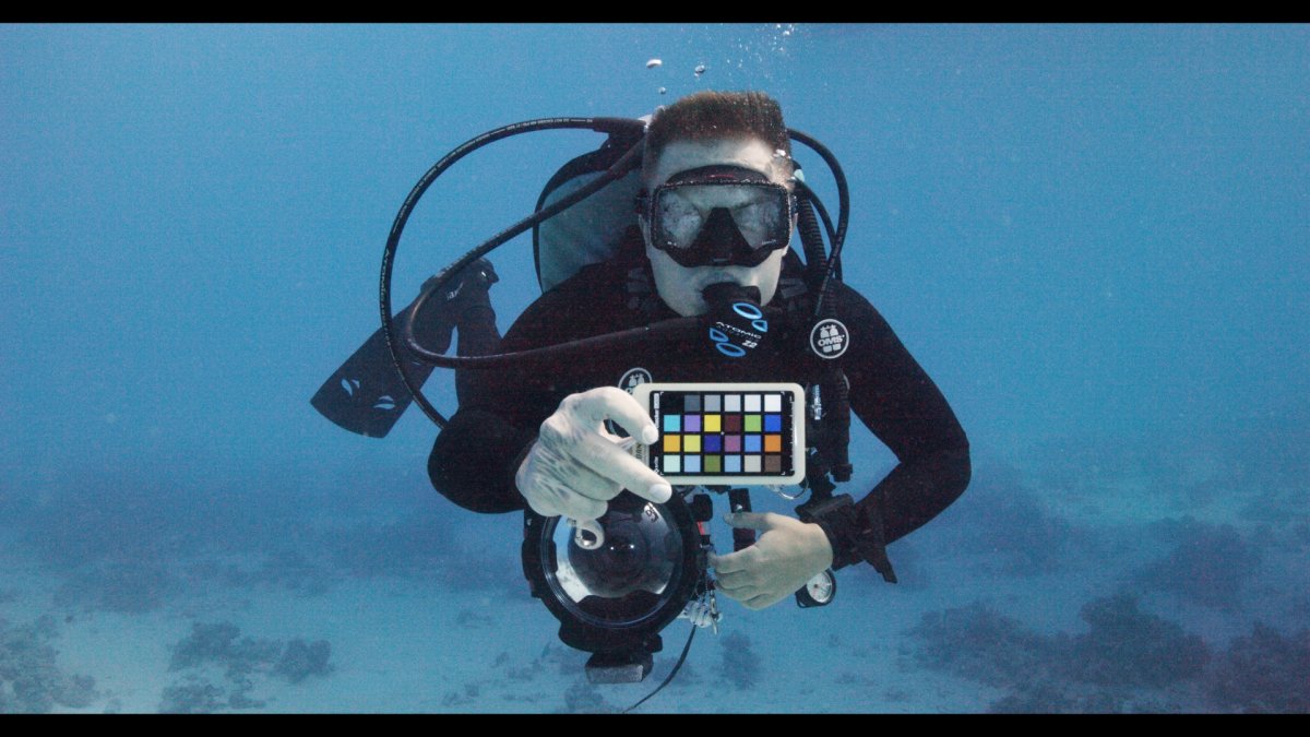

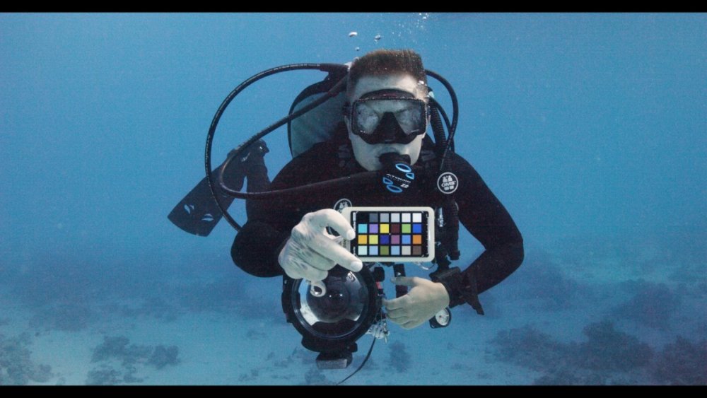

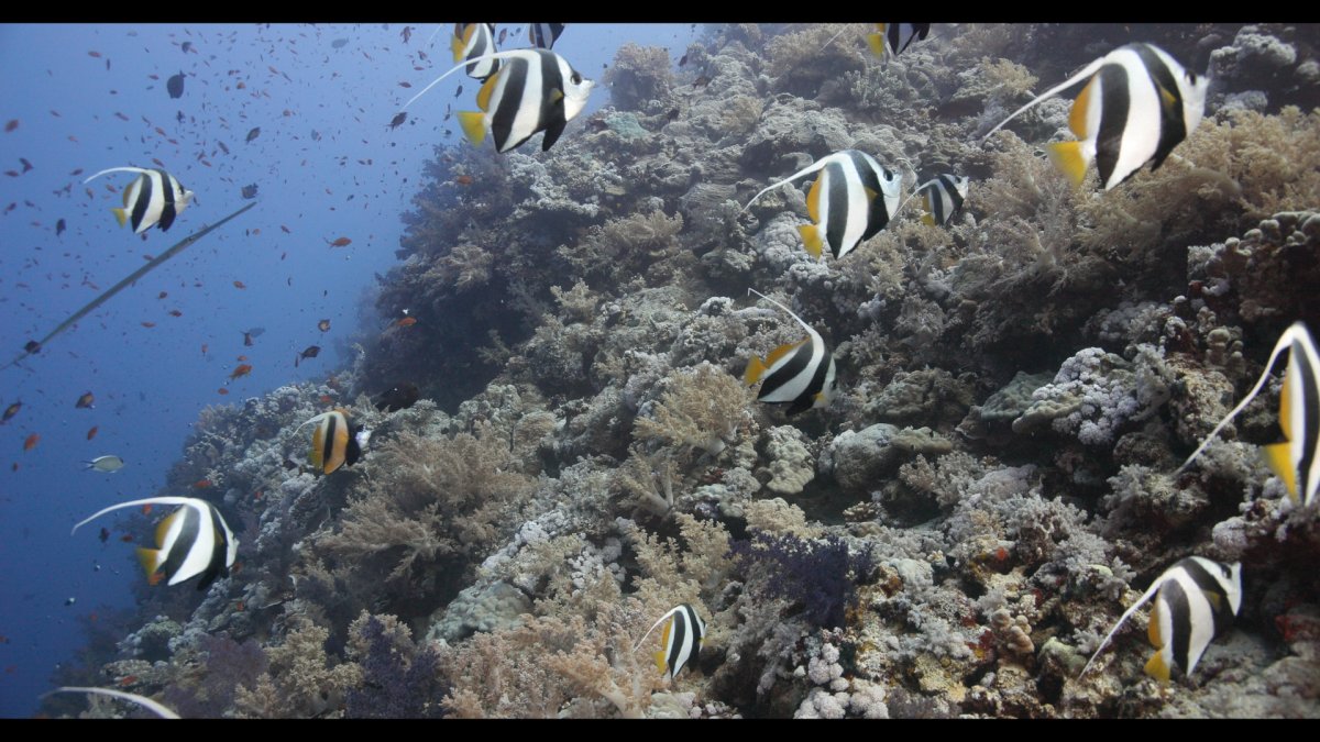

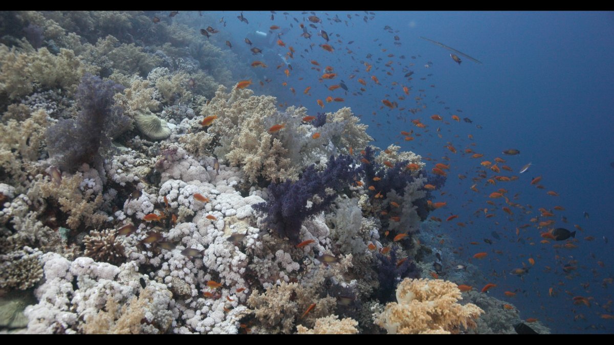

    And 20 meters:
    And 15 meters:

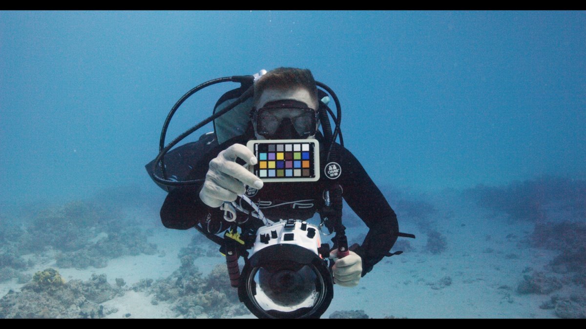

    And this is how it renders skin-tones at 20 meters. Pretty good, I think!
  2. Great job!
    The blues seem a little washed out. I assume the frame caps are ungraded?
  3. 1 minute ago, adamhanlon said:
    Great job!
    Yes, the first set of frame grabs at 5m are from R5 C raw video with Canon's offical Canon Log2-12(bit) to Wide DR lut applied.
    The second set at various depths is directly out of camera h.265, filmed in the EOS Standard picture profile.-

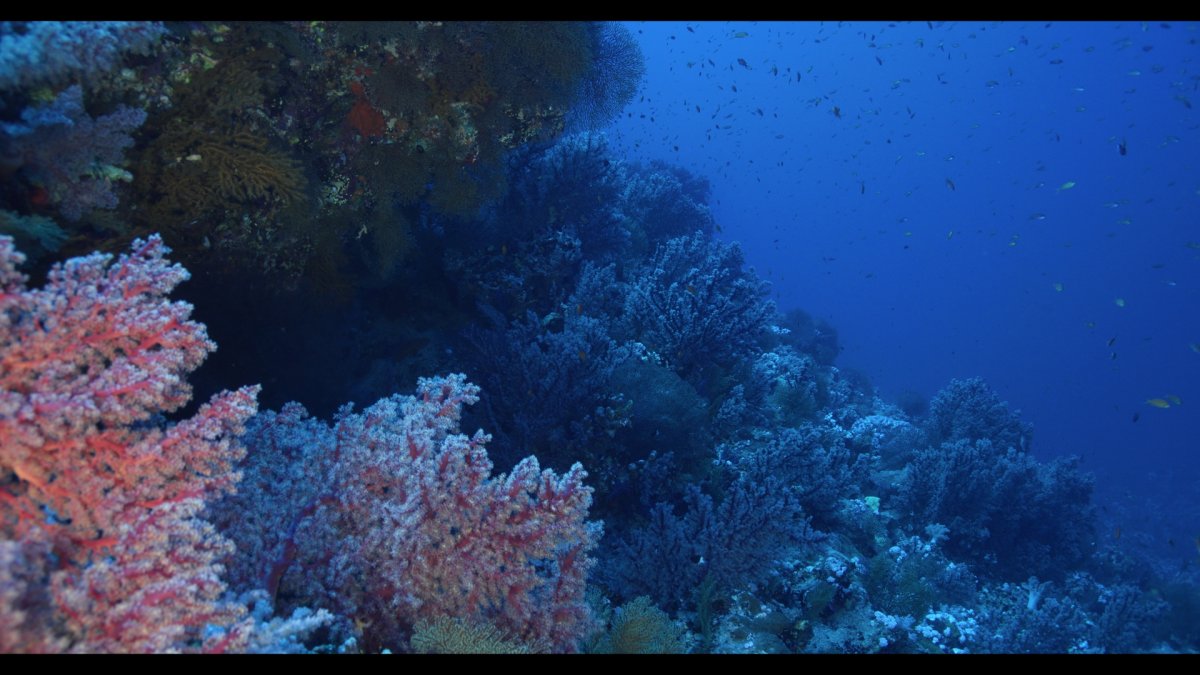

    A bit of color grading of the raw files can get you very nice results indeed at 10 meters:
    246795258_CanonR5CCWB_1.2.1.thumb.jpg.089b1be25778e7deaa68816461a84586.jpg1478836734_Skintones10M_1_22.1.thumb.jpg.488429dc889005b36b28a9d3fa90d955.jpg
