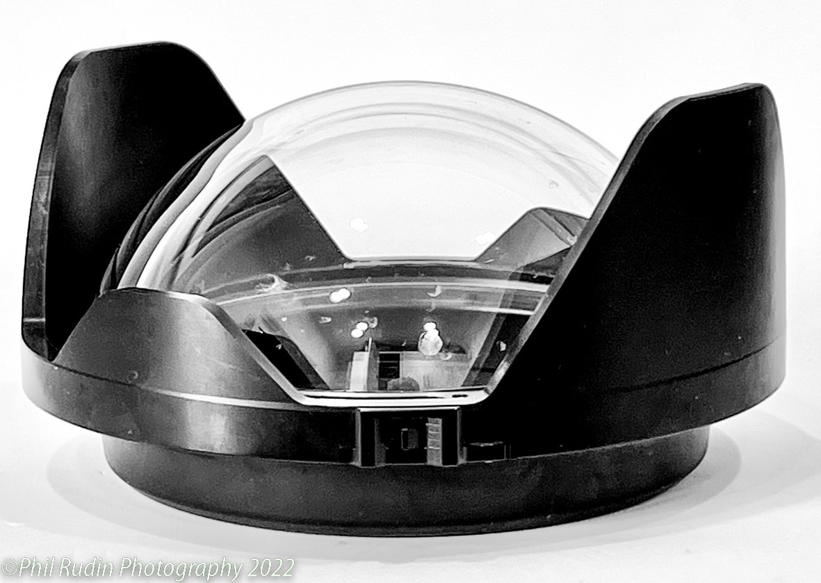

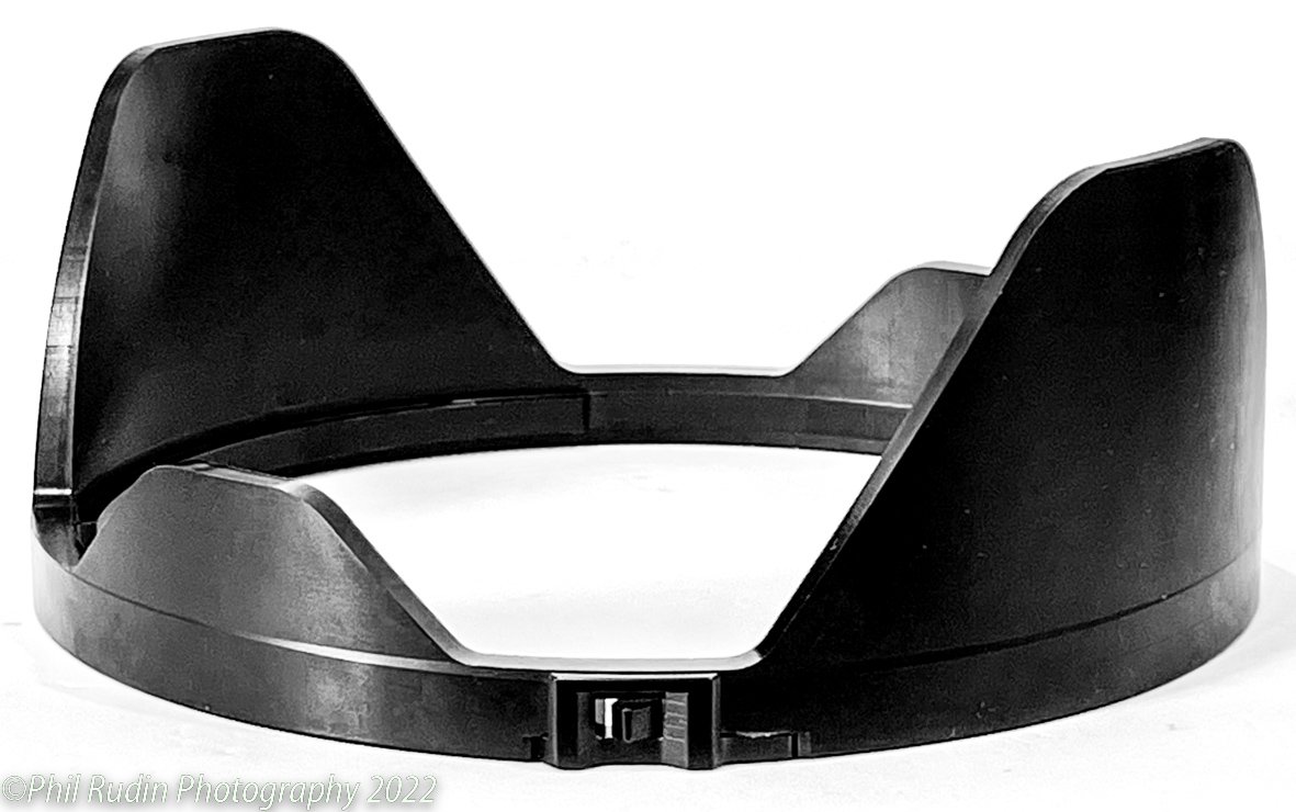

    As you have listed above to use the 8mm end of the lens you must remove the dome shade to prevent the vignetting. Marelux has the best solution I have used for this problem with the bayoneting dome shade. This shade can be easily removed and reinstalled underwater. I reviewed this port in uwpmag.com issue #128 which you can find in the back issues if you are interested.
    Edited by Phil Rudin

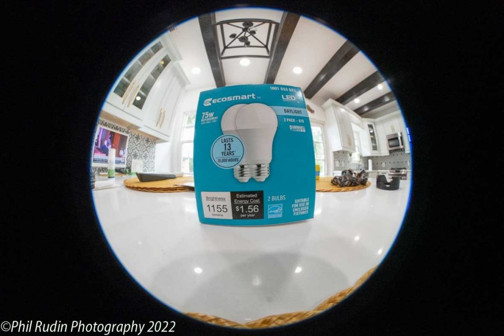

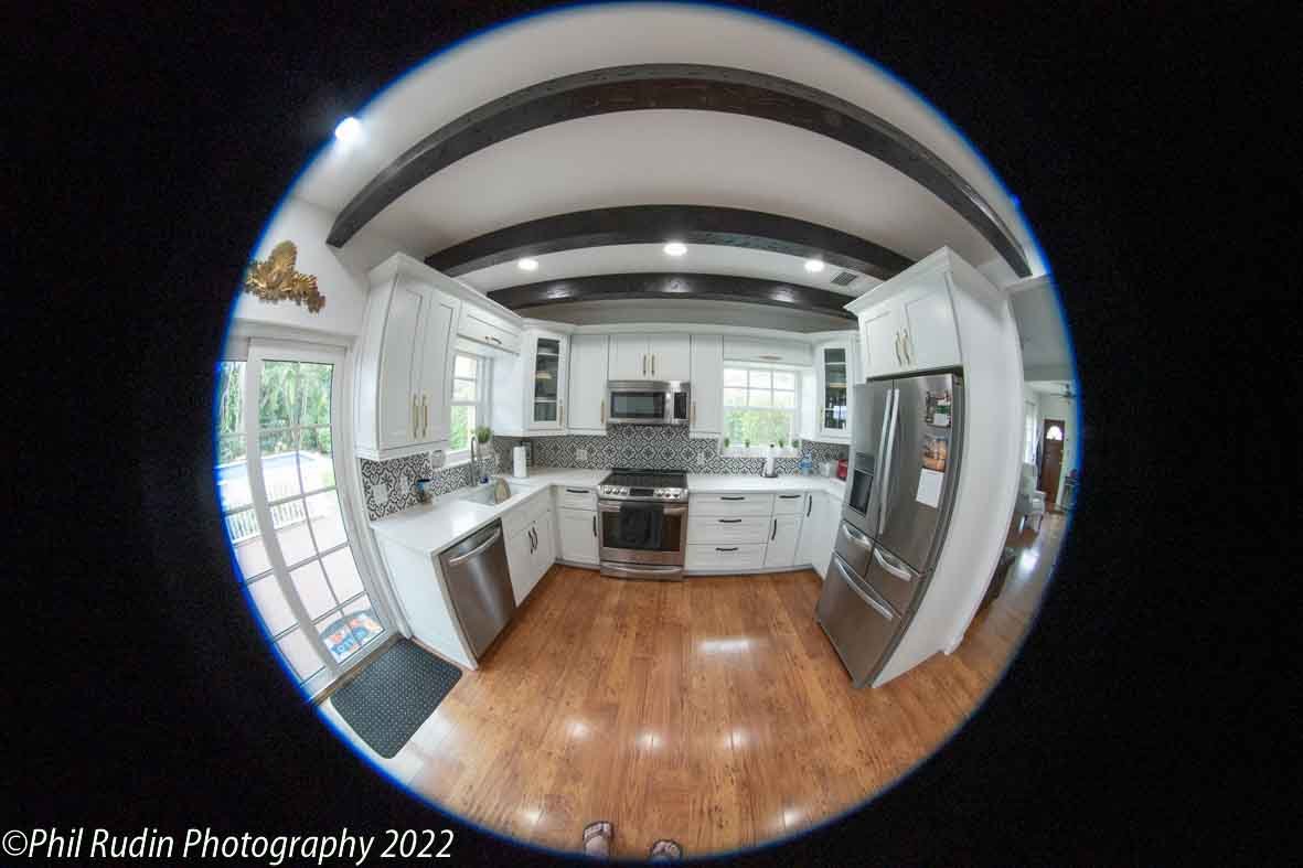

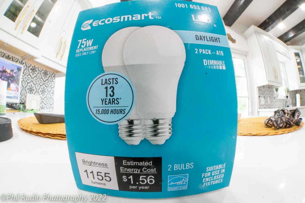

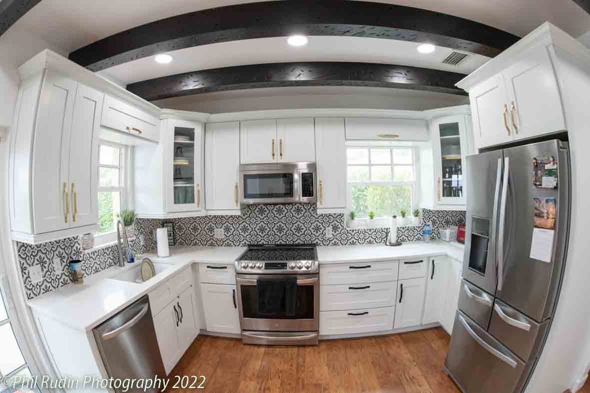

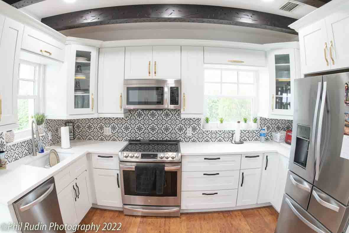

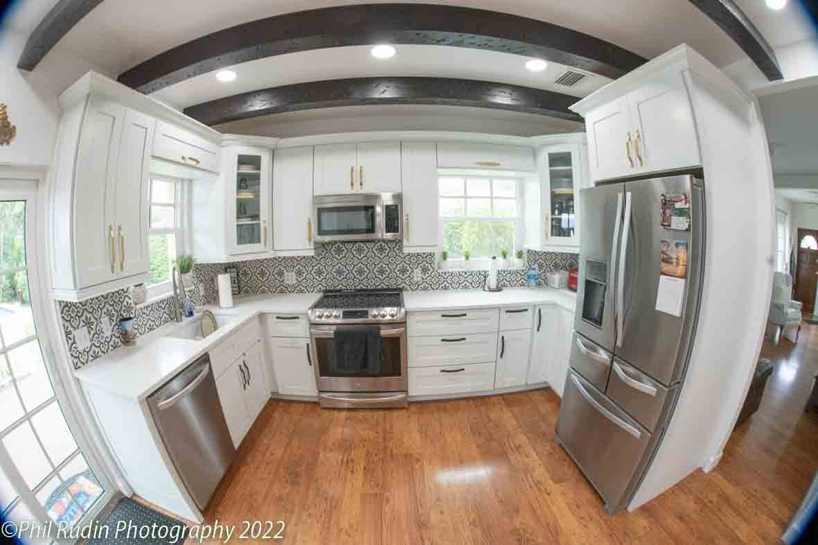

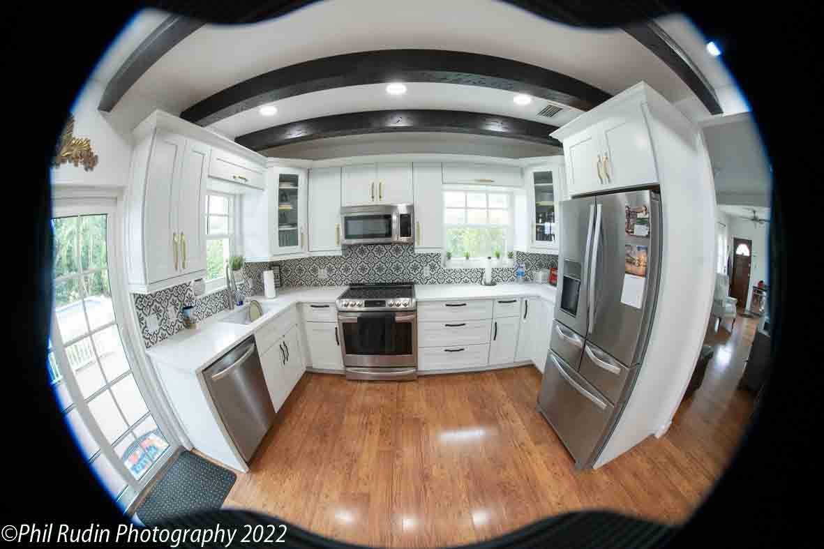

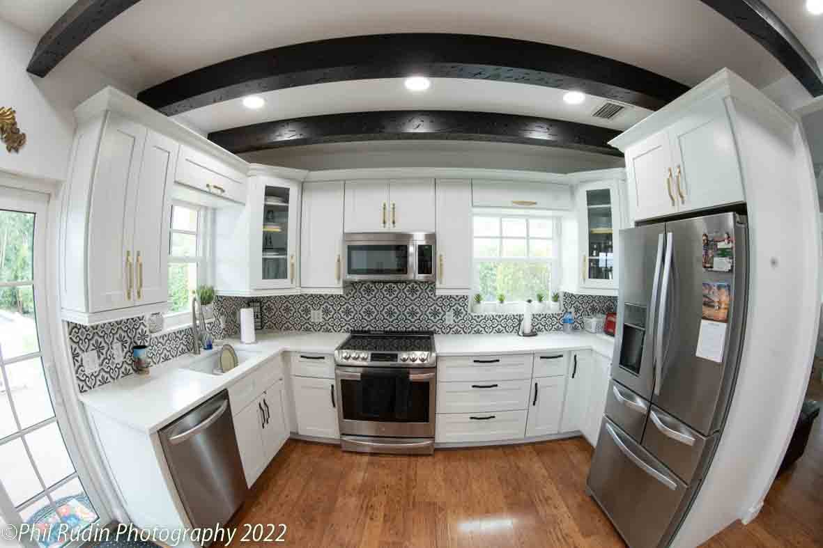

  11. I now have the KenKo 1.4X Teleconverter in house to try with the Canon 8-15mm full frame fisheye. The images are taken with the Sony A7R IV and are arranged as follows.
    #1-8mm without lens hood
    #2-At 15mm
    With the 1.4X teleconverter you get a zoom through range from 14mm to 21mm cropped. Without the Teleconverter you get 8mm circular and 14 to 15mm without vignette and/or top and bottom crop.
    #3-Tele set at 8mm with hood, notice the vignetting and clipping of the image at top and bottom.
    #4-Tele with crop 14mm.
    #5-Tele with crop 16mm
    #6-Tele with crop 21mm

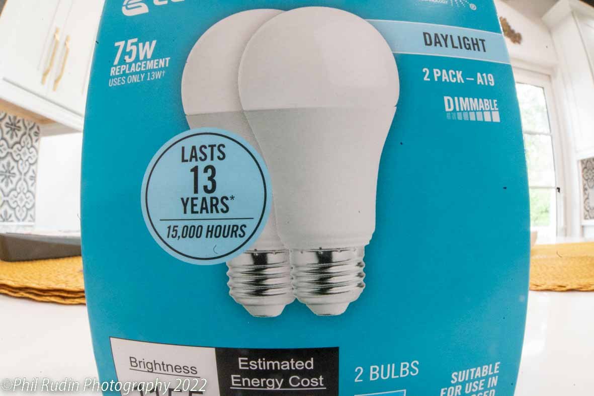

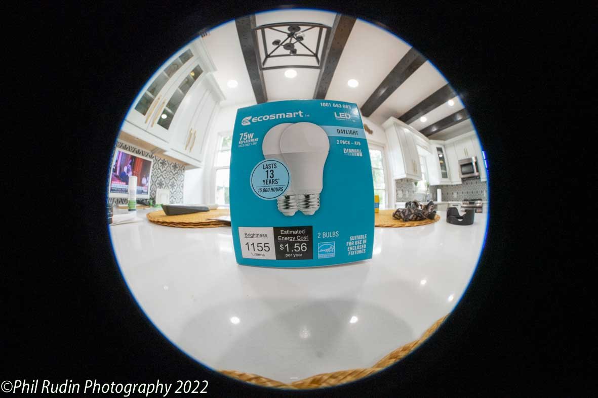

    Hi Larry,

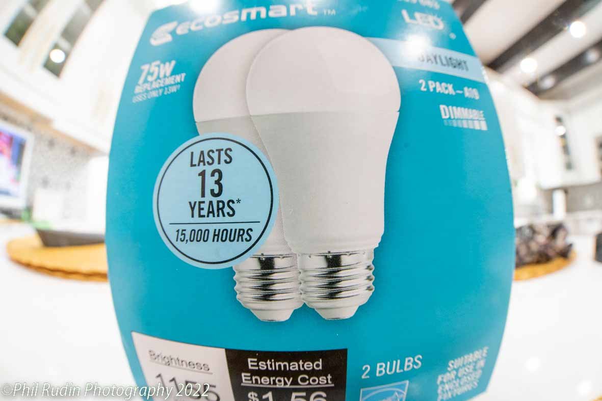

    I have attached photos with and without the KenKo 1.4X at the closest AF focus distance from the box. Photos without the KenKo are at F/8 and those with the KenKo are at F/32 just to compare the background differences. As always the circular shot has the blue cromatic aberration ring.
    #1 & 2 are the 8-15mm without the teleconverter at closest focus
    #3 & 4 are with the Teleconverter at closest AF first at the wide end of the lens and then at the 21mm end. With the teleconverter you will be touching the port glass or very near the port glass. Without the teleconverter you have a bit more room from the subject but not more than a few extra millimeters.
    Thank you Phil, these shots are great! You have certainly demonstrated the close focus (macro) capabilities. I am really looking forward to getting this setup in the water next week to experiment with it.

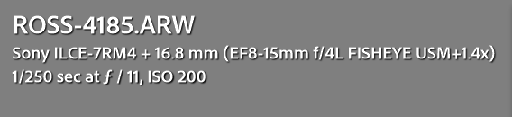

    Something I never got when I used the Kenko 1.4X/Canon 8-15 was complete EXIF data from the lens in use,  I got the aperture and focal length of the lens but these were not the equivalent values as modified by the teleconverter.  I also didn't get any data on telling me a teleconverter was being used..  With the Sony 1.4X I get equivalent focal length and aperture plus data on the comibination of lens and teleconverter used.  Here's a screen grab from LR:
