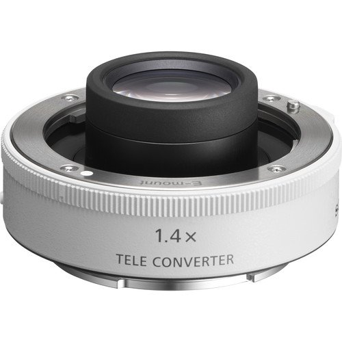

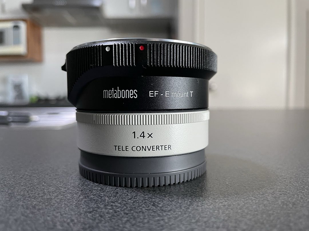

    The Sony 1.4X teleconverter has an interflange distance of 15mm (the Kenko is 19mm) and has a front lens element that protrudes 10mm in front of the lens mounting flange, similar to what is found on Canon and Nikon teleconverters.  This protuberance fits nicely inside the Metabones adapter.  This may not be the case for Canon and Nikon teleconverters.  I took my camera, Metabones adapter and Canon 8-15 to the camera shop to test that it all ftted and worked before purchasing the Sony 1.4X.
  2. 1 hour ago, Gudge said:
    Yes, works fine in air and underwater.

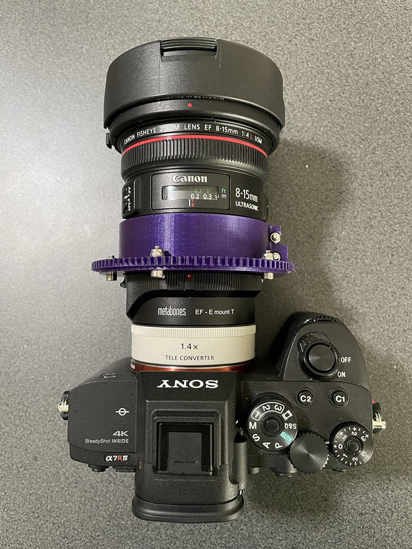

    If I understand correctly you have mounted the Sony FE 1.4X teleconverter to a Sony full frame camera, then the Metabones/Sigma lens adapter to the teleconverter and then the Canon 8-15 zoom to the lens adapter.
    I own the Sony FE 1.4X teleconverter for mirrorless FF cameras and both the Metabones type III I believe and the Sigma EF to FE MC-11  lens adapters. My teleconverter does not fit into either of the lens adapters. I did not attempt to force it in but I am curious how you got it to fit.

    I own a later model of the Metabones adapter - Canon EF Lens to Sony E Mount T Smart Adapter (Mark V).  The Sony 1.4X easily fits into it.  It would appear they increased the bore of the Metabones adapter in the latest model.
    Edited by Gudge — Added photos
