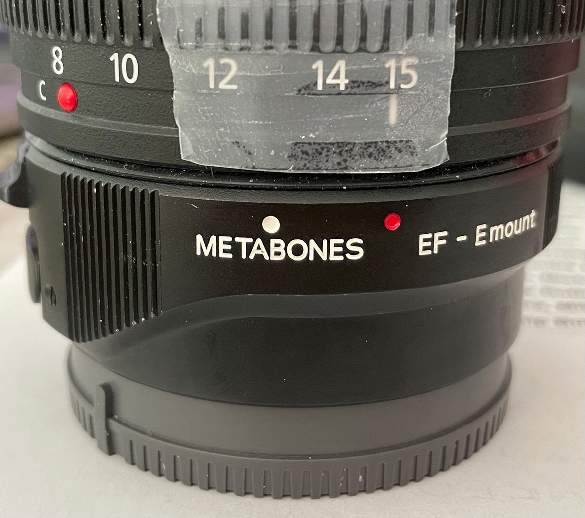

  11. 4 minutes ago, Alex_Mustard said:
    I have a Metabones adaptor. I have not tried others.
    I only have 3 lenses with the Sony A7RV I have here. The 28-60mm with the WWL/WACP definitely focuses much better than my reference Nikon 28-70mm with WACP on D850. The 90mm is much better at tracking fish than the Nikon 105mm. Although the 90mm is less impressive at smaller macro and looses its advantage over the 105mm/D850 combo.
    However, the 8-15mm Canon/Metabones does not focus as well as the Nikon 8-15mm on D850. When both are confident, they both snap onto the subject so instantly that there is not significant difference between them and no real point in commenting on the performance as even if one was better it would not really be worth commenting on. However, with strongly backlit, monochromatic, strange shaped subjects (as most wide angle foregrounds look to a camera underwater) the 8-15mm Canon will hunt at times. This is much more prevalent with a smaller dome port. The hunting is common enough for me to want to comment on. But while it has slowed me down shooting, I've not missed any shots. The best solution is to switch to back button/thumb focus (Focus With Shutter Off in Sony-speak) with this lens.
    So overall, I find the A7RV to be the best autofocusing underwater cameras I have used. It is logical to expect the A1 to be better. But it also clearly has areas of strength, and areas of weakness. The latter really a result of Sony's poor lens availability for underwater shooting, which hopefully will be redressed.
    Alex
    Alex
    When you attach the metabones there is a little led on the side of the converter. It can either have blue or red color
    What color is on your adapter? This can be configured and controls how focus works

  18. This could definitely be a factor, but I don't know the answer. The Metabones adaptor I am using does not have a LED on it. It has a red dot on it to help line up the lens - see picture.
    I would expect it to be a good one, as my friend who has lent it to me usually has all the best gear (hence why he has a A7RV and housing to lend). Tape is to stop the lens zooming to any of the useless focal lengths!
    The dot I mean shows when the adapter is on the camera and the camera is on
    It is either blue or red
  19. I am probably just being dumb. But I have it on the camera and I am taking photos, and I really can't see any LED on my adaptor. Can you find a picture of one online and share, so that I know what I am looking for.
  20. I am probably just being dumb. But I have it on the camera and I am taking photos, and I really can't see any LED on my adaptor. Can you find a picture of one online and share, so that I know what I am looking for.
    I think your adaptor is the Mark IV
    The dot is on the mark V
    I will post an image when I get back
    To give an idea metabones is at v70 firmware of the mark V things keep improving and the software plus the version of the adapter matter
    In addition the mark V has a green and advanced mode
    Some lenses like one some like the other
    The key difference is how af works and how many pdaf points are available plus other useful features such display of the focal length
    You are right that nailing down the best settings is essential
