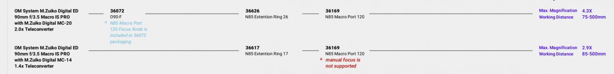

    Spoke to Nauticam and this are the exact words I got back:
    (...) dedicated 36169 N85 Macro Port 120 is going to support the macro switch function on the lens in combination with the focus gear (...)"
    Edit:
    Seems the latest port chart mentions extension ring 26 (instead of 30) now in case of teleconverter 20. Curiously it only mentions "focus knob" for the 120 port.
    Edit 2:
    4.3x magnification at 75mm working distance if going via the MC-20 route..now i wonder how that will actually work vs going CMC route.

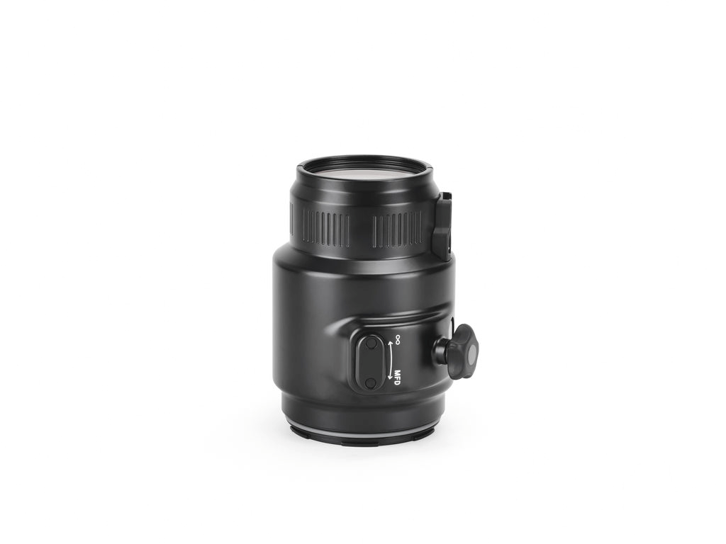

  15. Today Nauticam has update the N85 port chart with support for the new 90mm macro using the new macro port 120 with focus limit switch selector.  The new port is also compatible with tele converter 1.4X and 2X using extension rings.
  16. As Phil said, of course.  Here's a picture of the port:  image.thumb.png.a16ecb70ebbc5cd75e0bc5634740f2c4.png

    This is some fancy looking port I must say...
  18. Gotta give it to Nauticam. Where support for specialist lenses is concerned they are really the only game in town. The port isn’t even crazy expensive.
    That's for sure.  Especially given that the switch-equipped port for the 12-50 (with a zoom gear) is still almost $1k US.
