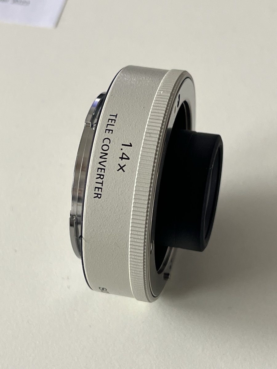

    The flange distance on the Sony 1.4X teleconverter is 17mm.  Ideally, you need a 17mm extension but with my Nauticam rig the extension rings only come in increments of 5mm.  I already had a 20mm extension ring so I tried that and was happy with the results and decided that it wasn;t worth spending a bunch of dollars on a 15mm extension ring to see if that was any better.

  15. The flange distance on the Sony 1.4X teleconverter is 17mm.  Ideally, you need a 17mm extension but with my Nauticam rig the extension rings only come in increments of 5mm.  I already had a 20mm extension ring so I tried that and was happy with the results and decided that it wasn;t worth spending a bunch of dollars on a 15mm extension ring to see if that was any better.
    If you have the TC already you can try but the entrance pupil is now going back 3mm and the gear is off 2mm
    The kenko teleconverter is designed for the canon ef mount so it is flush to the metabones
    The metabones itself is 26mm while the sony tc protrudes 16.6mm so the tc won’t go right on the back of the lens the converter may act as a mix of extension tube and teleconverter and non longer focus at infinity
    This is not an issue inside the dome provides the lens can still focus at the virtual image infinity point

  16. You all are aware that the Sony-TC does not fit to all lenses because it protrudes far into the lens...?
    According to the report of Grudge the extension should not be a problem, as the TC extents into the Metabones adapter. The sequence of elements is different between using Sony and Kenko TCs: #1 Canon-EF lens/Kenko 1.4xTC (EF mount)/Metabones adapter/Camera. #2.: Canon-EF lens/Metabones adapter/Sony 1.4xTC (Sony FE mount)/Camera...
    => From the principle, both converters should work perfect, as the Kenko is designed to work at the end of a lens with Canon-EF mount flange distance (hence the Kenko is mounted directly to the lens) and the Sony TC is designed to work at the end of a lens with Sony-FE flange distance (that is restored by mounting the adapter between lens and TC)...
    => In practice one must say that both TC have been designed to work together with specific tele lenses and the optical performance together with the Canon 8-15mm fisheye may well be different. A TC mounted to a fisheye lens is rather a "misuse" of the TC and a comparison of optical performance between the two TCs would be very interesting...
    Wolfgang
    Hi Wolfgang,
    thank you, I was not aware that it is possible to mount the TC direct to the camera, then the metabones, then the lens.
    I am using the adapter with my 200-600 but to be honest, the result is not massively better than the crop. On the A7RV or the A1 the need for TC would even be further reduced.
    OK, a little improvement is provided by the TC
