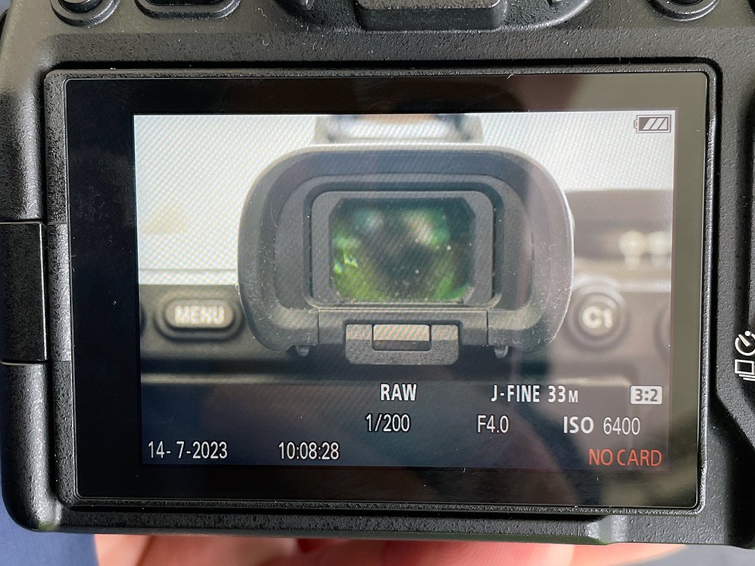

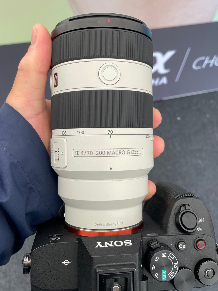

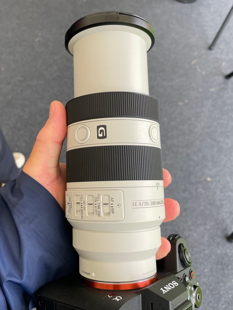

  9. I had a go with the lens today. It is smaller than it looks in photos which is nice. The macro capability is impressive too, both at 70 and at 200mm.
    This photo shows magnification at minimum focus of a subject of known size (a Sony viewfinder). The lens achieved almost identical subject magnification at both ends of the range:
    The lens is pretty small, smaller than I expected from the photos of it, but it does extend a long way when zooming. I think that the lens would be pretty useable at 70mm underwater. Perhaps this might be its best function - take it as a topside lens and use it as a 70mm macro (one capable of going down to 1:2 magnification) underwater. Zooming it underwater I think would be troublesome given how much it expands.

    Do you think it will vignette at 70mm when in a port long enough to allow full extention at 200mm or are you simply reluctant to dive with such a long 'bazooka' port?
    I'm a m43 shooter so this lens doesn't apply to me but for shy smaller fish it would be nice to have the 200mm so you can keep a bit of distance. Starting at 70mm and then zooming in may also make it easier to find your subject.

    I think with a very large diameter port it would be OK. But I think it would see the sides of quite a few ports with such a large extension.
