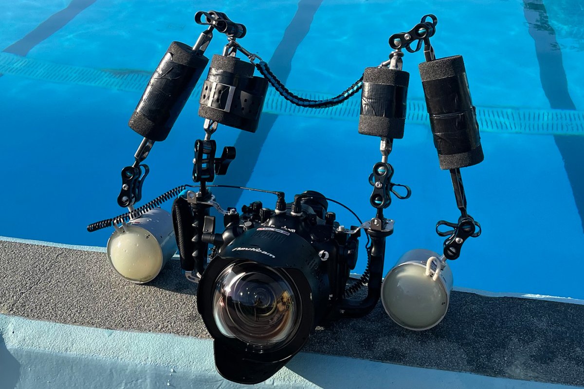

    So is the N100 version a direct mount to the housing or is an N100 extension required?
    Yes, it did have a short custom N100 extension (that I could take off). I didn't measure it, but it is small, smaller than any of the rings I had previously (less than an inch). But I also don't know if the FCP I am testing is a one-off prototype and it actually may be different to the Nauticam USA one.
    I know there was some confusion after I shared info about the WWL-Dry lens - the WACP-C prototype - in relation to the WACP-C. So I think it is best that we avoid setup specifics for now so it doesn't confuse matters in the future. I am using the 28-60mm at the moment, but the production version may favour a different lens.
    What i can say is that I am already totally happy to use this setup as my main lens in the Red Sea. And Nauticam have a way to make it even better - which makes me very excited for the actual FCP.

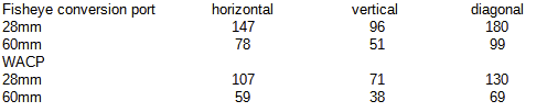

    It depends on how important being able to zoom is to you.   I played around trying to fit the WACP figures Nauticam supplies to a fisheye projection and it appears like it might be a combination of a rectilinear and fisheye style projections.  If you assume the FCP has similar characteristics and a maximum field of view of 180° diagonal then you can estimate fields of view and I've done that:
    This is an estimate of the field of view range compared to what you get with the WACP.  There is some overlap so you could work out how often you use the WACP zoomed in beyond a 99 deg diagonal, or zoomed in more than 45mm on the lens or so.  These figures are of course educated guesses and might be up to about 10° out, depending on the projection that the FCP uses.

    The horizontal fov of the fisheye is 2.1x wider from that picture Alex posted
    Assuming the other lens fov is correct that would give an  horizontal of 140 degreesand diagonal of 174 degrees.
    This is just a tad narrower than the theoretical fov of the canon 8-15The equation does not work very well at the extremes and is not exact
    However I doubt very much that the fov of the WWL-1 is 130 degrees diagonal 106 horizontal

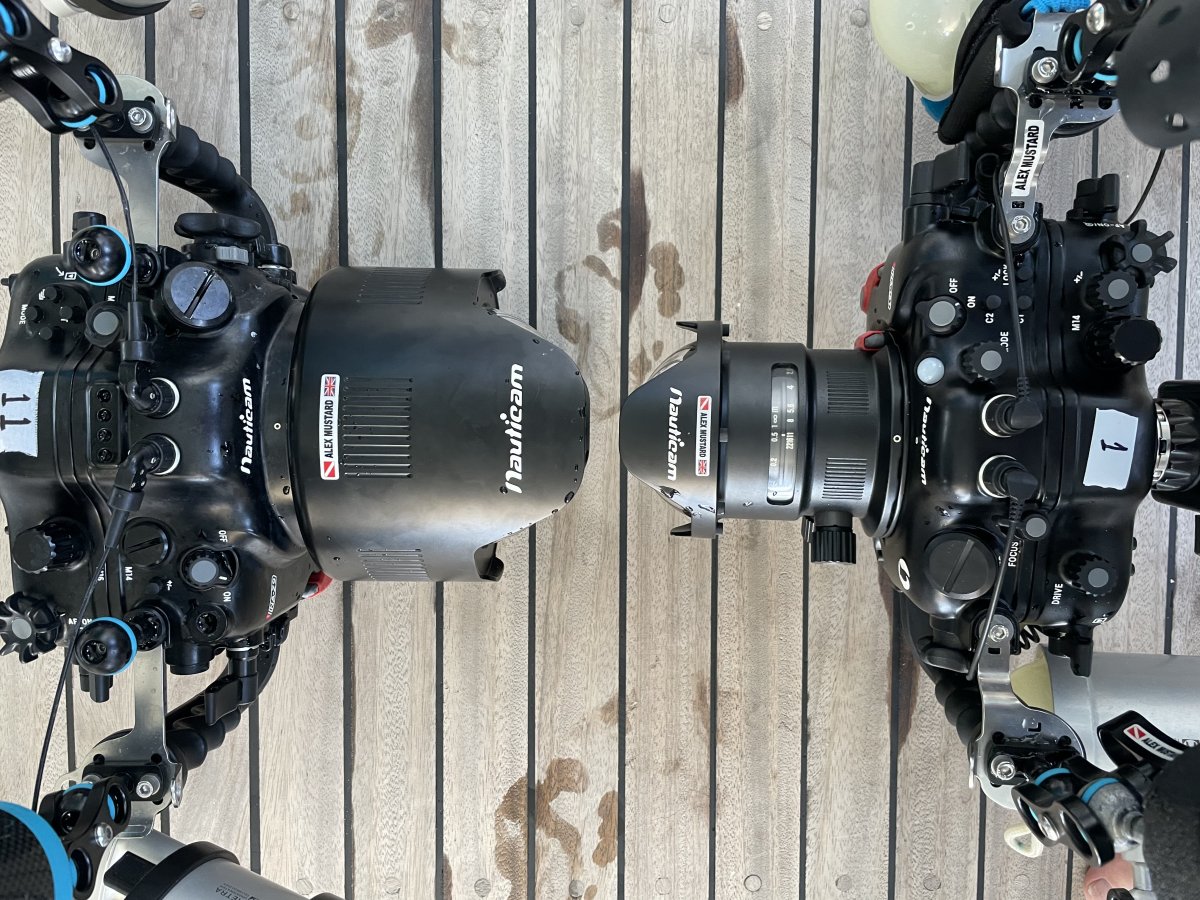

    The one of the left doesn't look like the WACP (is that the FCP)? And the one on the right might be a Nikonos 13mm fitted for the Nauticam housing, but it still looks a bit different.
    The port on the left is the FCP attached to a Nikon Z9.
    On the right is an UW 13mm mechanical fisheye lens built by Nauticam a few years ago. It works really well, and the manual focus is easy enough.
