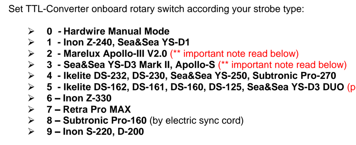

I've got an old D-2000 that isn't supported by either of the strobe triggers I have.....but I was wondering about the S-TTL function from Inon.
I think it just copies the "camera" - so should any trigger theoretically be able to do TTL with that strobe, if it just repeats the trigger LED "pattern" for the pre flash then TTL flash duration?
I'm not sure how to test it fully with the triggers (I have UWT and Turtle), with all the different options they have - but I used a TTL land strobe (godox 860ii) as a trigger for the inon and that seemed to expose correctly, but when I've tried the UWT on the Z-240, Z-330 and S-220/D-200 modes it doesn't seem to be quite right.
Is there any kind of idiots guide to testing TTL on land with an underwater strobe to see if I could use that old strobe on my next dive? 😁
I just returned from a trip and it made me realise I have no idea how to use the strobes in manual as I've only used the pop up flash and S-TTL mode before....which isn't an option now I don't have a pop up flash on my new camy, and I've now got the MF-2 that don't do TTL for Sony, regardless of trigger type.
Came back with lots of terrible shots, and I'm assuming it's mostly the strobe side of things that let me down, although I'm not that good with full manual either if I'm being honest so it's also very possibly a combination of both.
I use the S2000 position for TTL with either Inon D2000 or Inon S220. Works fine. I am shooting with a Sony A6400. There are occasional and annoying fail to sync with every type of strobe I have been able to get my hands on with my UWT trigger.
You should be able to run full manual with the #0 position set on the UWT board and Inon in M and set for no pre-flash. Or TTL with the Inon set for sTTL and the UWT set on #2 (?) position. You will need to configure a WL command selection and play with that setting on a programable button.
You have the instruction sheet for your UWT trigger? It is detailed in the instructions how to set up. Yes Inon strobes will work with the UWT trigger in manual or TTL modes on the UWT board.
The 0 manual position on the UWT board does not fire a pre-flash so your Inon will be set for manual and no pre-flash.
The #2 TTL position does fire a pre-flash and sTTL on the strobe selection always assumes a pre-flash from the camera as that is how sTTL works.

Thanks nemrod!
The manual for the trigger does list a few inon strobes, but not the D-2000 - I just thought with the S-TTL sounding almost universal, it might work on one of the others. Maybe the 220 setting is worth a shot!

Sorry, I forgot to mention that! It's the Sony A7RV.
Thanks for the test ideas - I'll give some of those a try and see if I can figure out manual strobe, it seems like most people end up using that anyway 🙂
I don't have the magnet for the strobe (second hand, didn't come with it) so I'll try and figure out TTL for that strobe as an option, but ultimately the MF-2's are probably what I want to be using......the D-2000 in TTL was my "trying to be lazy" alternative! I realise it's also pretty half as old as me so I'm not surprised things aren't designed to work with it nowadays 😁
For the MF-2, in case it's useful for anyone - the Retra Pro Max setting looks to work for the HSS feature
