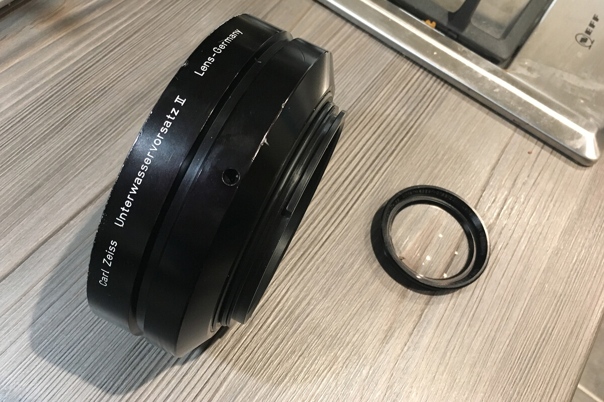

  12. The Zeiss one is definitely more complicated. The front (main) part is not simply plano-concave. But it two elements sandwiched together, with the outer element being slightly convex. Also the internal lens is not a simple positive lens - but matched to the outer lens. Worried about loosing this lens, we measured its strength and made a simple replacement matched to the same strength, which didn't work anywhere near as well (showing there is something more in the design). I know that I shared a lot of stuff about it on Wetpixel at the time. That Tom also contributed to. Search Ivanoff on Wetpixel forums - e.g. https://wetpixel.com/forums/index.php?/topic/54681-full-frame-slr-wide-angle-corrector-port-tests/&tab=comments#comment-356001

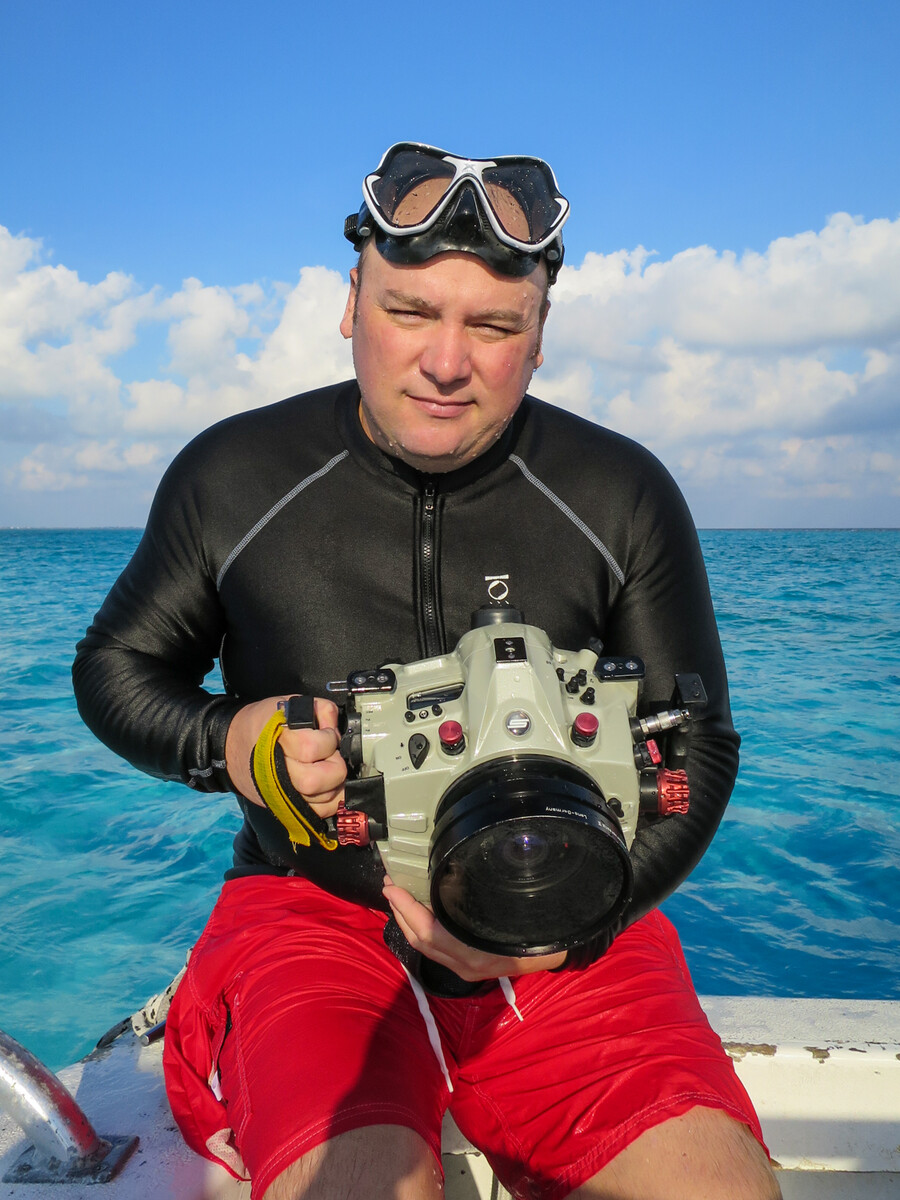

  13. That photo shows my camera before a blackwater dive, but the strobes are not in their shooting position - they are in their carry to the boat position! I generally shoot BW with the strobes pushed out wider than this, just in front of the port (as shown) and aimed in at around 45 degrees (again pretty much as shown). Ideally translucent subjects show up best with the light coming through them from behind, whereas more solid subjects show up better with more front lighting. This position is a good compromise for both (as a starting point). When shooting the MFO-3 as a main lens on BW, yes, I would have the strobes a little further forward still. Hope this helps,
  14. Here is a photo of my port and internal lens (not attached to housing or lens): When searching my phone for the word Zeiss (to find the picture) this one came up of another one of the shots from it in print: And here are a couple more from my website that I didn’t share previously: In the UK, the older guys who used these in the 1960s and 1970s always called them Ivanoffs. I suspect that this was because they didn’t like Rebikoff personally, probably because of his commercialisation of the idea! That’s why I always call it an Ivanoff or simply a Corrector Port - as I was taught about it from these guys. My setup works very well. And I have faith in this idea for people or manufacturers to develop. It definitely has a corner sharpness advantage over a dome at more open apertures. But once you get to f/13 or more closed down - I think it performs very similarly to a dome. I was always slightly frustrated that I could not get my 16-35mm @ 16mm to perform as well as the 20mm did - it would go blurrier towards the corners. I haven’t adapted the Corrector to my Mirrorless camera (yet). This is partly because I use the Nikonos 15mm (a 20mm equivalent) with my Sony - which kind of does the same job (and is more travel friendly). And this is partly because I don’t have many Sony wide angles of my own to test - and don’t want to spend money buying lenses that I am not sure will work. Added to this, I would never shoot rectilinear as my main wide angle underwater - I just find the look of the images too low impact for my taste. I much prefer barrel distortion (fisheye distortion) compared to rectilinear for underwater shooting - so would always choose a WACP or WWL over a 16-35mm or similar for shots in this FoV range. Which means spending money on this solution is hard to justify.
