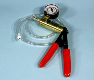

  11. I've used an automobile brake bleeding kit like this one mated to the lens port (using a piece of machined aluminum with an o-ring groove and an NPT thread for a nipple to attach to the vacuum hose) to check that my housing holds a vacuum before installing a lens & port and going underwater. I usually pump the housing down to 15 inches of mercury (about 7.5 psi or 0.5 bar or 50 kPa) of vacuum, then let it sit for a minute and see if the needle moves on the vacuum gauge. The only time I had a problem was with an o-ring installed sideways on a control rod I had just worked on, and that leak took about 10 or 15 seconds to go from 15 inches of Hg to zero.
    As for using vacuum instead of latches, that might work, but I would worry about telling the difference between a leaky housing held shut by o-ring friction and a housing held shut by vacuum.

  13. I'm unable to post the link to the following product parts, since it would lead to an adult sexual aid website. But, these vacuum parts are used on cylindrical lexan tubes for vacuum on certain body parts (use your imagination here...LOL). With some modification they should allow to draw a vacuum inside a housing and keep it till you are finished ;)
    The two connectors can be disengaged after drawing vacuum and together with the handpump are less than $100. The electric AC-powered pump is $400.
    These look like the low pressure connections used on medical equipment: designed for about 0.5 bar pressure differential. They are only sealed when connected: if the pump is removed, air enters the chamber. It is surprisingly difficult to achieve anything like a 1 bar negative pressure gradient with a vacuum pump on the surface. Even deep-water equipment is usually designed with latches or bolts: they get you through the first few metres, after which ambient pressure provides the seal. Historically, most leaks occur at or near the surface. The extra security provided by a 1 bar pressure gradient isn't that significant, so negative pressure is more a way of testing for leaks rather than locking the housing. The best way of testing for leaks is to submerge the housing...
    The engineering of a negative pressure system would seem to offer far more failure modes than simple latches, so why worry? Just because the pneumatic tyre is old it doesn't suggest (to me, at least) that we should move to hovercraft or maglev vehicles!

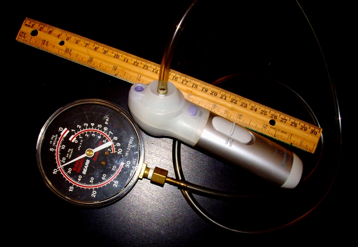

    We haven't been able to locate a good, cheep, small, battery operated vacuum pump yet and have been looking at a few manual pumps. The small hand pump requires about 50 pumps to pull 10" of vacuum on a housing. We are looking at and testing other manual pumps. What are your thoughts on the KISS (Keep It Simple Stupid) idea of a manual pump? Please share any ideas on a battery operated pump that you may have.

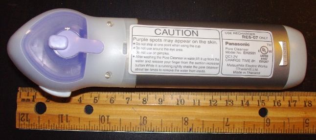

  18. We haven't been able to locate a good, cheep, small, battery operated vacuum pump yet and have been looking at a few manual pumps. The small hand pump requires about 50 pumps to pull 10" of vacuum on a housing. We are looking at and testing other manual pumps. What are your thoughts on the KISS (Keep It Simple Stupid) idea of a manual pump? Please share any ideas on a battery operated pump that you may have.
    My girlfriend has this Panasonic Pore Cleanser Model #EH2501 in her junk box. It draws 10 inch Hg/ 25cm Hg. It is a NiCad rechargable system that needs 8Hrs to recharge. I will ask her if I can rip it apart for you guys to see inside :wacko: . She recalls it cost was around $40.
    Edited by fotoscubo714
  19. Kinda cool I just don't know if it would be worth the weight and hassle of electric on a trip over a manual unit? Guess ideal situation would be really small light weight. compact and run off of 4 or less AA batteries.
