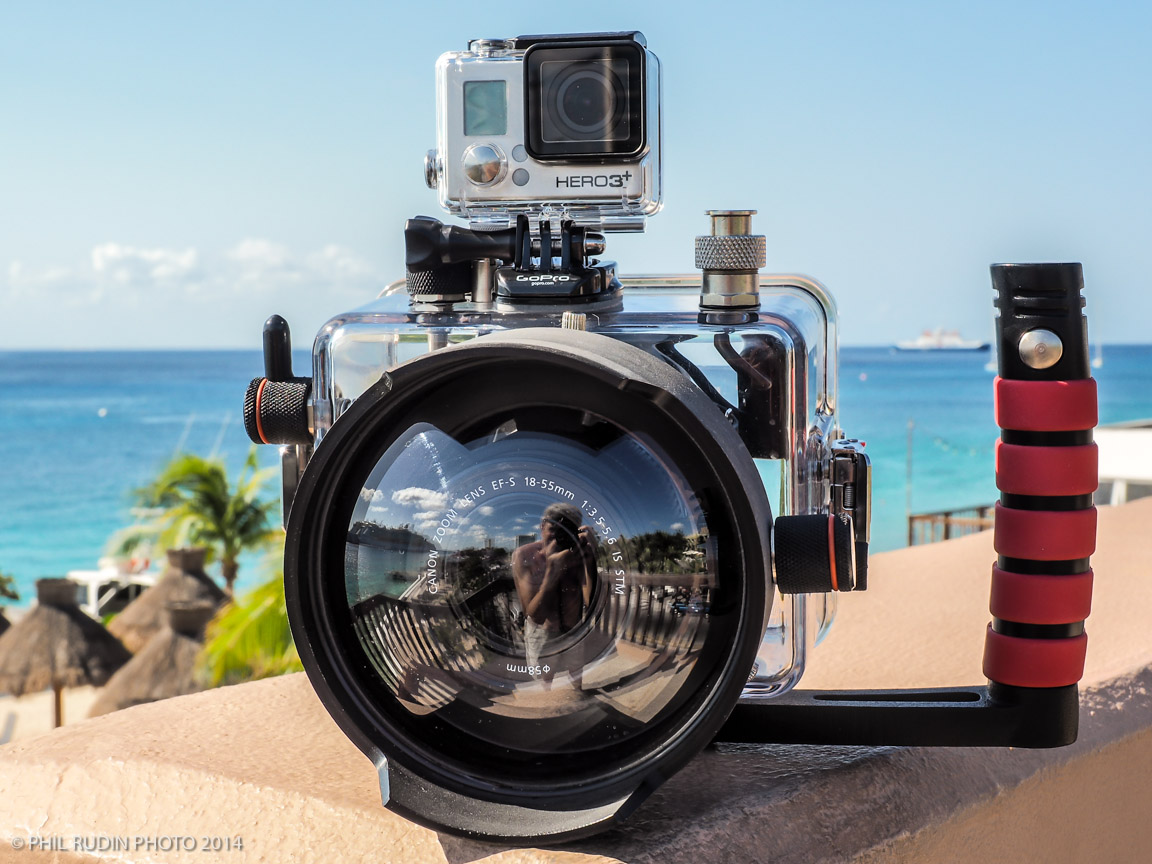

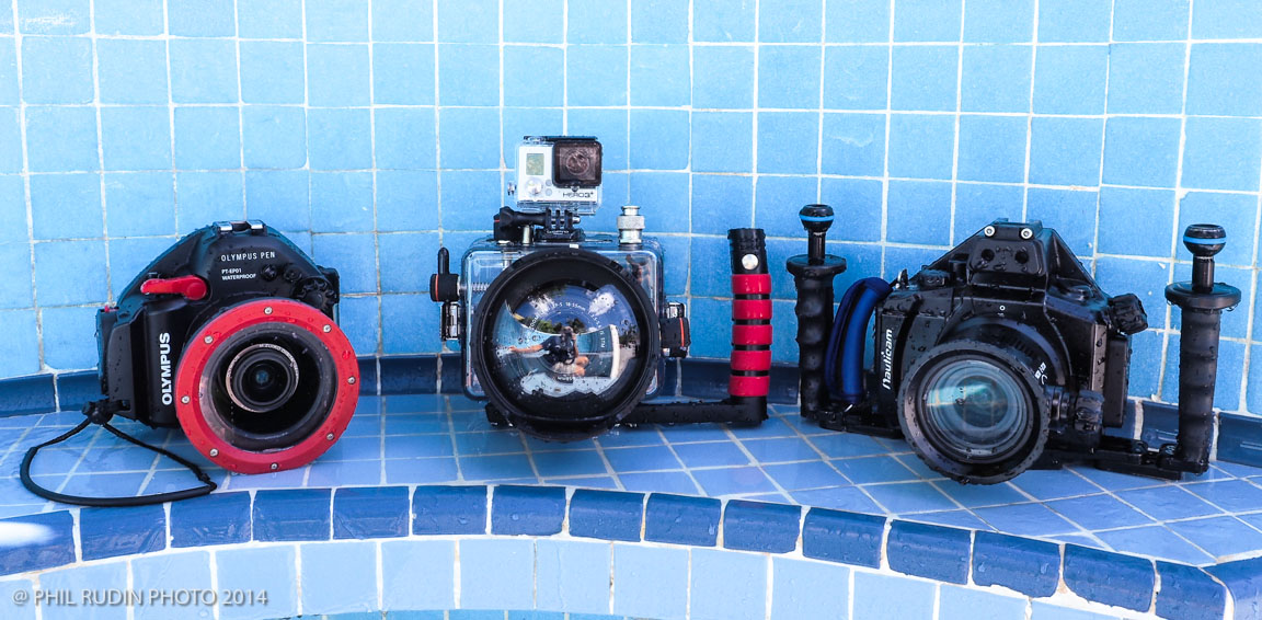

  12. We have this system with an Ikelite strobe and kit lens at Underwater Digital Fiesta this week. We have had nothing but positive comments from all of the students that have used the system. The only negative comments are regarding the small size of the cameras optical viewfinder a common issue with DSLR's in this size range and sensor size. I will be reviewing the system this week and I already think it is an excellent teaching tool. The Ikelite housing comes with a nifty Go Pro mounting point on top of the housing, Go Pro not included.
    I have attached a photo V. two mirrorless systems to show how small the system is for a DSLR. Olympus housing with PEN camera and Nauticam housing with Olympus EM-5.

  15. Thank you for this feedback ! The stock port is meant to be used with
    the Tokina 10-17mm also (with vignetting).
    This housing comes standard with a optical grade acrylic dome port with zoom ring. This port provides sharp images and zoom capabilities with both the Canon EF-S 18-55mm STM kit lens, plus the popular Tokina 10-17mm lens.
