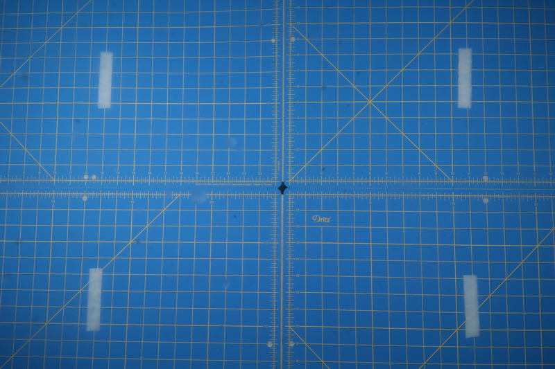

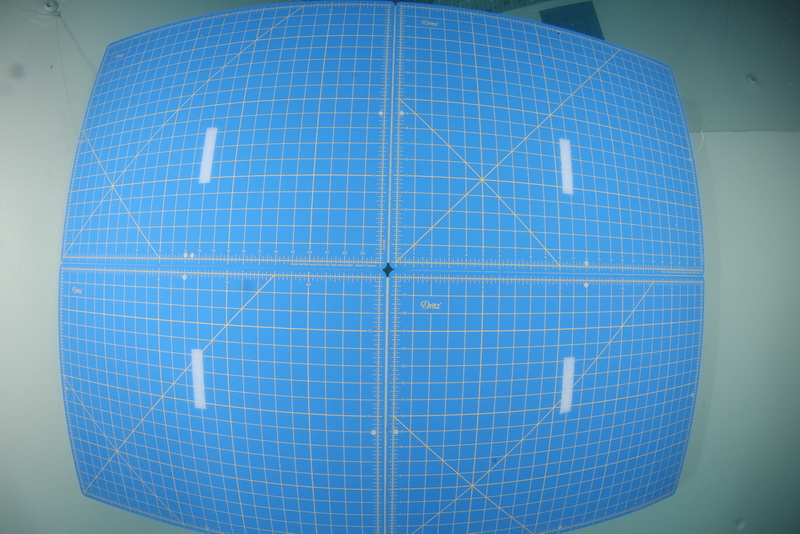

  7. Below are two pictures taken with the ikelite housing and ikelite dome. The first picture is taken with the Tokina 10-17 lens and the second one is taken with the Canon 10-18 dome. Both pictures were taken from the same location, tripod with 18" between the front of the dome and the subject. I have full size images but i loaded these into the editor and re-sized them only.
    Edited by blibecap
  8. Thank you for these pictures ! What is the used focal length for the 10-18mm ?
    It would be nice if you could show us both lenses at both end of the focal range.
    So, no vignetting and proper focusing for the 10-18 ?
    Edited by FanchGadjo
  9. I don't understand your question "What is the used focal lens for the 10-18mm ?" can you please explain?
    Why would you want to see images ate the zoomed in setting?
    These test pictures are taken at 10mm f/14 iso 200
    Bill
    Thank you for these pictures ! What is the used focal lens for the 10-18mm ?
    Edited by blibecap
  10. Was the lens at 10 or 17, 10 or 18mm when the photo was taken is what I think he is asking.
  11. Oh, sorry I misspelled length and wrote lens instead !
    I understand you shot both tokina 10-17mm and canon 10-18mm
    at 10mm. Like Phil wrote, I am wondering what it looks like at 17 and
    18mm with the same setup.

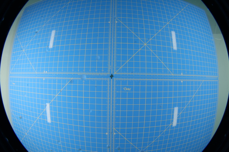

  12. I have a question for the group participants.
    If there was a dome available for this housing that did not vignette with the Tokina 10-17 and the Canon 10-18 that provided sharper corners, provided a wider angle of view than the standard dome but did not have a zoom control would you be interested in purchasing it? Is zoom really that important for the extreme wide angle of these two lenses?
    I appreciate your comments.
  13. I do not own this housing, but the vignetting with the 10-17 is definitely a limitation.
    If I were to buy the housing, I would like to have such a port.
  14. After some research I have determined that it is not economically feasible to incorporate a zoom control and place the dome in the proper position as the nodal point dictates. There is just not enough room between the housing and the back of the dome.

  17. I've pushed about 1000 images through the SL-1 in the Ikelite housing now and prefer it to my Canon 40D and 50D.. the camera does everything my old ones do, but better.. the screen on back for settings is wonderful, and it carries way better than my other systems do. The vignetting on the Tokina 10-17mm is unfortunate, but not a deal killer for me.. (I guess my composition isn't so tight that a little crop is OK :-). What I'm seeing is the throat of the port- not the shade, so I'm not sure how it can be solved, but I'm all ears. My main concern was pressing two buttons to change aperture -but it is not a problem even for small hands because the housing is so tiny. My last trip I took both systems and never used anything but the SL-1.. for me personally, the electronic TTL is a key feature though.. I know a lot of you like manual strobe settings but I will never shoot manual again. The SL-1 battery hasn't been a problem, but it can't last as long, so I would not want the onboard flash going off every time (e.g. fiber optic)
  18. file:///Users/steve/Desktop/sl-1%20images/IMG_8649-2.jpg
    file:///Users/steve/Desktop/sl-1%20images/IMG_8649.jpg
    this is the vignette with the Tokina 10-17mm set at 10mm, and focused a few inches from the dome.. TTL with a DS-161
