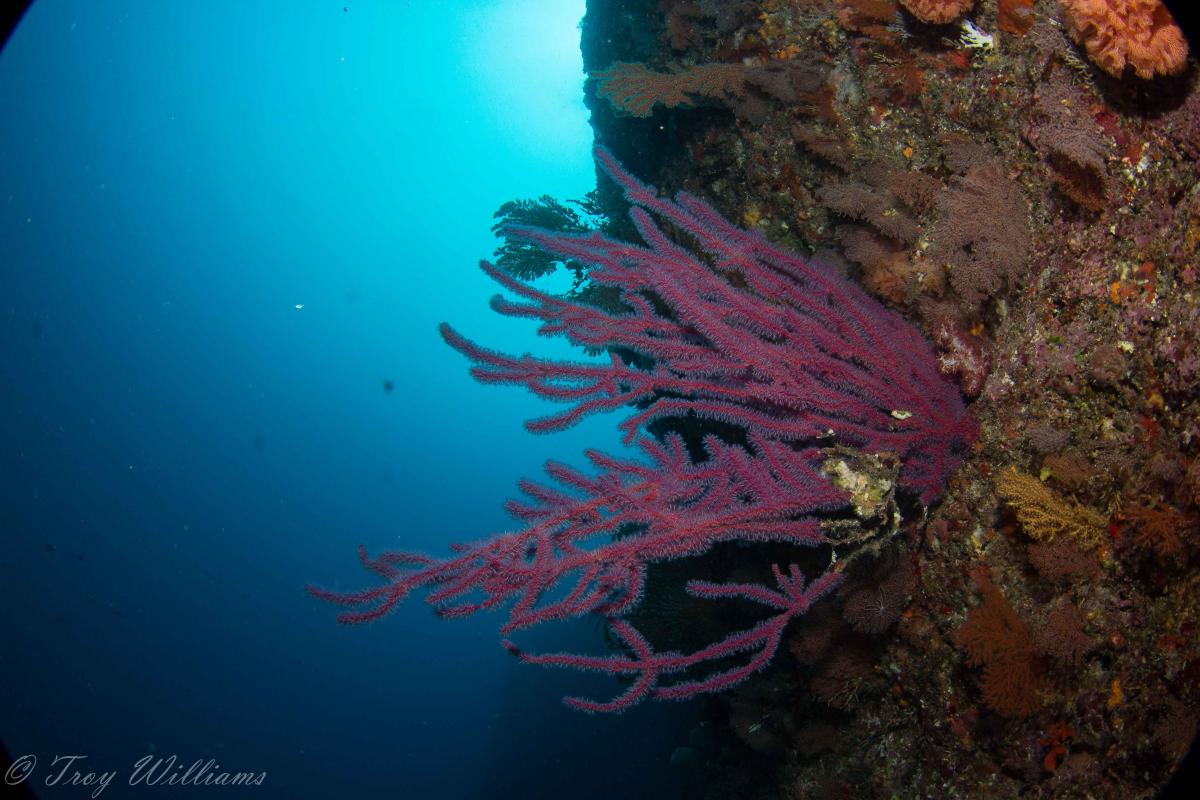

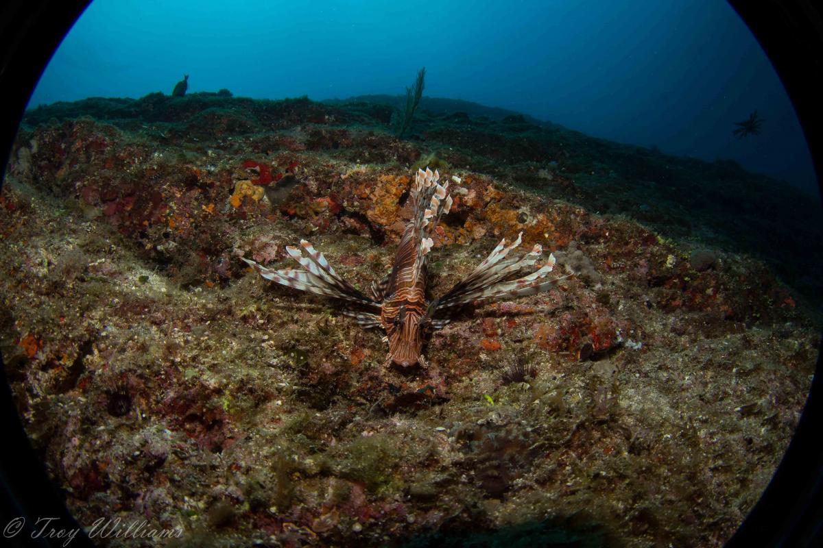

  9. okay...here we go (unfortunately all terrible shots):
    the lionfish is at 10mm
    the gorgonian is at 12mm
  10. Hey Chile,
    thanks for posting pictures!!
    To me that looks like the dome shade showing up in the frame due to the wide angle. As opposed to vignetting which often occurs with wide angle and is just a darkening of the corners. Is it possible to remove the dome shade?
    -Gareth

  12. Hey Chile,
    -Gareth

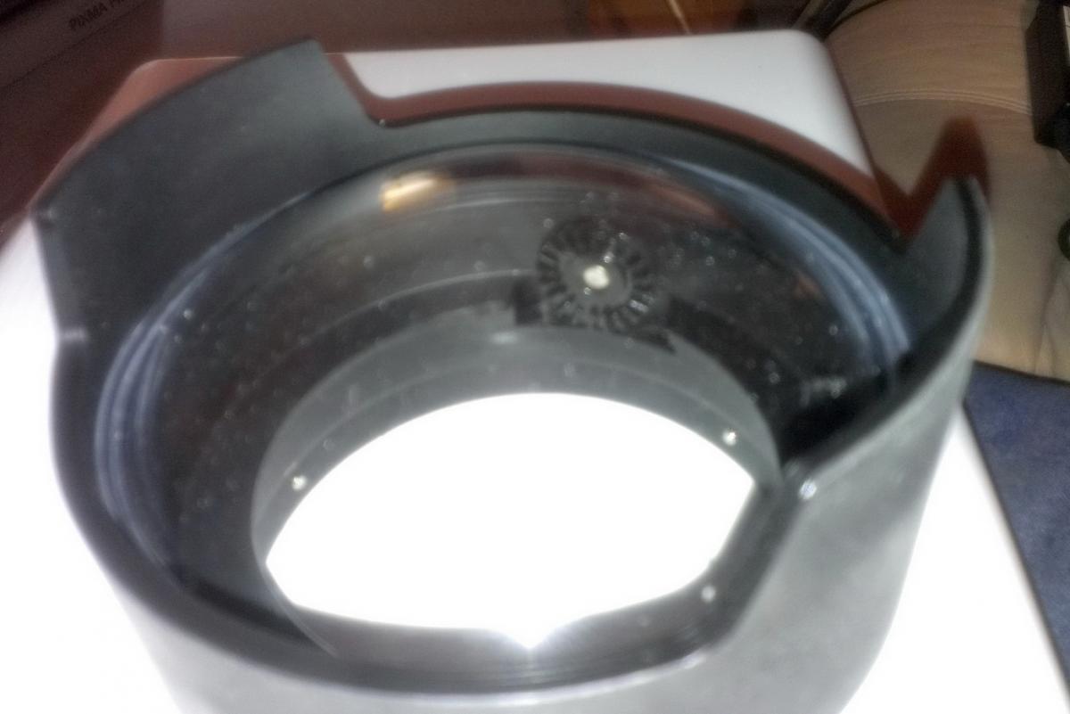

    Hi Gareth
    The shade is not removable. There is a bit of a lip on the shade that also is not helping the situation at all. Please see the attached poor quality cell phone picture.

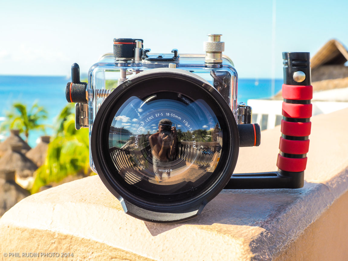

  13. Hi Bill,
    This is what I said in the article, "This is an excellent little housing system for travel, those entering underwater photography looking for a moderately priced system and for those die hard Canon fans looking for a backup system."
    First I don't see a distinction in regard to an entry level system between a DSLR or a mirrorless interchangeable lens system. I think I pointed out that the 100D Rebel is the entry level camera and that the current T5i is the top of the Rebel line. Above the Rebel line you have the 70D, 6D, 5D Mk III and so on. An "expert" could use any underwater system but they would likely be looking for things this camera does not have like a much larger viewfinder, greater AF speed and so on.
    This is a great little system for travel and I can see why many are interested in additional lens choices. Unlike most manufactures ports for "kit" lenses Ikelite has chosen to use a dome rather than a flat port. To expect that it will work well with all wide lenses is just not what it was designed for and I would think that Ikelite has future plans to accommodate additional wide lenses. I am sure some may want to use a 100mm macro lens with this housing but the 60 port is the one that makes the most sense for first release. This is a housing system that Ikelite will build on but I think that the intended target market for this system are as I said those looking for a moderately priced, small quality system.
    Do you think part of this lip could be removed with a dremel or equivalent
    to reduce the vignetting ? I am not asking for you to do it on your brand new
    equipment of course. ;) But I just wonder if this would be doable.
  18. Thank you all for the feedback !
    Yes you could remove some of the lip on the shade. you would only have to do that in 4 places that show up as the corners of the picture. the end result would be maybe no vignetting at 12mm but I would not recommend this to anyone. Some of the problems are that the dome is very close to the shade at the point where material is needed to be removed, depending on how much shade material you remove you could end up weakening the dome seal as the o-ring is right there and the improvements will be marginal.
    Since the dome is not a true hemispherical dome that is in the right position for the Tokina 10-17 lens the field of view (coverage in the picture) is also reduced to what a correctly placed hemispherical dome would deliver.
    In other words either live with 13mm or get a new custom dome.
