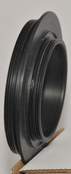

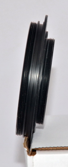

  13. The part you are looking for is in the pictures below. I made a prototype to use the modular port system on the housing. You have to unscrew the current port to put this one in then you can use the modular port system. The big problem is you do not have zoom or focus controls.
    Although it could be done I don't see the reason to make the standard ikelite port system work on this housing.

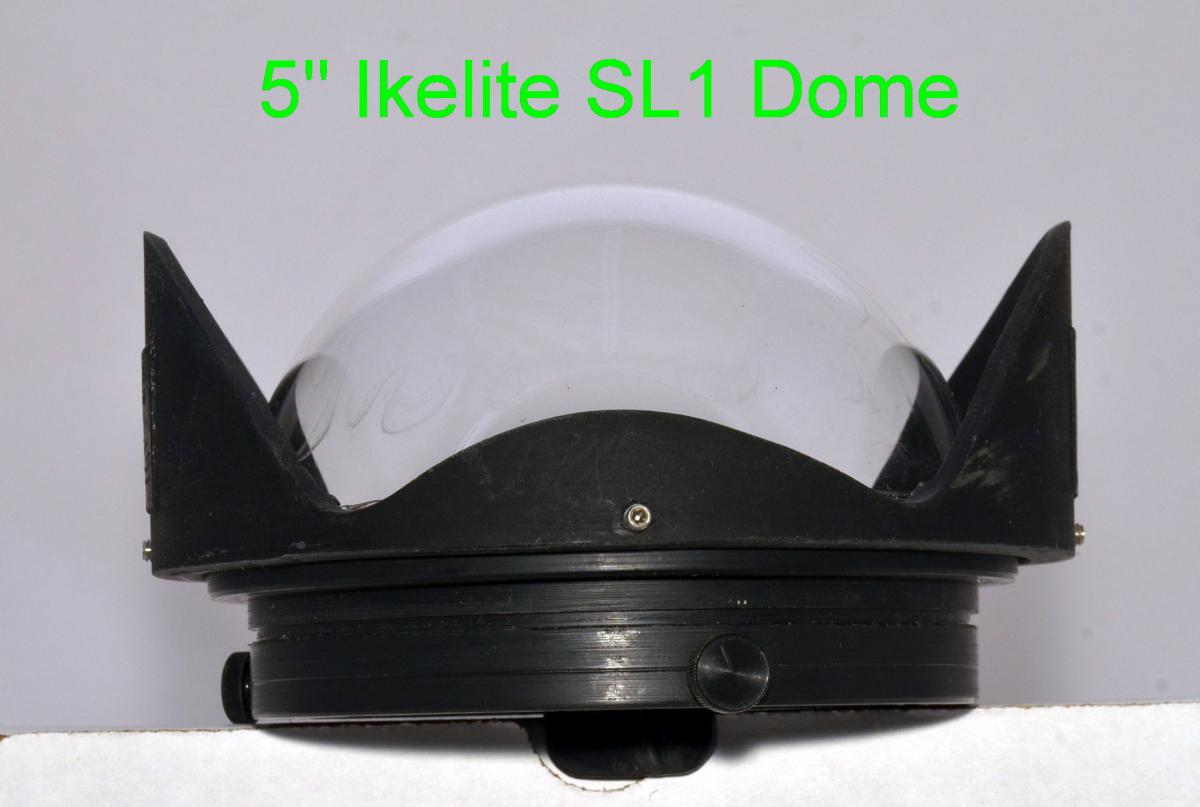

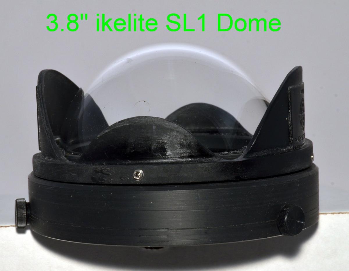

  19. It was mentioned earlier that I was working on a prototype dome for this housing and after extensive field testing I will report that I have a few of these in stock. I have attached pictures and hope to update the web site soon. Please PM me if you are interested.
    Both are tuned for the tokina 10-17 lens and do not vignette but also are not capable of zooming. The difference is one is a 5" and the other is a 3.8" dome. Please see the attached pictures. These attache the same way the ikelite dome attaches.They come with a dust cover, shade and neoprene cover.
