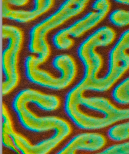

    A flat port will always cause some chromatic aberration because as a flat interface between water and air it causes refraction. Refraction at this interface bends different wavelengths of light different amounts and the colours split slightly - a chromatic aberration. We often see this in underwater pictures as a purple fringe along the inside edge of detail close to the edge of the frame.
    The wider the lens, the more pronounced the effect. This is a (left) edge of frame crop from a 60mm behind a flat port, you can see the purple fringe CA along the right hand edge of dark colour areas:
    Here is the whole image for reference only:
    Image processing software (e.g. Lightroom) can lessen this effect, but really it not calibrated for dealing with such strong amounts of CA generated by a flat port.
    Using such a lens behind a small dome removes this issue and also makes the lens a little wider. Downsides are that some macro power is lost and more importantly you cannot now use external dioptres. I will only use this solution when I know I am going in the water to shoot fish portraits rather than true macro.
    This is not a specific FX effect - it is a flat port/angle of lens coverage issue. Apologies for taking the discussion :offtopic:
