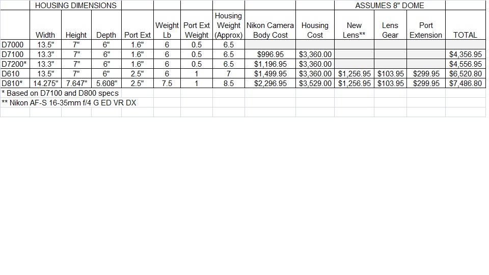

  5. Thanks everyone! This is helpful - but making me really indecisive! I had to crunch the numbers to see for myself. This is for an Aquatica housing...
    The full frame option is definitely a significant upfront investment going from DX since there's less that can be carried over. The D810 is a larger, heavier rig (for wide angle). Although I do have a lanyard to carry my housing and be hands-free, it's still a lot of camera. The D610 looks like a nice middle of the road FX option for size, weight and price.
    FULL FRAME COMPONENTS
    FX Lens and accessories for D610, D800 (anticipate D810 will be same)
    Nikon AF-S 16-35mm f/4 G ED VR DX
    Zoom gear 48728
    Port extension 18458 +2.5" and approximately 1 lb
    DX COMPONENTS
    Nikon AF-S 10-24mm f/3.5-4.5G IF-ED DX
    Zoom gear 48696
    Port extension 18462 +1.6" and approximately 0.5 lb
    Edited by NEwreckdiver
  6. Hi NEWreckdiver
    A couple of thoughts on your (excellent) spreadsheet: I wouldn't assume an 8" dome with the Nikkor 16-35. I found I had to go with the 9" on my Subal system at significant extra cost and weight.
    One way of cutting down on cost and weight is to switch from a 16-35 to a 15mm (Sigma) or 16mm (Nikon) FE. No need for an EXR, no diopter and 8" dome work soft sure. And either the 15 or 16mm is cheaper than the 16-35.
