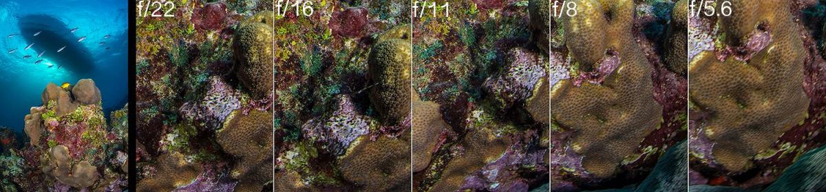

  11. I went with the Zen 170mm dome...it's not huge, and results with my Sigma 15mm FE are good. No extension ring needed, unless I use my 1.4 tele, which needs extension ring 20.
  12. I went with the Zen 170mm dome...it's not huge, and results with my Sigma 15mm FE are good. No extension ring needed, unless I use my 1.4 tele, which needs extension ring 20.
    I like the Zen 170mm too. Good size for those trips which are fisheye focused and unlikely to involve split levels. Big size saving over the 230mm.
    Here are some tests on corner performance at different apertures. It is not acceptable wider than f/9. Decent f/11-f/9. Very good f/13-or more.
    ALex
    Edited by Alex_Mustard
