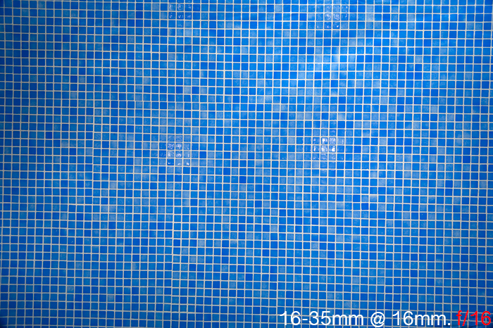

    Hooray, it seems to be keeping the water out - test shots of tiles:

  2. May aim of going to the pool was to experiment with setup and learn about how port extensions and different internal lenses impacted on performance of the optical corrector. But at the end I did shoot some comparison tests with my best dome (9” super dome)
    The early tests are very promising. My tentative conclusions are -
    1) corner sharpness from the optical corrector port is at least 1 stop better than my best dome. So not day and night different. Not one useless the other brilliant. But the optical corrector is obviously better. Examples below. I expect to revise this one stop figure upwards with more testing and more work on optimum setup.
    2) definitely less CA compared with dome. Out of interest, when the correct used out of the water the CA is bad, which I guess shows what it is taking out when it is placed underwater.
    3) lens to port distance effects distortion most obviously. Too close and pincushion distortion occurs (as with a dome port). Need more work to get optimum port spacing, then might even get better optical performance
    4) was able to use 20mm lens, 17-35mm @ 20mm and 16-35mm through the full zoom range of 16-35mm. All focal lengths tested worked - although I might loose the full range of the 16-35mm (at the 16mm end) when I get the final spacings figured out for best optical performance.
    5) the optical corrector is also supposed to enhance depth of field. I didn’t try and measure this.
    I did not do any tests to evaluate depth of field. But this shot with the 20mm and the optical corrector does show excellent depth of field (everything is in focus - which is not something that is easy to achieve with a full frame SLR).

  3. And here are some photos of pool tiles!
    I shot this scene with both the Optical Corrector Port and my 9”/230mm dome port (my best dome). With the same lens (20mm) at the same apertures. I was interested to compare corner sharpness of the port setups.
    The pictures below are 1:2 (50%) crops of my original camera file, showing the bottom left corner of frame (the area is the white box in the photo above).
    This is from the 9” dome port, shot with the aperture very open at f/4.
    And this is the Optical Corrector port at the same aperture (I was slightly closer to the wall of the pool, which is why the tiles are bigger, but the crop represents exactly the same area of the photo):
    The corner sharpness is very noticeably improved. To quantify how improved, below are a series of shots at different apertures (1 stop apart) from the dome port:
    f/5.6:
    f/8:
    f/11:
    If you think the optical performance of the Corrector Port shot at f/4 is most similar to f/5.6 on the dome, then it has a 1 stop advantage. If you think it is most similar to f/8, then it has a two stop and if you think it is most similar to f/11 then it has a three stop.
    For now, I am content seeing there is a clear advantage and I am looking forward to getting it into the ocean to put it through its paces on real subjects. I am planning some more rigorous controlled conditions testing to try and quantify what the advantage is. As I do more testing I will add the results to this thread.
    Alex
