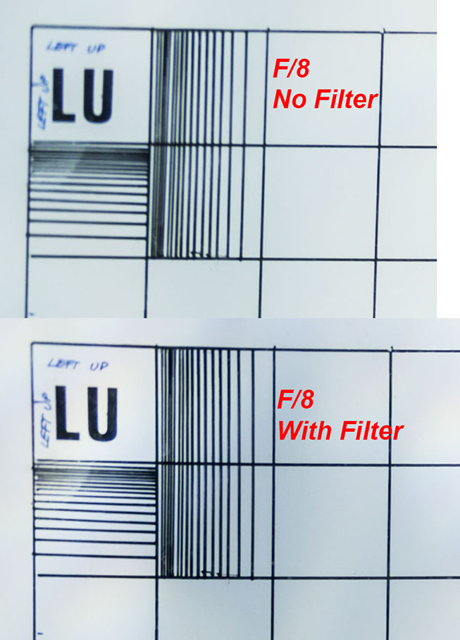

  2. Here I post another corner sample, now at f/8. As you can see the improvement is less evident when compared with the F/11 picture (Camera: 5DmkIII; lens: 17-40mm)
    Edited by jordi
  3. Would be great to see the results on the s&s 240mm dome that it was designed for.
  4. Here I post another corner sample, now at f/8. As you can see the improvement is less evident when compared with the F/11 picture (Camera: 5DmkIII; lens: 17-40mm)
    Thanks, f11 seems to be the limit. I don't expect much better with the S&S240 dome either, it's roughly the same size.

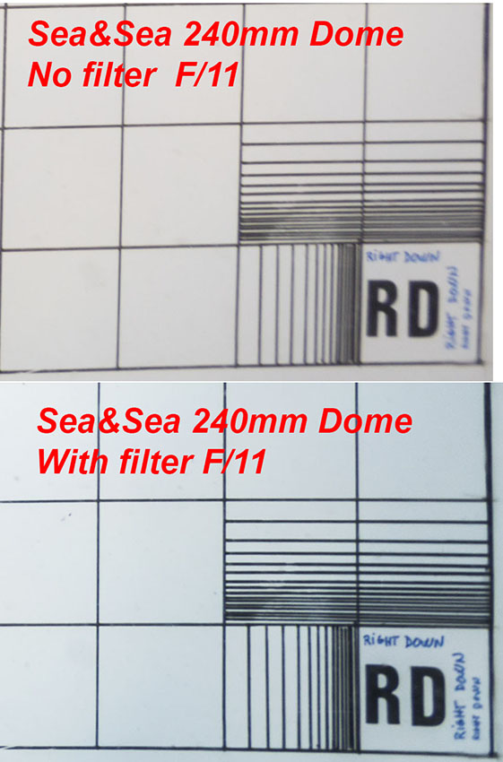

  6. I had the opportunity to borrow a Sea&Sea 240mm Port. In fact the port has 240mm but the glass (acrylic) has less diameter than the glass 9,3" dome I used in my first test. The S&S dome has a dome of 210mm aprox. The radius of curvature seems bigger that the glass dome.
    In my tests the results are quite similar to glass dome and improvement is around 1 stop better with filter attached.
    I attach a crop at F11.
  7. Great report Jordi, it seems FF is stuck at f/11 with domes, even with this new "aspheric diopter" thingy. Lesson learned: until similar converters that Alex shown or the WWL-1
    became more common I'll stay away from FF. With the rise of the WWL-1 I feel/hope the days of the dome ports are counted.

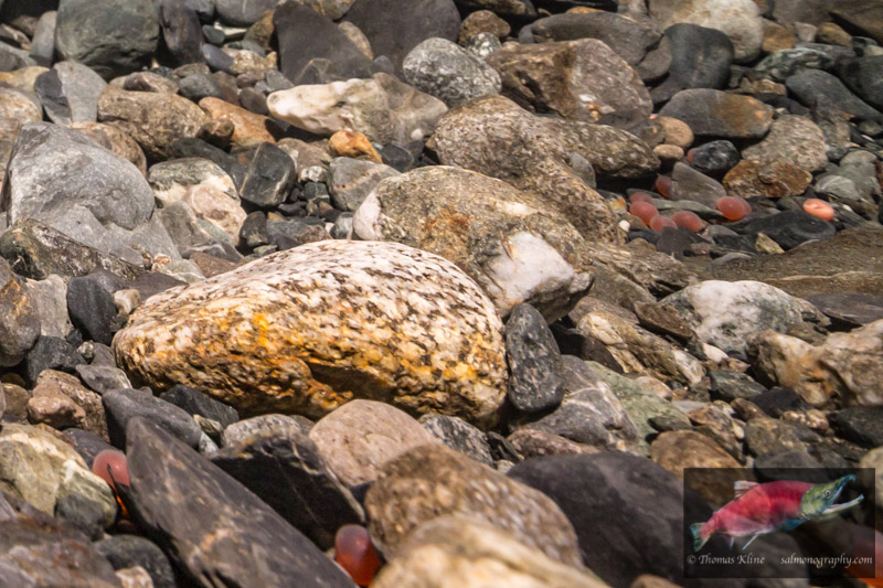

  10. I received my copy of the Sea & Sea internal correction lens from Reef Photo & Video (Thanks!) late yesterday and started working with it today on a Canon 16-35mm IS lens on a 1Ds3 in a Seacam housing with a superdome. Looks promising so far. See attached image.
    The M77 sized lens is slightly over-sized similar to certain filters designed for wide angle lenses. As well, there is no female threading. So it is not possible to attach a 77mm lens cap on the filter, e.g., when leaving it on the camera lens out of the housing.
    Tom
    Edited by Tom_Kline

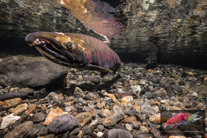

  12. Did some more shooting with the ICL today. Swapped the 16-35, ICL, etc. and shot it @ 16mm on my 1DX to take advantage of the better AF. The in-focus corners are particularly impressive. No corner smearing! I am attaching a full frame and a blow-up of the lower right hand corner.
    Tom

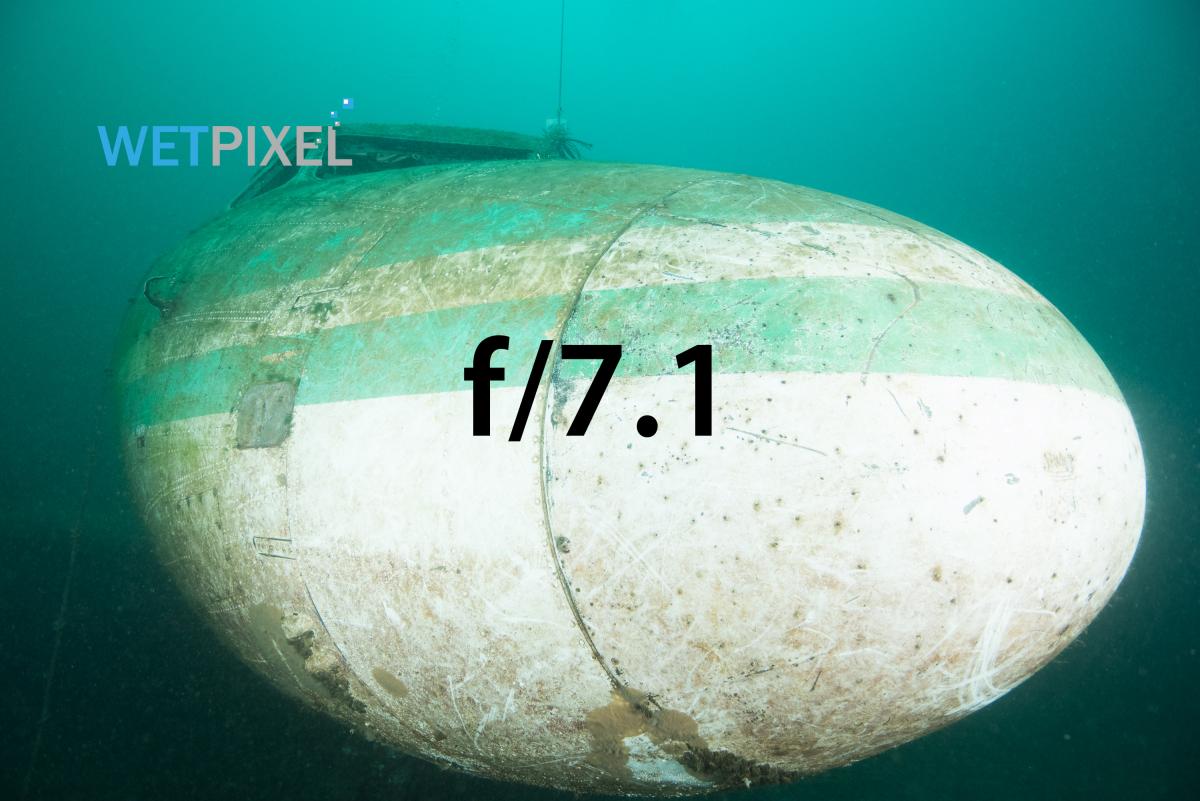

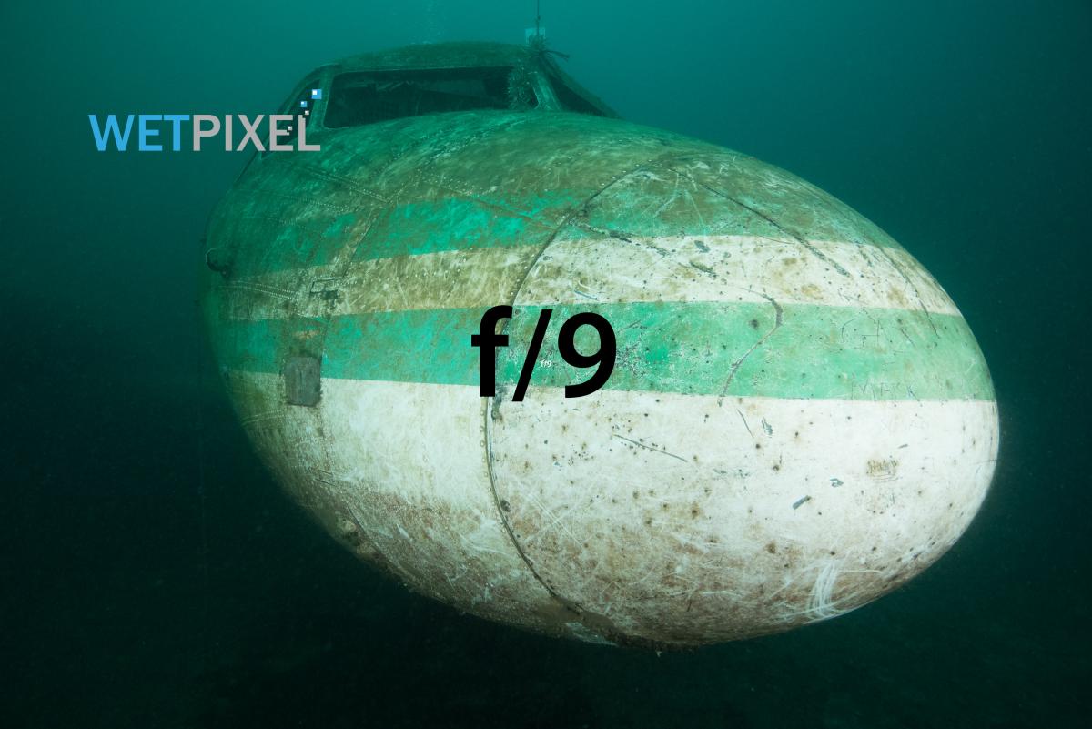

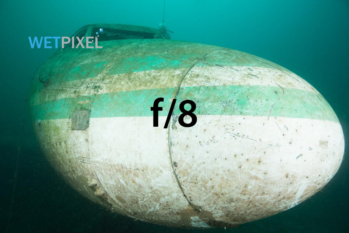

  16. Hi all,
    I am going to try and get the pool shots up on the Wetpixel front page later today.
    In the meantime, here are a series shot in open water. All were taken with a Nikon D810 with a Nikkor 16-35mm f4, a Seacam Superdome and 70mm extension:
    The results look pretty good I think....
    Adam
    Edited by adamhanlon
  17. @Adam: it seems it is as good as it can be, to make it more clear you have to filter the water around the wreck:)
    Jokes apart: I suppose the bare superdome shouldn't deliver too bad here either, all 4 corners here show water, where you cannot judge sharpness.

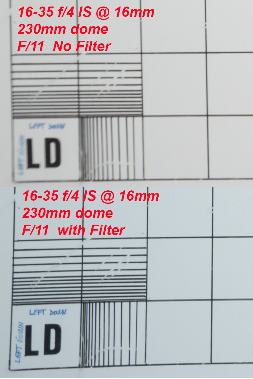

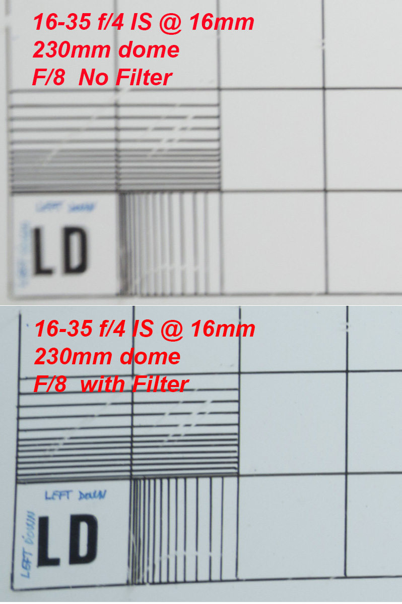

  19. Finally I had the opportunity to test the filter in a pool, in a more controlled situation. I also tried the Canon 16-35mm F4 IS, IMHO a better corner performer than the 17-40mm I was using in my previous tests. I have tried different combinations (230mm glass dome port and Sea&Sea Fisheye "acrylic" port) and I got slightly better results with the 230mm glass dome.
    The improvement is near the claimed 2 stops, which is very good news. At F8 the corners are very good and at F11 they are perfect.
  20. Wow, looks like an impressive improvement
