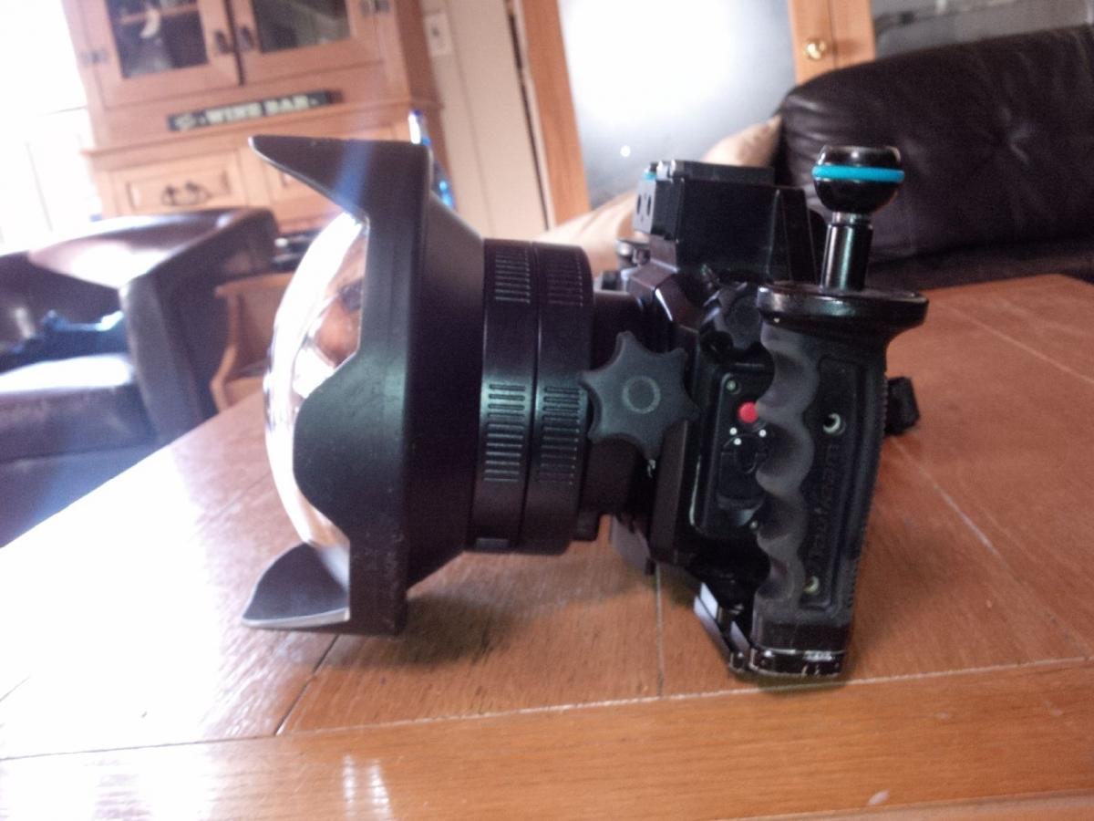

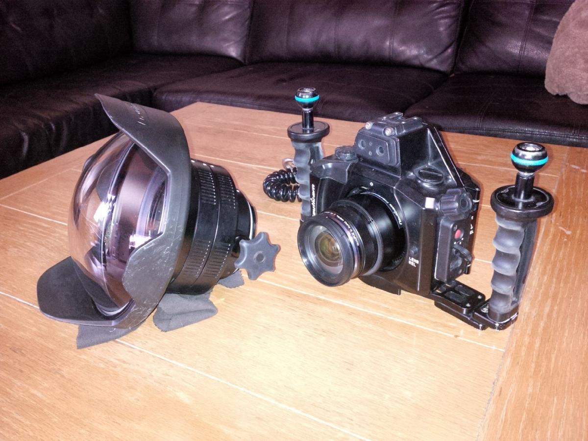

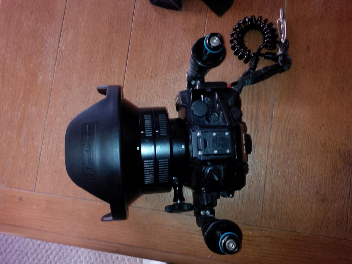

  8. EspenB the dome port hangs approximately 3.5cm below the bottom of the housing. Definately taking some time to get used to the size of it compared to the flat port or mini-dome for the fisheye... For close focus wide-angle it definately changes some angles that you can achieve when a foreground subject is close to the bottom / rocky reef.
    Here are some images of the my housing with the 12-40 f2.8 lens attached & port off, then a couple angles with it on.
    I am hoping the upcoming Oly 7-14 will work with the same set up, or maybe with one less extension ring?
    Regards,
    Adam
